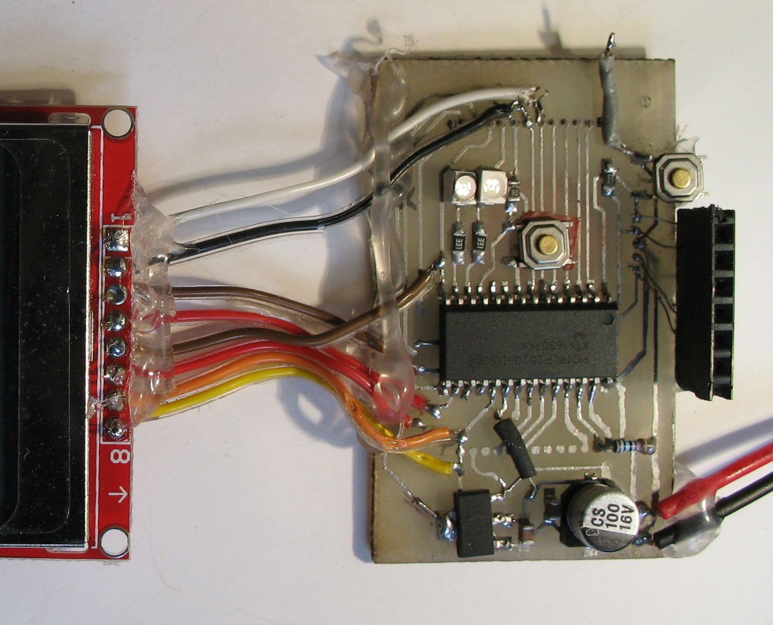

Hi E and J,
The module started showing MOSI after I cleaned it for the photo:rolleyes:
Here's the circuit: (Test circuit that has been modified and re-worked)
Here's the readout from #74 Zoomed in and out.

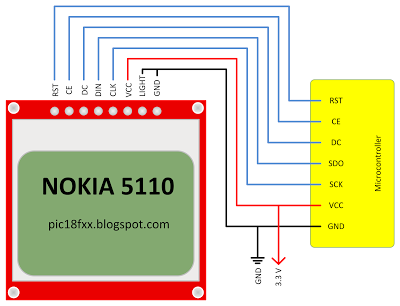

The back light is on. My schematic shows connect the LIGHT PIN to GND. Previously on the 4x20 LCDs they had a POT for contrast, do these need a POT?
18F and LF the same in this sense, noted.
C.

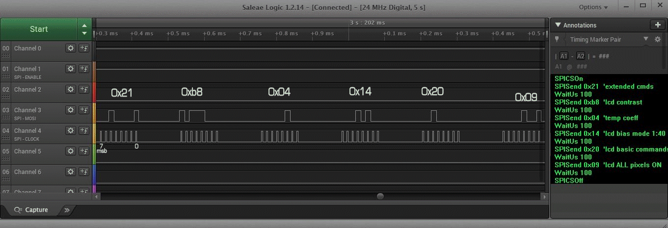

hi C,
The Contrast is set in the Init code.
Not sure what this means. The module started showing MOSI after I cleaned it for the photo
Any signs of pixels??
E
SPICSOn
SPISend 0x21 'extended cmds
WaitUs 100
SPISend 0xb8 'lcd contrast
WaitUs 100
SPISend 0x04 'temp coeff
WaitUs 100
SPISend 0x14 'lcd bias mode 1:40
WaitUs 100
SPISend 0x20 'lcd basic commands
WaitUs 100
SPISend 0x09 'lcd ALL pixels ON
WaitUs 100
SPICSOff
WaitMs 1
Return

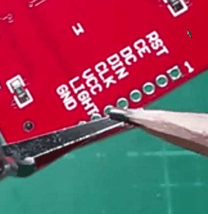

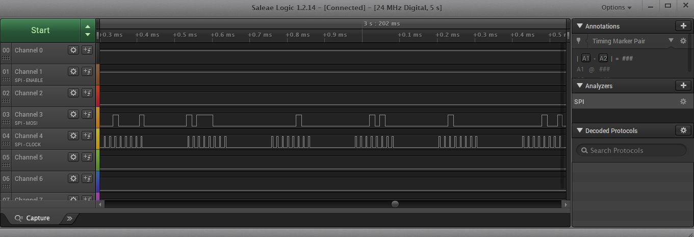

Hi E,
I saw the contrast in the program. I was double checking if LIGHT is correctly connected. I assume a POT there would be for brightness.
The circuit didn't work (didn't show any signal on the MOSI analyser line) until I cleaned it this morning (Now MOSI showing). I had previously taken off the PIC, as there was a problem of tracking, because of the out of date solder paste.
Only light show on the screen.
My reading of the analyser readings, shows incorrect numbers, see what you think.
C.
The vid says LIGHT is pulled low to swicth ON.
If your last image was the analyser, why do you think the readings are wrong.?
E
E
Hi E,
I'm out of practice reading my conversion chart, now I see it is correct.
I just tried a different PCB with 18F2420 PIC and a different 5110. The analyser shows the same result. The 5110 also shows the same result of no pixels.

There are (at least) two entirely different types of the 5110 display module, the pin connections are completely different, and one needs HIGH for the LED's, the other needs LOW.

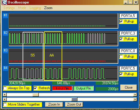

While I have been waiting I did this..
Should display 55/aa pattern repeated [vid2]
E

Hi E,
The screen shows a feint square of pixels, i,e faded, but no digits.
What does vid2 mean?
EDIT: At the start-up the faded screen comes on then a quick flash then the faded screen again, as if it's trying to show other than the faded screen.
C.
hi C,
Vid2 is my lazy way of saying watch the uTube video number 2, following video #1, that you posted.:)
The lcd should show alternate On/Off pixels as per video #2... I am stepping thru video 2 in order to confirm success at each step.
