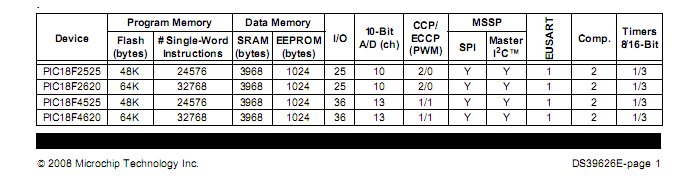

I started using the 18F4620 PIC some time ago for SD work, check out the spec.
BTW: Oshonsoft supports the 18F4620.

I use the pic18f4620.... I have nearly 4k RAM and 64k of Code... This can run at 32Mhz..
As of today, I have moved to the pic18f45k22... This is a beast... 64k code nearly 4k ram 1k eeprom 64Mhz and more peripherals than you can imagine, two seial ports ( Why I need it )... I won't need any more... Pin compatable with my system.... Job done...
