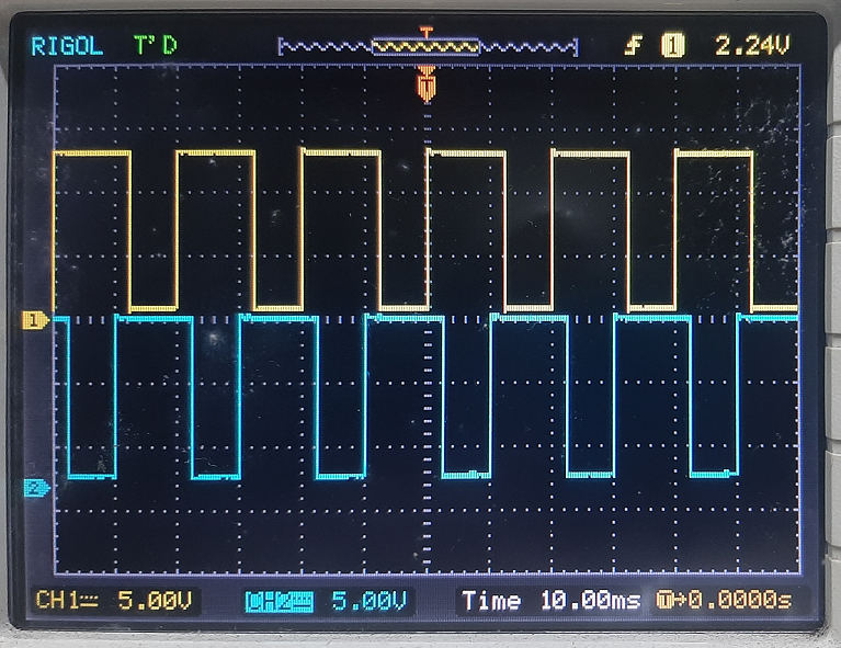

I just put my scope before going to Final MOSFET gates.I got below waveforms.
*** Major problem. ***
You have both mosfet on at the same time, creating periods of high current.
Rework your code to have periods of dead time where both mosfet drive signals are off.
You got it.My code is generating the correct code.But due to Low side driver in post 16 the wave is inverting.I need to invert the code in PIC side.
