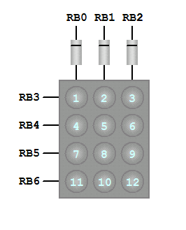

Tell us how/where the keypads 16 keys [4 * 4] are connected to the PIC port pins.
hihi....
i'm blur in the scanning and key pressing part...
why got 4 col and not need row one...
i want to do is 12 keys[4 * 3] and connect the input to the portB
7 input and 1 output
A 4x3 keypad normally uses 7 I/O pins. 4 outputs and 3 inputs. PORTB is handy because you can enable weak pullups, it even has a very handy interrupt / wakeup on change mode for bits 4 thru 7.
11max11 said:
Can anyone help me see is that i done correct?
i using the MPlab to done one..
As I have requested, POST a drawing on how you have connected the 12 key switches to the PORT pins.
We would like to help you, but you are not giving us the information we need.
From your code it looks like you've configured the keypad like this;
Your code looks good except for being in the wrong bank when writing the OPTION register. Your code could also be optimized a bit;
COLUMN1 BCF     PORTB,0         ;Clear B0
        BSF     PORTB,1         ;Set B1
        BSF     PORTB,2         ;Set B2
CHECK1  MOVLW   .1              ;assume key 1
        BTFSS   PORTB,3         ;pressed? no, skip, else
        MOVWF   PORTA           ;output 1 on PORTA
CHECK4  MOVLW   .4              ;assume key 4
        BTFSS   PORTB,4         ;pressed? no, skip, else
        MOVWF   PORTA           ;output 4 on PORTA
CHECK7  MOVLW   .7              ;assume key 7
        BTFSS   PORTB,5         ;pressed? no, skip, else
        MOVWF   PORTA           ;output 7 on PORTA
CHECK11 MOVLW   .11             ;assume key 11
        BTFSS   PORTB,6         ;pressed? no, skip, else
        MOVWF   PORTA           ;output 11 on PORTA
Or perhaps something like this;
COLUMN1 BCF     PORTB,0         ;RB0 = 0
        BSF     PORTB,1         ;RB1 = 1
        BSF     PORTB,2         ;RB2 = 1
        MOVLW   0               ;clear WREG (set Z = 1)
        MOVLW   .1              ;WREG = '1'
        MOVLW   .4              ;WREG = '4'
        MOVLW   .7              ;WREG = '7'
        MOVLW   .11             ;WREG = '11'
COLUMN2 BSF     PORTB,0         ;RB0 = 1
        BCF     PORTB,1         ;RB1 = 0
        BTFSS   PORTB,3         ;
        MOVLW   .2              ;
        BTFSS   PORTB,4         ;
        MOVLW   .5              ;
        BTFSS   PORTB,5         ;
        MOVLW   .8              ;
        BTFSS   PORTB,6         ;
        MOVLW   .10             ;
COLUMN3 BSF     PORTB,0         ;RB0 = 1
        BCF     PORTB,2         ;RB2 = 0
        BTFSS   PORTB,3         ;
        MOVLW   .3              ;
        BTFSS   PORTB,4         ;
        MOVLW   .6              ;
        BTFSS   PORTB,5         ;
        MOVLW   .9              ;
        BTFSC   PORTB,6         ;
        MOVLW   .12             ;
WRAPUP  BTFSS   STATUS,Z        ;key press? no, skip, else
        MOVWF   PORTA           ;output key on PORTA
        GOTO    COLUMN1         ;Start scanning again.
