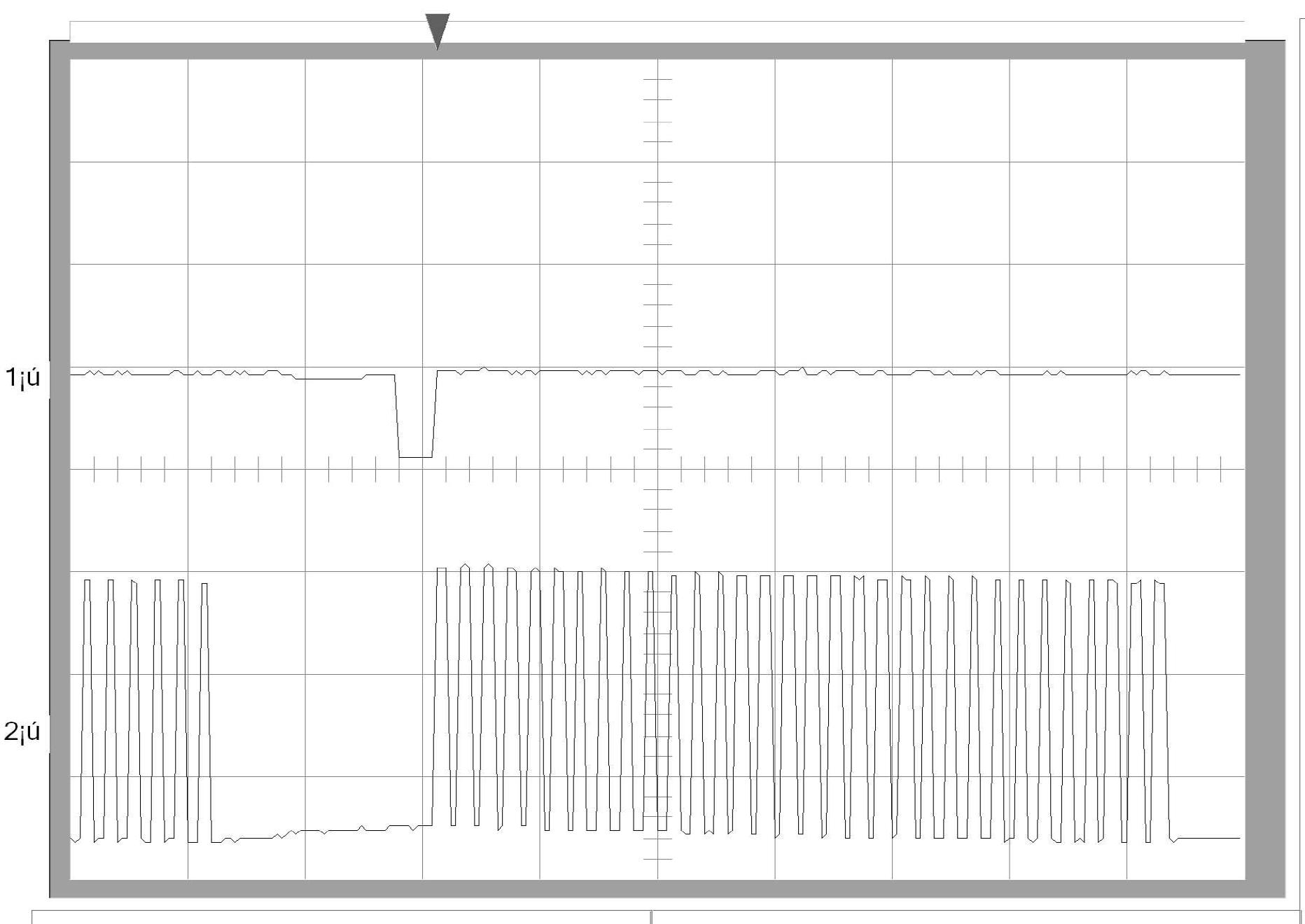

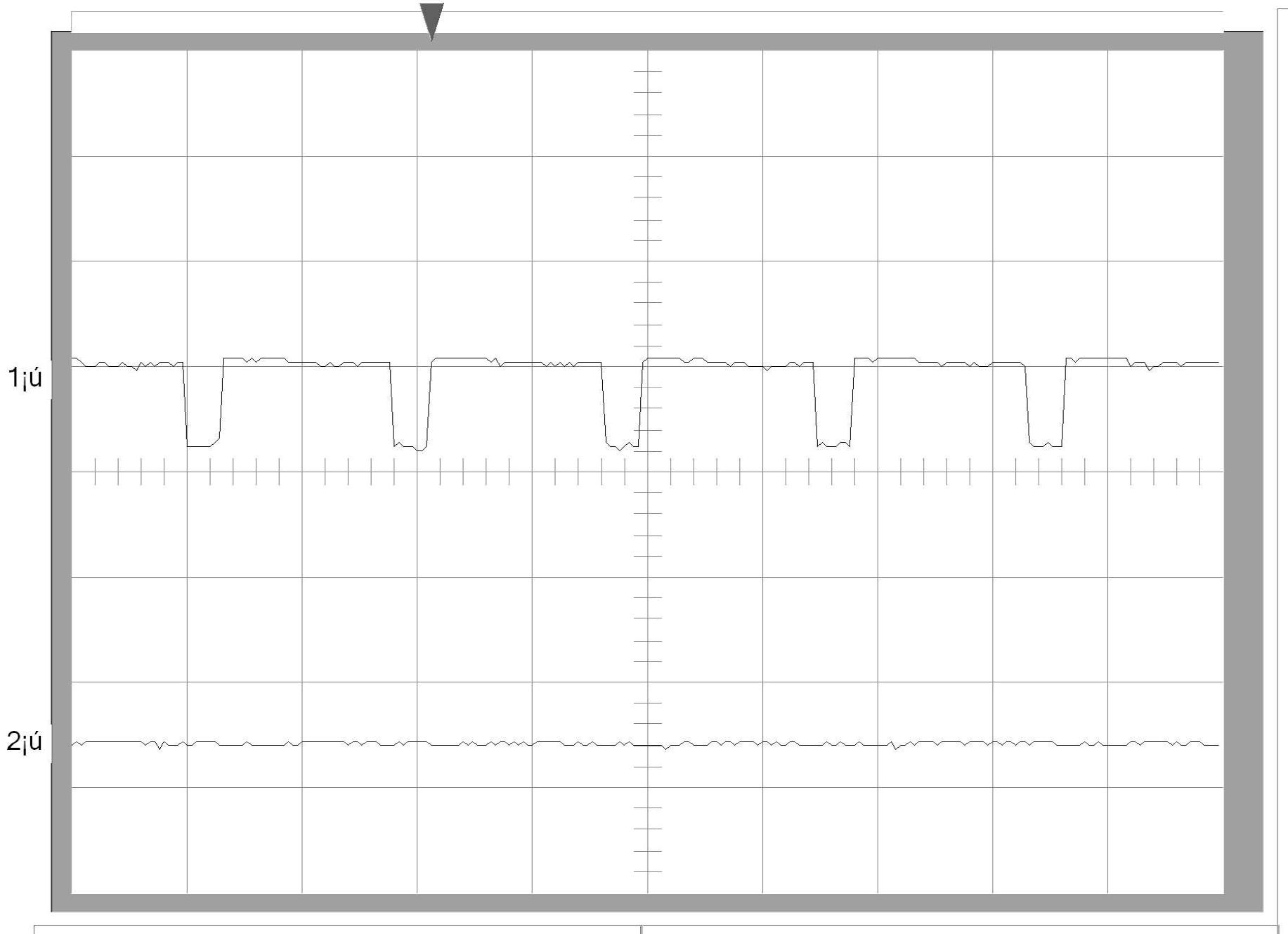

Dear friends:
I have followed our dear friend colin55 advices and hings are now better than before.
Now, I have the leds and displays ok.
I also continue to use Timer1 interrupt to make led on/off blink because it's working and I am pretty sure I am going to need it when the oven will be cooking, to count the time (from 1 to 240 minutes).
In this application, when we push any key, it will sound a beep.
For the keys Up and Down, the beep will heard only the first time we press the button. If you keep the button pressed, activating the auto increment, the beep will not be fired.
I just tested the code for the keys without any debounce and playing a beep when the key Up is pressed, just to test it.
The problem is that, when this key is pressed and we generate one beep, all the displays and leds timing are messed up.
You can see the picture from the osciloscope attached below.
As you can see, I am beeping just for 35 ms (+-), but the displays and leds blinks (and I am thinking that the beep should be playing for, at least, 250 ms to be heard fine, isn't?
Do I need to make this work using Timer interrupts (timer2 or timer0)? Isn't this better, so we don't have so much problems with the timing?
The code I have until now, is attached to this post
  • oven.zip
    oven.zip
You are still "running away" and doing your own thing. If you want someone to help you, you must follow each request. A micro cannot do two things at the same time. Everything must be fitted into each other.
The beep or beeper must have a flag. When you set the flag and display the first digit, you need to turn on and off the beep line every 500uS or less. Then you go to the second display and look at the flag and do the same thing.
Get the piezo to have the correct sound by doing this and then allocate a certain number of cycles for the time to display each 7-segment. This is how you get the frequency of the scanning routine.
This is the next thing to do.
Your code is already getting far too complex.
I told you before to keep the code as simple as possible because we have a long way to go and the code will become enormously complex by the time you end if you don't keep things simple.
Once you get the beep happening as a continuous tone while the displays are showing, you can add another flag to detect when the key is not pressed and another counter routine to count the number of cycles of tone to produce the 250mS beep.
This beep routine, with all its counting and key detection, will be inside the 1mS delay routine.
This routine will eventually have a lot more in it as it will be doing all the "housekeeping" for detecting the switches and turning on and off the LEDs etc etc etc.
This is where everything will be done as it is not interfering with the display illumination.
But I want to see only a simple routine as Main so I can follow it and see when things go wrong.
Remove the timer interrupt, for a start. You cannot have anything that will interrupt the display routine for an unknown period of time.
