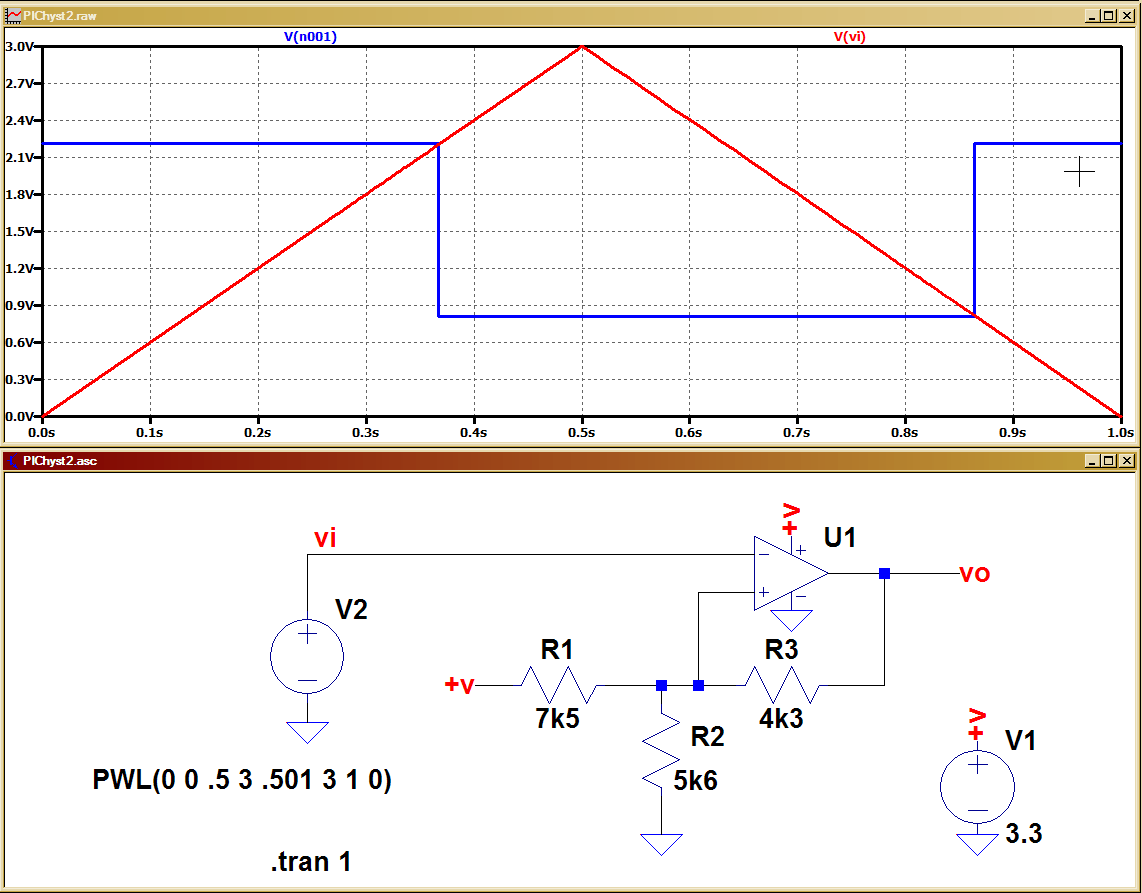

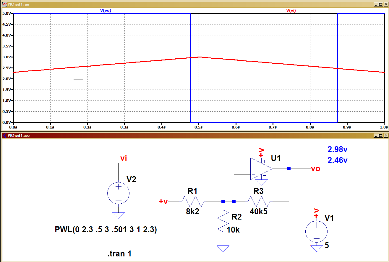

Just modelled in LTSpice the example given in the Tips and Tricks, it switches OK at the levels they quote.
If the OP can post his values I could check it out for us in simulation.
E

I'm just calculating mine now.. i just built the microchip circuit and put a high pulse at the input of the comparator which is set to interrupt and increment a register then leave the ISR. on receiving one pulse of 2.9V it incremented 95 times!
I'm using the comparator for event counting thus need this to be accurate.
the problem with the levels they quote is that is based on their expected noise, clearly mine is much greater (apologies for the multiple entries).
Can you tell more about the signal you are trying to detect. What is the signal source and how "bad" is it? Maybe you need debounce circuit and/or low pass filtering also.
currently all i am inputting is a short 'pulse', the input signal is going to be a triangle wave with a high transition period, but presently with a pulse simulated using a power supply at the expected voltage and touching a contact at its positive terminal with the input of the comparator hysteresis is not working at all. i thought that would provide the cleanest input to the system short of an absolute square wave (i don't have a function generator).

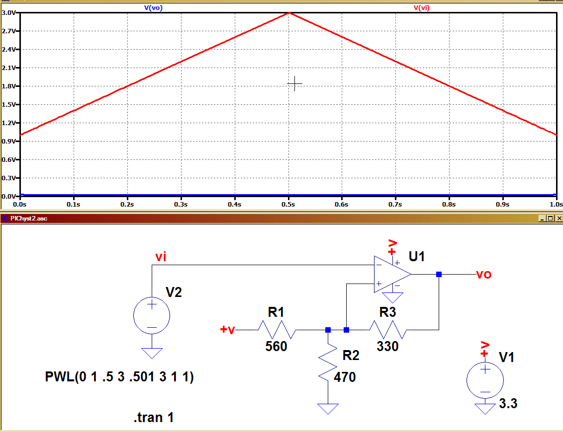

having tried microchip tutorials i stumbled across this one, (I'm assuming microchip was the inspiration). for the calculations on page 6 i used VDD of 3.3v (as will be used in the final scenario) and had a R2 of 470 and R1 560 ohms with an R3 of 330, which gave me a Vtl of 0.8 and Vth 2.2.still a lot of 'chatter' though. as in i am getting readings of 100-200 for a single input of 3v
If you are using mechanical switch to create the "test pulse", then that is a problem. Mechanical switches bounce creating lots of fast pulses. If you have a potentiometer, use that to create variable voltage and to test the comparator.
With these R values you are way off .??
Are you sure you have posted the correct values.?
Look at this SIM.
E

Look at this image for suitable values.
2.2Vth ,,, 0.8Vtl with Vdd = 3.3V
The Blue trace is the Vout.
clearly something is off with my calculations, the simulation doesn't lie.

ok, so I'm back home and have just simulated my previously calculated values in LTSpice. They agree with what you have in the image above. but threshold at 2.7, and 0.7 so a nice wide hysteresis band. I've just hooked up the circuit with a potentiometer, will let you know the outcome in the AM!
update: not perfect but significantly improved, the 'chatter' effect had gone from 200+ 6-10 increments for every one above threshold however that could just be to non-immediate switching of the pot as can be expected. tomorrow afternoon i will input the intended signal under consideration.
