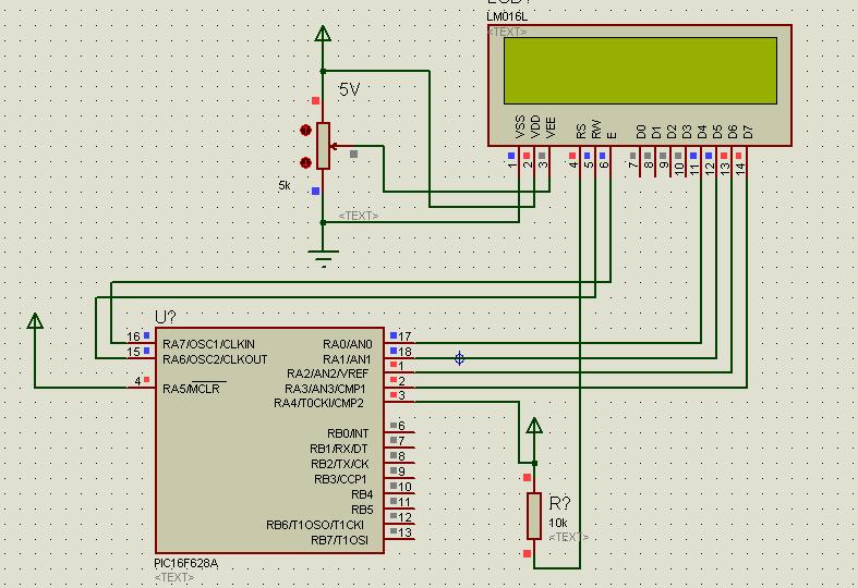

I also tried
__config Ox2109
which means 0010 0001 0000 1001
so bit 4,1 and 0 being 0,0,1 respectively, means
XT oscillator: Crystal/resonator on RA6/OSC2/CLKOUT and RA7/OSC1/CLKIN
Still there was no display on the Lcd, so which of this configurations must I use for bit 4,1 and 0:
FOSC2:FOSC0: Oscillator Selection bits(4)
111 = ER oscillator: CLKOUT function on RA6/OSC2/CLKOUT pin, Resistor on RA7/OSC1/CLKIN
110 = ER oscillator: I/O function on RA6/OSC2/CLKOUT pin, Resistor on RA7/OSC1/CLKIN
100 = INTRC oscillator: I/O function on RA6/OSC2/CLKOUT pin, I/O function on RA7/OSC1/CLKIN
011 = EC: I/O function on RA6/OSC2/CLKOUT pin, CLKIN on RA7/OSC1/CLKIN
010 = HS oscillator: High speed crystal/resonator on RA6/OSC2/CLKOUT and RA7/OSC1/CLKIN
001 = XT oscillator: Crystal/resonator on RA6/OSC2/CLKOUT and RA7/OSC1/CLKIN
000 = LP oscillator: Low power crystal on RA6/OSC2/CLKOUT and RA7/OSC1/CLKIN
Why not just do this, also you just suggested Clock Out twice.

Thanks man for the new version, Maybe this time there is something wrong with how I have setup, MPLAB. I still get the same error

Yeah, there is no errors now. The code I am using I copied it from . I think the way I built the circuit is not the same as that circuit shown on the previous link. Whats wrong with my circuit because there is still no massege displayed.
I changed the code on the configuration part
I introduced
__config _PWRTE_ON & _WDT_OFF & _INTRC_OSC_NOCLKOUT & _BODEN_ON & _LVP_OFF & _CP_OFF & _MCLRE_OFF
insteat of
__config 0x3D18 ;sets the configuration settings (oscillator type etc.)
Birdman0_o I wld like to know if you ever use proteus on some of your projects. If so I wld like to know which version are you using. I am using Proteus 7.1. it came to my sense that maybe I should use the new version 7.6. I m still downloading it. after I have instlled it and tested the program I wld let you know. Could you please test mine on your proteus and see what you will get. Thank you very much
The pull up resistor is wrong...why won't you listen to me?
No I trust you man, its just that I had another thought. I am still trying to put the resistor in a correct way, I wld let you know wht I have achieved
