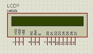

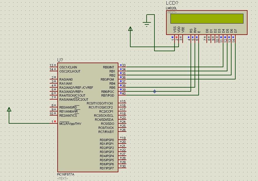

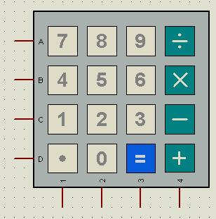

PIC calculator
Hello guys I want to built a pic calculator using PIc16f877a or any Pic16f87X. Main components are a small calculator keypad and LCD(LM020L). I will be using proteus for the circuit. On the attachment I have shown the calculator keypad and LCD(LM020L) I want to use.
I am familir with assembly so I would like to know which language is suitable for this kind of a project between C, C++ and assembly

;*** Keypad Subroutine ***
CheckKeys
	bsf		Column1
	bcf		Column4
	btfss	Row1						; Yes, check rows
	retlw	'A'							; if row is off, store 2 in work reg
	btfss	Row2						; Check which row was pressed and fill Temp with appropriate value
	retlw	'B'							;
	btfss	Row3						;
	retlw	'C'							;
	btfss	Row4						;
	retlw	'D'							;
COLUMN3
	bsf		Column4
	bcf		Column3
	retlw	'3'							; if row is off, store 2 in work reg
	retlw	'6'
	btfss	Row3						;
	retlw	'9'							;
	btfss	Row4						;
	retlw	'#'							;
COLUMN2
	bsf		Column3
	bcf		Column2
	btfss	Row1						;
	retlw	'2'							;
	btfss	Row2						;
	retlw	'5'							;
	btfss	Row3						;
	retlw	'8'							;
	btfss	Row4						;
	retlw	'0'							;
COLUMN1
	bsf		Column2
	bcf		Column1
	btfss	Row1						;
	retlw	'1'
	btfss	Row2						;
	retlw	'4'							;
	btfss	Row3						;
	retlw	'7'							;
	btfss	Row4						;
	retlw	'*'
	goto	CheckKeys

Hi birdman_0,
I thought my project would be easier if I break it into 2 parts and I would like to start with the first part. I want to connect LCD to pic16f877a and then display the massege (Hello) on the LCD. I have already done that but there is no message displayed on the LCD. I dont know where the problem is. Here is my code
 list		p=16f877A	; list directive to define processor
	#include	<p16f877A.inc>	; processor specific variable definitions
	__CONFIG _CP_OFF & _WDT_OFF & _BODEN_OFF & _PWRTE_ON & _RC_OSC & _WRT_OFF & _LVP_ON & _CPD_OFF
; '__CONFIG' directive is used to embed configuration data within .asm file.
; The lables following the directive are located in the respective .inc file.
; See respective data sheet for additional information on configuration word.

        movlw   b'00000000'    ; Set port B bits 0-3 as outputs b0-b3 connected to lcd  d4-d7 pins
                                ;and b5-b7 connected to RS,RW,E
        movwf   TRISB        ; Set TRISB register

and on the attachment is my circuit diagram, lcd hex file and lcd design.

As you don't have a contrast control it may well be working, but you can't see it - add a contrast control - as a minimum it will let you adjust it until it displays a single row of squares, this shows the LCD is functioning, but not been initialised.
I have included contrast control (you can look at the circuit on the attachment) and adjusted it, but still the is no dispaly on the LCD, I would be glad if you can paste the circuit diagram of PIC Tutorial Three - LCD Modules
(Tutorial 3.1 ) I think it would be helpful since it will make me realise my problem, because I copied some of the routines from Tutorial 3.1.
Not sure if it matters for the SIM but you dont have an oscillator connected?
I have connected the crystal oscillator as shown in the circuit diagram on the attachment and I have also changed the configuration bits
to __CONFIG _CP_OFF & _WDT_OFF & _BODEN_OFF & _PWRTE_ON & _XT_OSC & _WRT_OFF & _LVP_ON & _CPD_OFF
still there is no display. Would you please paste your circuit diagram for pic calculator so I can see how you connected lcd to your microcontroller, I am
sure there is something wrong with my circuit
  • New Folder.zip
All the circuits are on the tutorial site, under Hardware.

I constructed the circuit similar to that of PIC Tutorial - LCD Board
shown on the attachment But I have used pic16F628A because proteus I am using does not have PIC16F628 and loaded the code for Tutorial 3.1. But there is no display, may be the circuit I constracted does not match with the one of LCD Board. Could you please correct the circuit for me so that it looks exactly the same with the one on LCD Board.
Again
LCD_PORT	Equ	PORTA
LCD_TRIS	Equ	TRISA
LCD_RS		Equ	0x04			;LCD handshake lines
LCD_RW		Equ	0x06
LCD_E		Equ	0x07
I can see that LCD_PORT represent PORTA or is equivalent to it and LCD_TRIS is equivalent TRISA. I am confused with LCD_RS, LCD_RW and LCD_E. I interpreted it like this LCD_RS is equivalent to FSR because of the address 04 on DATA MEMORY MAP of PIC16F628 and LCD_RW is equivalent to PORTB because of address 06. Could you please expalain those 3 commands
the circuit and the hex file are on the attachment
  • Lcd_copy.zip
Those are EQU(AL) to 4,5,6. The pins 4 5 and 6. These are used in conjunction with LCD on PORTA. They tell the LCD if you are sending a data command, drawing a character or reading a character. The LCD is being used in 4 bit mode, the bottom 4 bits of PORTA are being used for this.
