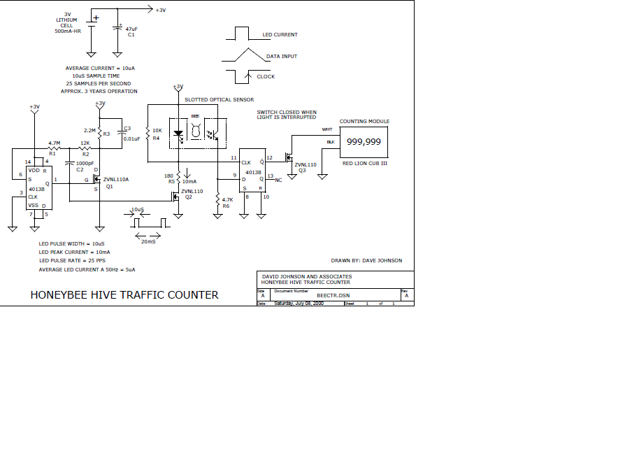

I have a friend who has numerious bee hives here in the Salmon Valley area. Just curious about how one would count number of bees entering, and exiting ( both ways = two figures # going IN and # going OUT
found this schematic on net and thinking about how one could be built using two slot interupter switches, a pic and perhaps an LCD.
better if it had some sort of data logger that the bee keeper plugs into to see counts. Handheld LCD module so only one would be needed to conserve cost as he has several hundred hives.
read out would count bees going in as well as going out.
keeping inventory of his livestock so to speak
schematic uses cmos and some fets but a PIC IMO would do a better job?
any thoughts on project direction suggestions

Unless you have lots of bee sized holes with a bidirectional counter on each then it is futile. Basically, it is totally impractical.
I agree with Pommie in that you need a bidirectional counter on each entrance, and each entrance has to be bee sized so that you can count each one.
However, I don't know how difficult that is to make, and whether it would upset the bees too much.

problem is getting the bees into and out of a small hole or use multiple holes. The friend of mine says his hives have slots at the bottom as well as a hole.

I am thinking that the units could share a common power supply or battery. A low end PIC should be about the same price as discrete parts. Too bad Dallas stopped making their 1 wire counter..
The in/out thing may have a solution too. I am not sure what it is but there are possibilities. One thing that comes to mind is having the in/out via tubes with two sensors. Depending on which triggered first one would know which way the bee traveled. To get that to work the bees have to cooperate a bit. But it may work. I will check around and see if I can find out how it is done. Has anyone googled regarding it ?
https://www.freepatentsonline.com/6910941.html
