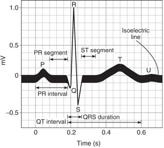

Can you provide a drawing of the waveform (e.g. from a DSO/CRO) you are monitoring? Is it anything like the waveforms here https://www.bem.fi/book/19/19.htm ?
The spike is quite narrow; is it possible that you will miss the part of the signal that you wish to capture by sampling at such a low rate? If you are missing the peaks, then you can just increase the sample rate of your ADC and perform the hysteresis or blanking in software.
That is exactly the shape of the peaks i am receiving at the input of the A/D converter, i think the best bet will be to 'over-sample' ( use a higher than necessary conversion rate) then use the software to scale down (blank) the answer by whatever factor is necessary, ive just calculated that with a fosc of 2MHz and, a A/D clock conversion of fosc/2 i should be converting at a rate of 1us. the duration of the peak is said to be around 0.08, which makes my rate of sampling still very fast. ill probably use a nested loop and the GO/DONE pin to slow it down more so that i am not adjusting from such a large value that i need to consider a large value stored across anything larger than an 8bit register

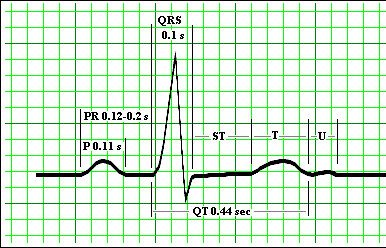

Except that the QRS part of the wave is generally less than 100ms, meaning that it's very likely that pulses will be missed with such a low sample rate.
ref : normal+ecg.jpge_parts.gif
https://www.cvphysiology.com/Arrhythmias/ECG trace with grid.gif

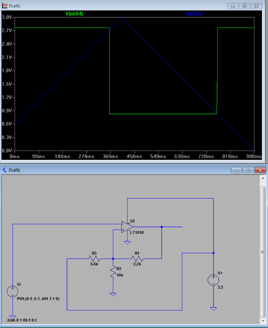

i actually already have (in a matter of speaking) done exactly what Rich said, the electrodes reading the heart beat were connected to the chest at one end and instrumentation amplifier at the other, the output of which was input to a bandpass filter, this was subsequently input to the microcontroller through the pics onboard comparator
the comparator exhibited multiple transitions for each input of the above threshold (the R portion of the cardiac waveform) so hysteresis was introduced.
Hysteresis failed to lower the output fluctuations to a level that was consistant (such that it could be eliminated through code) though the bounce was reduced.
i am positive the hysteresis values were correct because i simulated them in LT spice transient analysis and it shows the two distinct thresholds
so yes, i can get the cardiac waveform but cant get the input to the pic such that i can receive a meaningful digital pulse in order to continue calculations.
