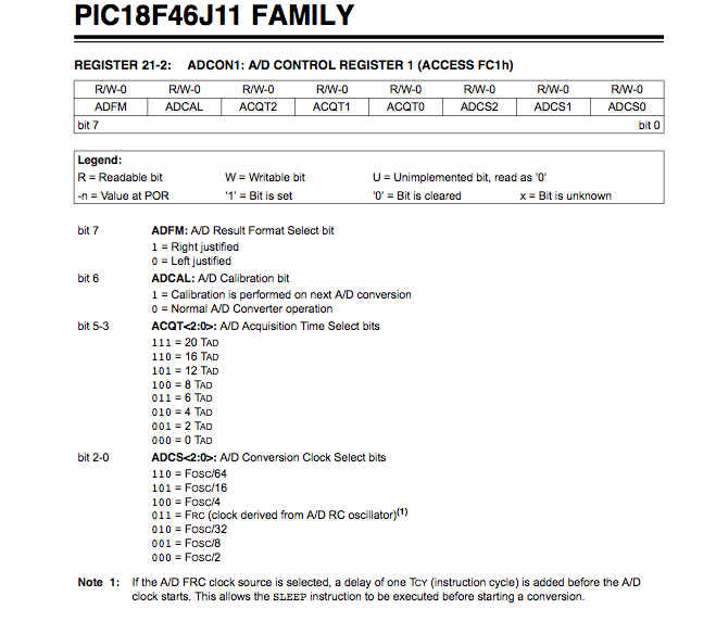

Hi i want to use the A/D converter to compare voltages received against a set reference. I am writing a short program which if the value received is above a predetermined binary number (representing the voltage reference), the micro will branch to execute a short sequence. if it is below it will discard the reading and wait for the next input.
However i am having trouble setting up the register. i want the A/D converter to sample every 0.12 seconds (Max), and my micro has a clock frequency of 8MHz. How does that relate to the
"TAD"
and
"ADCS" bits shown in the attached file (data sheet screen shot).
I just need a bit of clarification with regard to Acquisition time, thanks.

It all depends on the input impedance of the voltage you need to sample, and the speed you need to sample at..
Higher impedance generally means slower sampling, so if you have an 8Mhz clock you really have only one option fosc/32 according to table 9-1 in the datasheet.
However you can select a faster conversion if your impedance is low enough.... The quicker you read the ADC sample the less accurate it will be.
If you have a really high impedance you can still take a sample, but you start getting sampling errors...
Equation 9-3 in the datasheet is the best read on this subject.
PS sorry the more TAD cycles you can get away with the better... Normally I use 11... Same as the datasheet...

my task now is to determine what value of TAD will give a 1/8=0.125s rate of sampling given an 8MHz oscillator frequency an 2MHz instruction cycle how do i go about this, im a little confused because values for acquisition time are given as arbitrary values (12 TAD, 8 TAD, 20 TAD) not actual frequencies

The acquisition time is explained in section 20 and 20.1 https://www.electro-tech-online.com/custompdfs/2013/06/39932b.pdf
When you change the ADC channel that you will be sampling, you need to worry about the acquisition time. If you're just using the same channel for each sample, then you don't have to worry about it for any conversion except the first. The acquisition time is the time for the internal hold capacitor to charge, and not the time between samples as I think you may have believed.
So the simplest (not requiring thought) setup is to use the internal AD clock (which means that your fosc frequency doesn't matter), and you can set max acq time if you're changing channels.

Thanks dougie, you're right, i was of the opinion that acquisition time was for time between samples. things are a bit clearer now
