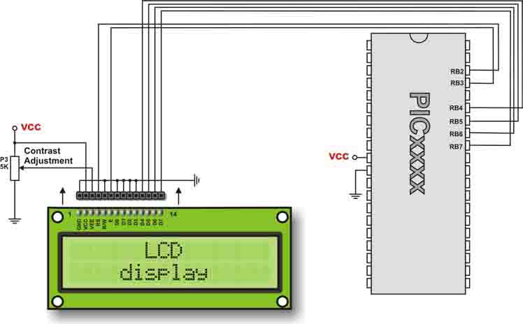

Hi all,I am new to this forum.I interfaced pic18f4550 microcontroler to lcd ,I wrote the c program and compiled it in mikro c compiler.The code I compiled was example provided by mikroc. it was actually written for pic18f8520 I changed to 18f4550 in the project window.the problem is, i am not getting anything on the screen.can anyone help to solve this problem?
The oscillator used is crystal 8Mhz
trim pot 5k to contrast change.
lcd(16*2 display) similar to hd44780,it has 8 data bits d0 to d7,vcc,vss,backlight led all similar to hd44780.
The c program is below

The example you have looks like it uses a 4 bit interface. At a guess (I don't have mikroC) it is using RB7/6/5/4 for the data and RB2/4/3 for the 3 control pins. A diagram of how you have wired it would help.

I checked the connections but still i am not getting any display except few black blocks on right side of the lcd display when I varied potentiometer to give max. resistance.

I don't use MikroC, but your control and data had same pin (4), so when data change the control also change, result Lcd don't know what to do.
just try change control pin(4) to 1
Lcd_Custom_Config(&PORTb, 7,6,5,4,&PORTb, 2,4,3); // Initialize LCD
look at the given code - use Mikroelektronika`s LCD library for 2x16 text display (included in meny Tools). I have EasyPIC3 at 8MHz with the PIC18F4550 and this library works fine. Also, turn OFF the watchdog!
Use Lcd_Init for default pin settings (see the first figure below).

LCD HW connection by default initialization (using Lcd_Init)
