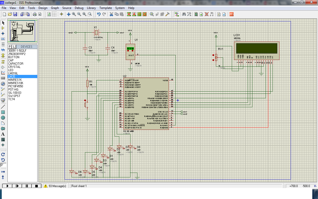

Hello, I recently purchased a Newhaven 2x8 Character LCD (Model: NHD‐0208BZ‐RN‐GBW). This is my first time programming for a character LCD, and I am having a bit of trouble getting this 2x8 LCD to work with my PIC18F4550. I am using MPLAB v8.76 with C18 Lite compiler (for programming in C).
I will be programming the LCD in 4-bits at a time. Here is the data sheet for the LCD I am using: https://www.electro-tech-online.com/custompdfs/2011/10/NHD-0208BZ-RN-GBW.pdf
Model: NHD-0208BZ-RN-GBW
(It is a 2x8 14pin (no backlight) character LCD display)
Updated:
Here is a diagram of the connections:
The data sheet provides me with the following code layout for the initialization:

Your connection diagram looks a little odd i.e. both Vss and Vdd connected to 0V. But you do have black squares displayed so I guess it's just the drawing that is wrong, not the actual connections.
I'm too dim to decipher the code you posted but I have done a few routines for LCD's myself, maybe they can help, maybe not. **broken link removed**

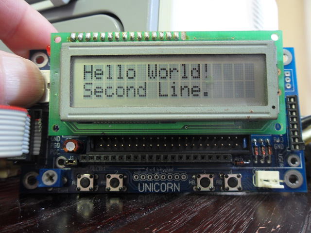

I just get a black squares across the top row while the bottom row is completely blank.
That sounds like the contrast. Replace your 10k resistor with a pot, if you don't have a pot, try various values of resistor. Your characters could be there, but you can't see them.
I'm still getting a black row across the top. I think D_I refers to RS, no? So, I tried to include that as well. I have a break statement in the loop so it is only running the routine once. Additionally, I moved the connections over to port D, so now I am only using one port.

I played around with the delays bit, I'm sort of lost :( . I also put a 10K pot to adjust contrast going into V0 (Looks the same as if I had it going to ground at max darkness).

@Angry Badger - I managed to modify your 4-bit character input example. The difference is that I am using portD instead of C. The black bars across the first row now turns into 2 rows of light gray after about a half a second (So, the LCD was initialized? I don't see a black square in the first row or anything that your pictures indicate). However, the character commands do not work. No matter what I send in, the squares remain blank.

If I can't get this to work could you guys maybe recommend a 2x16 LCD that you have used before so that it is easier to assist me? I would really appreciate it. Thanks.
I'm a little confused. In your first post you show the data pins connected to port B but in your later code you write to port D!
Can you confirm what is connected to where and post your latest code?
I'm sorry for the confusion. I was trying out the other users code which required all of the LCD inputs to be on one port so I moved them over to port D. As a result the current connections are as follows:
E --> RD6
R_W --> RD5
RS --> RD4
DB7 --> RD3
DB6 --> RD2
DB5 --> RD1
DB4 --> RD0
I had V0 going to ground before, and now I have a 10k potentiometer going to it (Both produce dark enough boxes).
Latest code (following nehaven data sheet):

This has been bugging me and so I dug out my Unicorn board, put a 2*16 LCD on it and got it working.
I had to change the init routine and the write (RS=1). Plus I added a PutMessage routine.
Here's the result,
lcd-jpg.57464

hey micro 9000
while(1)
		LEDPin=1;
		init();
		break;
in the main loop, there is nothing that redirects you to the display routine.. i think that is the problem.. :)
@Pommie Thank you so much for your help, but there is still a problem. The newer bit of code that you added does appear to properly initialize the LCD, but I only see a blinking cursor. The only thing I modified was changing "Hello World! Second Line" to just "Hello world."
init();
        PutMessage("Hello");
        command(0xc0);
        PutMessage("World");
Here is a video demonstrating the problem.
https://www.youtube.com/watch?v=60lzKOm9_20
Even more perplexing is that if I remove the "put messages" or I change them in anyway the blinking cursor in the video is no longer be displayed. I'm guessing that it was just luck that I put in the correct amount of characters for the display to output that blinking cursor that is present in the video. However, I now see two rows of boxes instead of just a single row.
@magnatro Yeah, I didn't call to the display routine since I just wanted to see a blink cursor so I could tell if the LCD initialized correctly. I'm not sure if there is a requirement to call the write or command routine in order to see what I have shown in the video.
Again, I thank you for taking the time and for your assistance. The code is the same. The only line I changed is in main where the put messages reside.

I'm not sure what to suggest as that code works fine on my setup. Have you double checked your wiring?
I'll double check it again and I'll try a few things with the code as well.
EDIT:
Wiring was incorrect. The way that the uC is oriented with the ribbon cables the wires were mixed up. It was a bit hard too see, but I had the data lines mixed up. I'm sorry for not checking more carefully. I'm going to test it out right now.
EDIT2: That did the trick thank you so very much. I'll post video in a sec.
