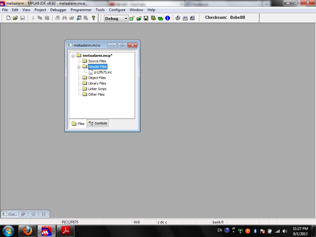

PIC MPLAB screen
Hey Ian,
here is my progress so far,I have switched to PIC12F675,since there is no 629 in my store.
I have found the correct header,and inserted i correctly(hopefully).
The new clock is 20MHz.
WKR,
Sima
Hi Sima,
Now, add your source file. You may want to put it in its own folder, because MPLab will add some files to it when you build (compile) the project. That is a personal preference and is certainly not any requirement.
John

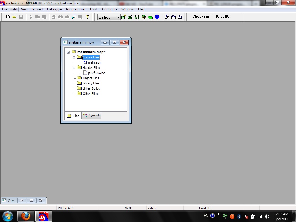

Main.asm
Hey jpanhalt,
I have copied what dougy83 wrote earlier in the thread,and named it main.asm,and I had put in source files,so my project now looks like this.I think you meant for me to do that,right?
Kind regards,
Sima
The pic12f675 has a 4Mhz internal crystal aswell!!
Just put it all in a single file
