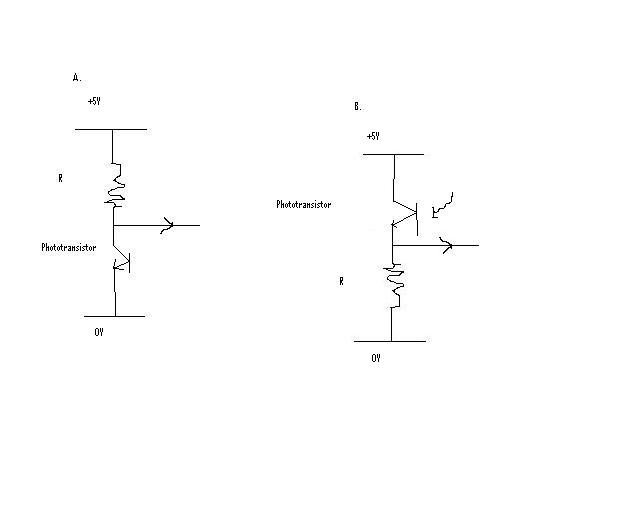

i want to connect a phtotransistor to a pic to receiver a pulsed input from a transmitter. Is this connection right??
what i want is for output to pic to be high when light comes into the pic
what resistance value do i need to set?? i have added a picture of what i am trying to explain.
will i need other components to achieve this??
i am meant to set a resistor value that sets the output to the PIC as >2.8v for a high and <0.4v for a low.

details you might need to know about the phototransistor;
collector emitter voltage: 35v
collector current: 15mA
collector peak current (t<10us): 75mA
Photocurrent, collector to emitter (1000 lux, Vce = 5v): 5mA typical
Configuration 'B' would make the pin go high when light falls on the transistor, however, configuration 'A' is the way it's usually done - 'A' can pull the input closer to 0V than 'B' can to 5V.
The only difference is a very slight change in the program, so it makes sense to use 'A' rather than 'B'.
As for the resistor value, I would find it by experiment!, all you need is a few resistors and a multimeter.

on the resistor value thing. Measure the mA with max light and no resistor (just connect it to power rails) then use v=ir or rather r=v/i to work out a resitor value.
The v to use is your max voltage, the i to use if the measured current + 10 or 15%
I get a value of 12k, so i would use a 10k resistor + a 5k pot. or similar to get some tuning range.
