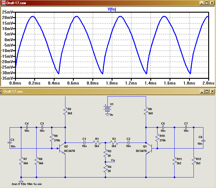

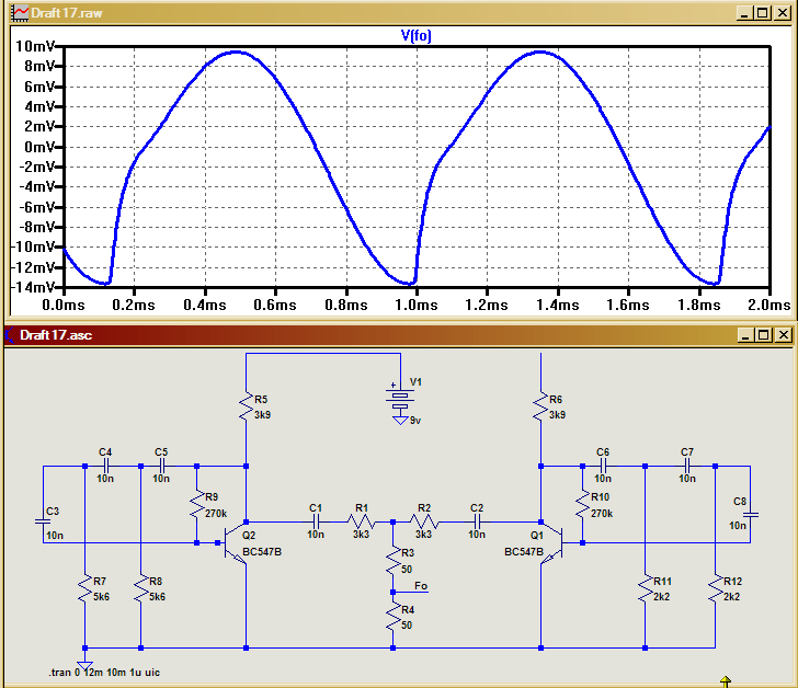

View attachment 41764View attachment 41765
yuk. Thanks for saving me some solder and verostrip lol. I have come across another interesting design. Its a frequency multiplier. :
