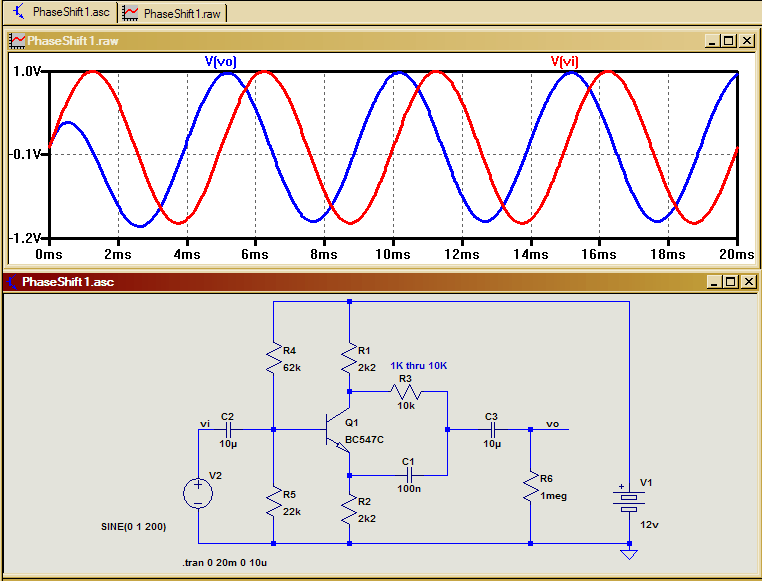

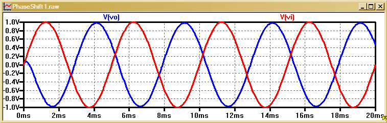

Give me a few minutes and will post a handy little phase shifter circuit.
EDIT:
Look at these images.
φ= 2 * tan^-1* [R3/Xc1]
Where Xc1= 1/[2Π f C1]
The image showing the circuit is with R3=10k and the smaller image with R3=2K
