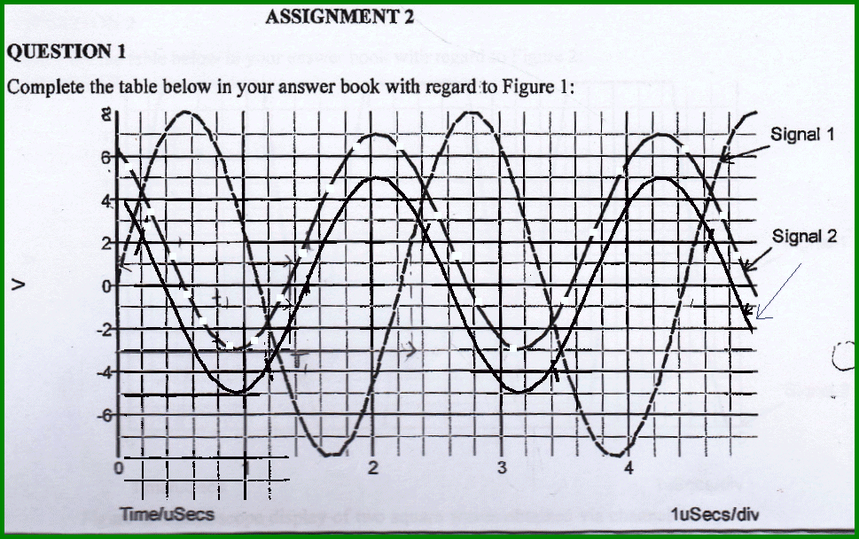

Q: Calalate the Phase Diff between A and B Signals.
my ans is θ= t/T*360 =2/3*360=240 deg
this what i have learned???

Hello there,
I think you got the 2/3 from the fact that one signal goes through zero 2/3 of the way from a minor division? Just a guess, but if so you're on the right track. Only thing is, one division is not 360 degrees and there is also another full division between that signal and the other signal.
First figure out what one minor division (horizontal) is, then go from there, and remember to add any other minor divisions if necessary to get the total phase shift.
Hello again,
If you look at the larger amplitude wave during the first half cycle it spans approximately 4 minor divisions (actually a tiny bit less than that but we'll call it that for now and you'll have to adjust yourself later). Since a half cycle is 180 degrees that means 2 minor divisions (half of that) is 90 degrees, and so 1 minor division is equivalent to 45 degrees.
Now looking at the last half cycle of the bigger wave, at the time it rises through zero (the leading edge) it is approximately 2/3 of one minor division past one major division, and since one minor is 45 degrees that means it (is 2/3)*45=30 degrees past the second to last major division. Looking at the smaller wave near the same major division, its rising edge going through zero is approximately one full minor division before the second to last major division, so that means is is 45 degrees before that major division. Since the smaller wave is 45 degrees before and the larger wave is 30 degrees after we add the two and get a total of 75 degrees phase shift.

Hi
I Understand what you say 1Cycle =360DeG. Sig2 crosses @270
This means that Phase Shift =2.4-0.8/3.2*270=135 Deg

I have a similaiar problem with a solution from a previous assignment .Can we pls dicuss it.

Hi again,
In the first exercise the phase shift is close to 75 degrees. Usually we choose the two rising edges that are closest to each other (as they go through zero) and then tag on 'leading' or 'lagging'. If you want to say it is close to 270 degrees you may get away with it, but not 135 degrees. If you still dont get this i'll post a more detailed explanation.

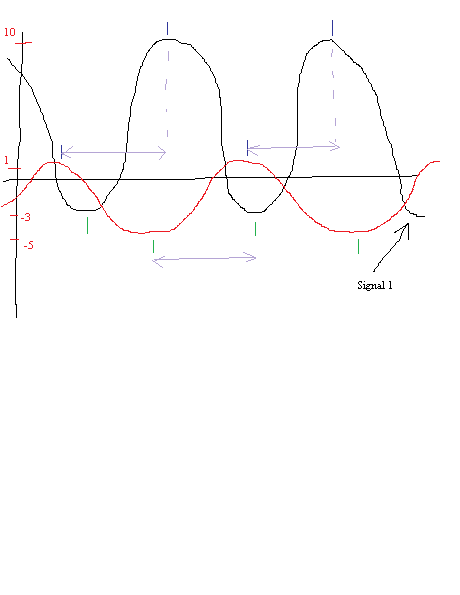

Your second graph has a phase shift of 120 degrees (note we take the two rising edges that are closest to each other again). See the attached diagram to see why this is so. Signal 2 has a DC offset so you have to compensate for that first by zeroing it out. Note that the 'old' signal 2 is a dashed line, while the 'new' signal 2 after shifting is a solid line.
I actually estimated it to be around 115 degrees with a quick visual, but 120 might be closer.

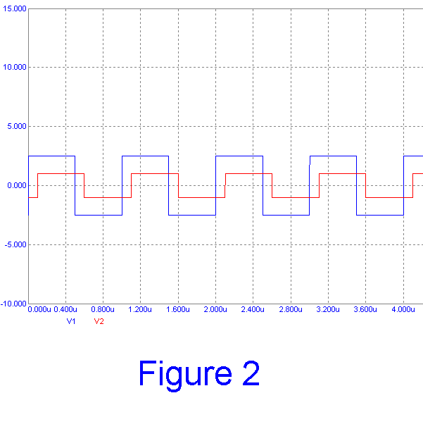

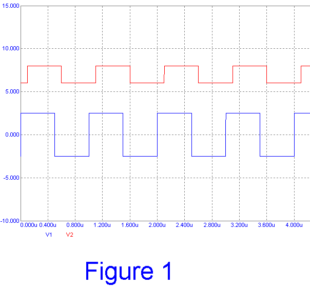

Hello again,
A more general method is to use the zero crossing, and if there is any DC offset to remove it first and then look at the zero crossings. On a scope, we would adjust one or both waves vertical positions.
Refer to the attached drawings, Figure 1 and Figure 2.
In Figure 1, we see two waves, the blue wave goes through zero but the red wave doesnt yet we want to know the phase shift.
In Figure 2, we removed the DC offset from the red wave so it now crosses through zero. The phase difference is now easy to see.
Note we cant always use the peaks to get the phase shift, but we can always use the zero crossings.

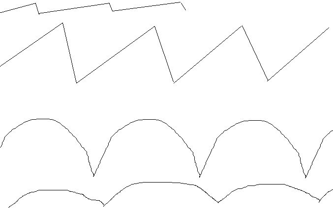

not sure i agree. if signal does not have steep slopes, what looks like zero crossing may introduce significant error (for example things that resemble sine wave). imho, it is safer bet to lock on feature that is easily recognisable or well defined.
an example could be any number of simple forms like shown here. to find 'zero' on saw tooth, one could simply split slope line between peaks. but doing same for rectified sine wave would require integrating etc. doing it off 'zero crossing' from the graph would be way too complicated and inacurate. it is much simple to pick cusp (here on the bottom of the signal).

Hello again,
Yes sometimes it is easier to go by the peaks, but you still have to be careful. I could easily draw several wave shapes where you simply can not use the peaks or valleys. Some complex wave shapes will have their phase orientation defined elsewhere anyway, so you'll have to get used to find that spot and drawing a horizontal and/or vertical line through it.
A full wave rectified sine has it's phase defined by the generating sine in most cases.
