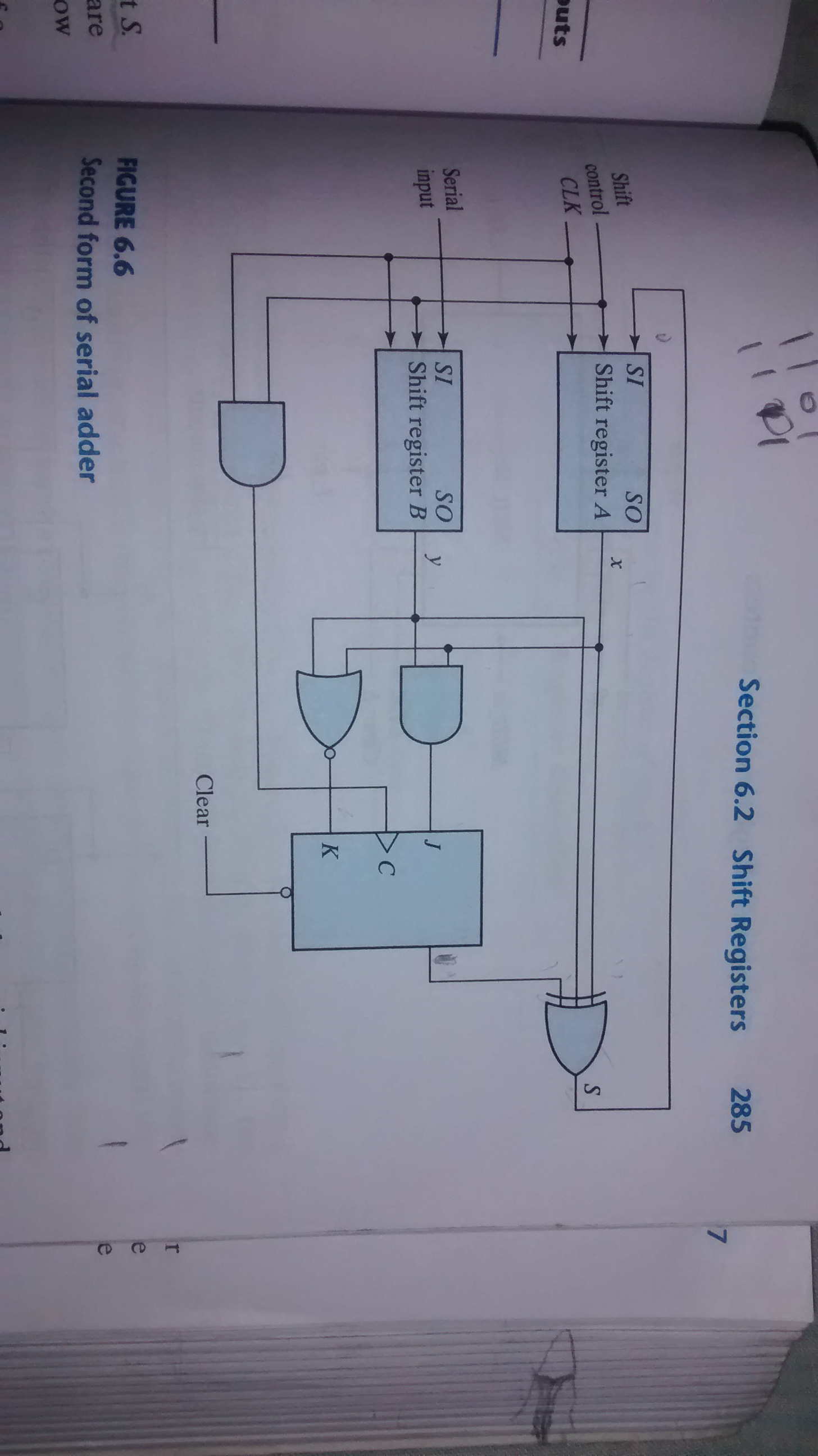

subtraction with shift register

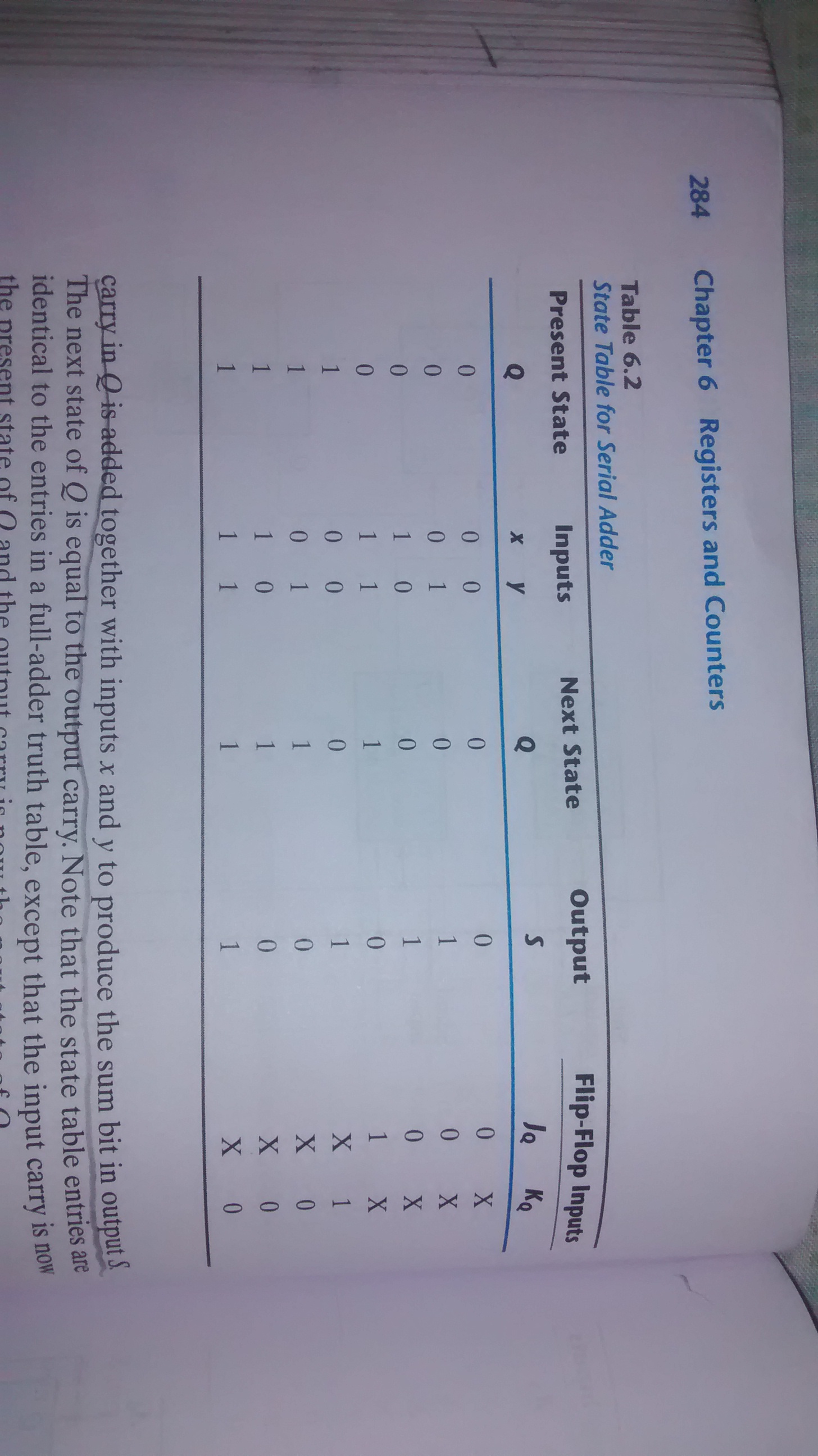

Using the circuit of Fig. 6.6(attached). show the changes needed by modifying Table 6.2(attached) from an adder to a subtracter circuit.

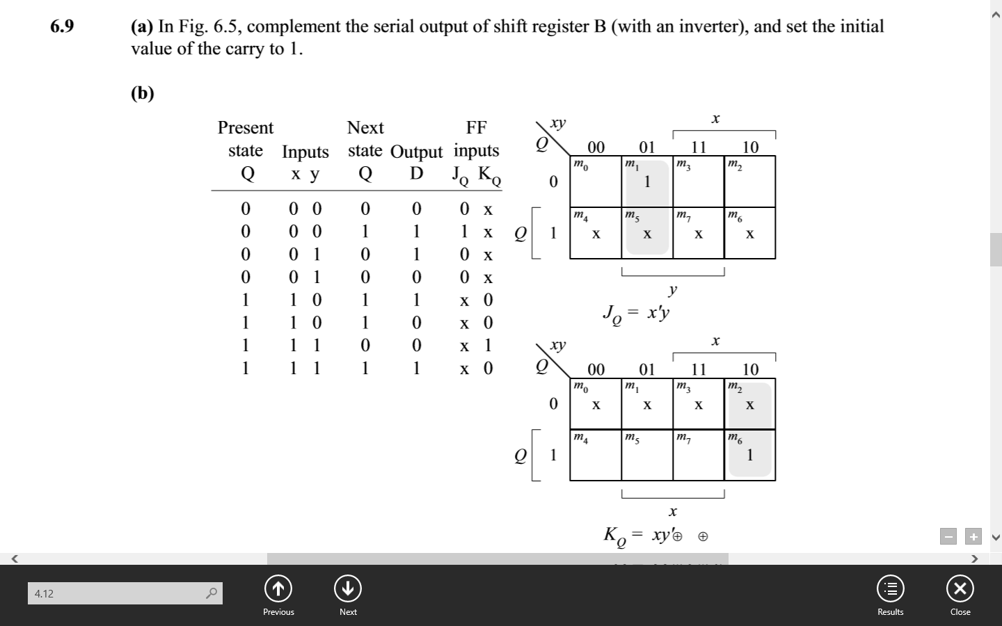

but the answer given is different(attached).its not looking as subtracter table . p;ease help me on this homework.its confuding me a lot. Thank you in advance.
