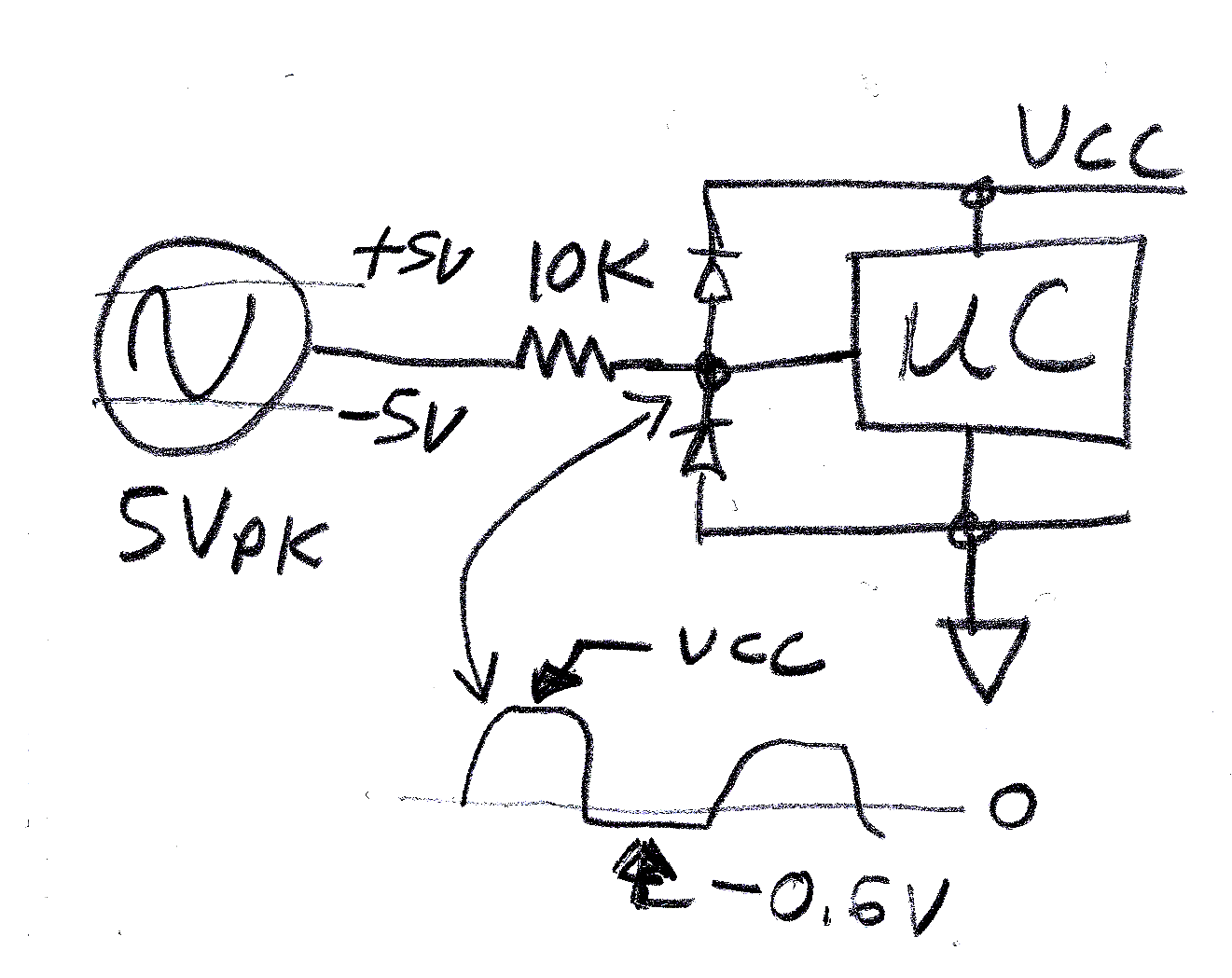

Schematic:
We have a micro controller running on Vcc which might be 5 volts or 3.3 volts.
The uC should not have a voltage applied to any pin that is below 0 volts or above the supply.
The signal is "5v p-p" which swings from +5V to -5V.
Inside the uC's pin there are probably diodes to help protect the part from over voltage. But I added external diodes for more protection. The 10k resistor is to limit the current into the protection diodes.
With the resistor and diodes, the voltage on the input pin will be limited to -0.6V to (supply+0.6V).
If the input pin is "digital" then it will switch at about 1.5 volts above ground. Maybe at about 1/2 supply. (depends on what type of uC) So this not really "zero crossing".
If the uC has a ADC on board, then you can measure the voltage. (depends on what type of part) The ADC can measure from ground to (VCC or Vref [which might be 1.25V or 2.5V or ??]). So if you measure the input as fast as you can and look for a voltage of 0 you will get a good idea of when the signal is above ground or below ground. There will be some delay because it might take 10uS for the ADC to work. Then another 10uS for the interrupt to get through the system.
I added some external parts, sorry. How simple do you want this?

Hello there,
That is like something i had in mind too although you would need one more resistor and possibly a second one.
The thing is though that most systems that have to detect zero crossing have 120vac line voltage coming in so a small error in the zero crossing is easy to obtain. If you REALLY only have plus and minus 5v (5v peak or even 2.5v peak) then the method starts to depend on the application itself and how bad one mis-detected zero crossing will affect the system.
For example, with 120vac that is 170v peak, so an error of 0.5v is no big deal in detecting the zero crossing in most cases.
If it is much lower like plus and minus 5, then you can predict the NEXT zero crossing after the original detection by waiting for a small period of time. This starts to get application specific though.
I recommend one larger resistor from the sine source to the diodes, then another smaller resistor from the diodes to the chip i/o pin, then if needed another resistor from Vcc to ground.
So that could be three resistors total.
We do not have any information. So we are just guessing. Most micro computer have input protection diodes good for 1 to 2mA.
I set 10k -5V = 500uA
and
10k +5V (or maybe +3.3v) = 0 or 200uA
If the signal was any stronger I would have used:
resistor, two external diodes (1n914 or 1n4148), resistor, internal diodes.
This way the first R and diodes can have high current. The last R & internal diodes see a single that is 0.6V above and below the supply.
