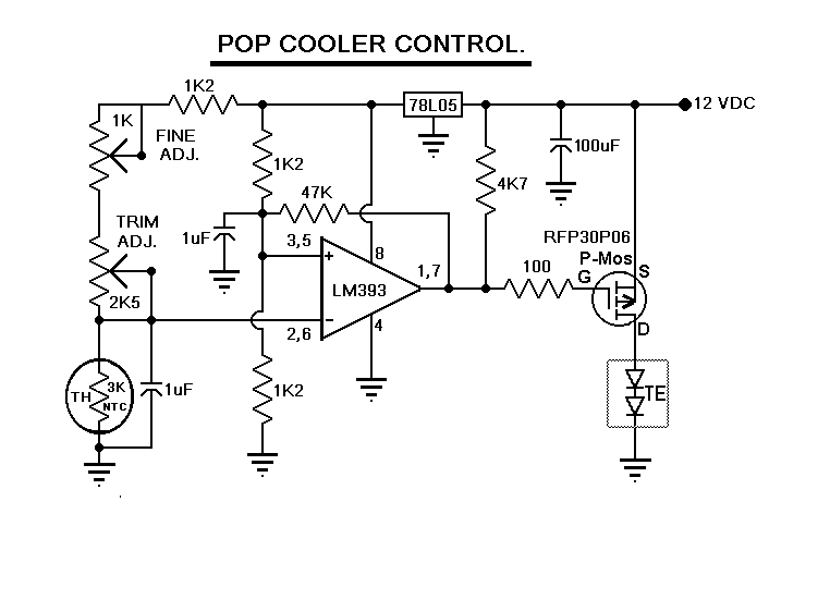

What are you using for a temperature sensor and heater controller?
You can use a Thermistor and a meter to Monitor the actual INSIDE Temperature.
Most Important is to Keep the Heatsink from getting Too Hot.
So as far as the Controller is concerned, it only needs one thermistor to monitor the Heatsink Temperature and control an On/Off Duty Cycle for the Peltier device..
This is because as the Heatsink gets Hotter, so will the inside temperature.
This Circuit worked very good for me.
