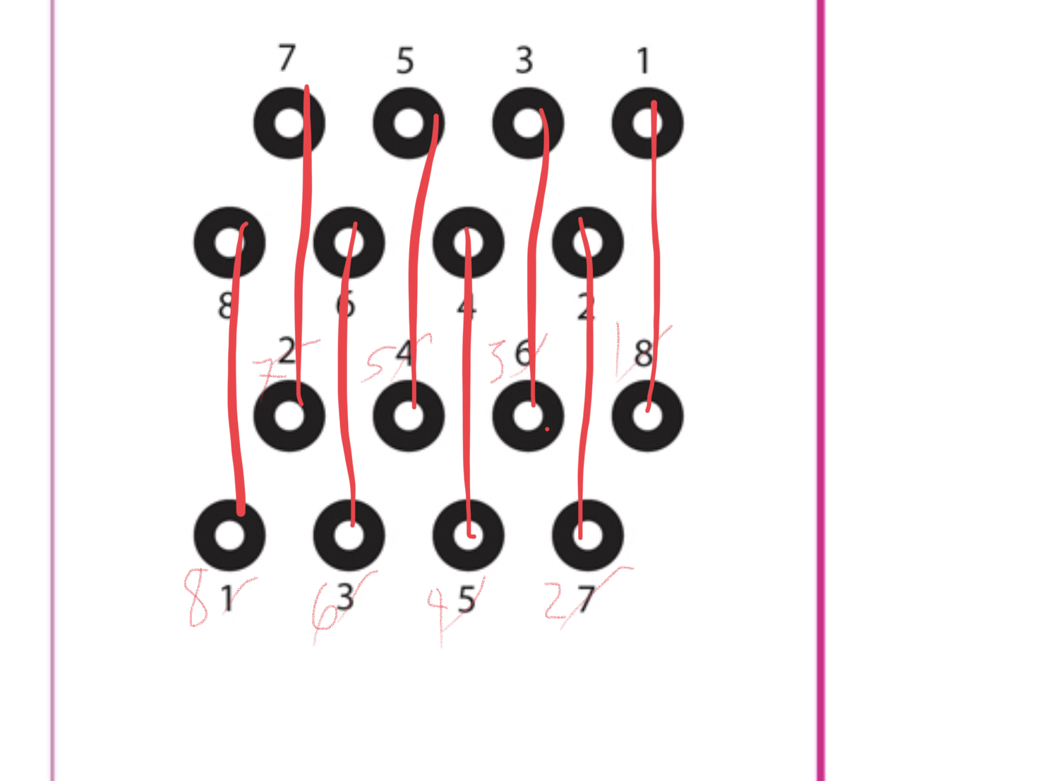

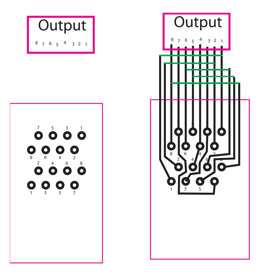

I only have one sided PCB board.
I wanted to connect the dots, so to speak, with as few jumpers as possible and found myself scratching my head.
Using the image on the left, I came up with a possible PCB layout on the right.
The 5 jumpers are in green.
I'd like the output order to be 1 to 8 and not 8 to 1 but can work with the 8 to 1.
Anyone like to take their hand at it?

I dont get what it is your doing. If your stuck with that layout and pcb already your going to be stuck with using jumpers and not much better can be done. Personally I would make a better board.

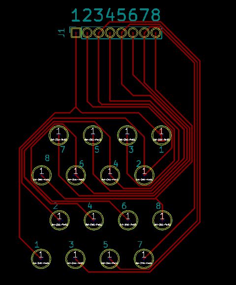

Im assuming the bottom part is a footprint you can not change and that the top part is some type of header for output and not just straight wires going out( and hopefully not edge pins)... If so you can fit it all on the board similar to this. Please excuse the sloppy routing. If you take your time you can clean it up, make it prettier and get it a lot tighter.
Forgot to label but is the same as your picture with output 8-1.
Here is one with the outputs switched to 1-8
I would turn the bottom connector 180° And relabel the pins.

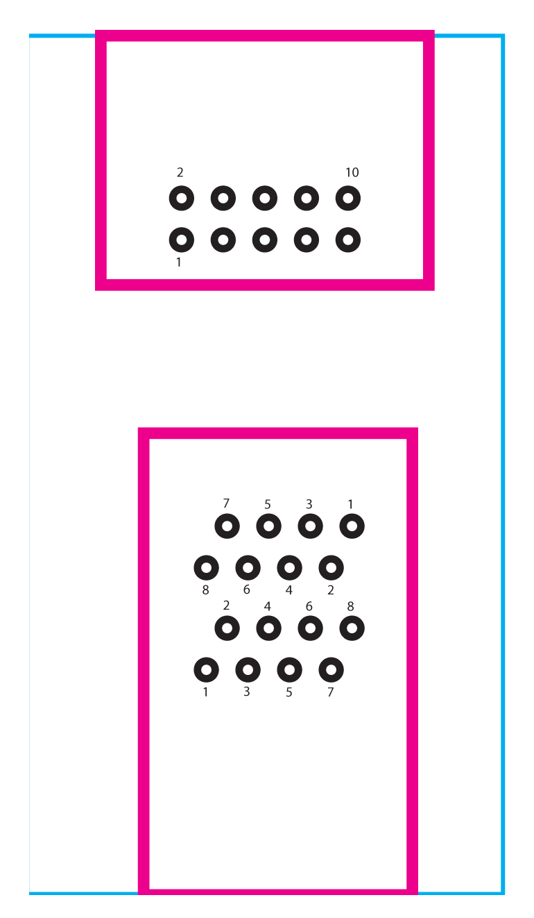

Yes the magenta outlined pads are a footprint and can not be changed. The blue square is the PCB edge.
This is a better representation.
Pins 9 and 10 of the output connector are not used.
I did not think about going around the output pins at first. Thanks.

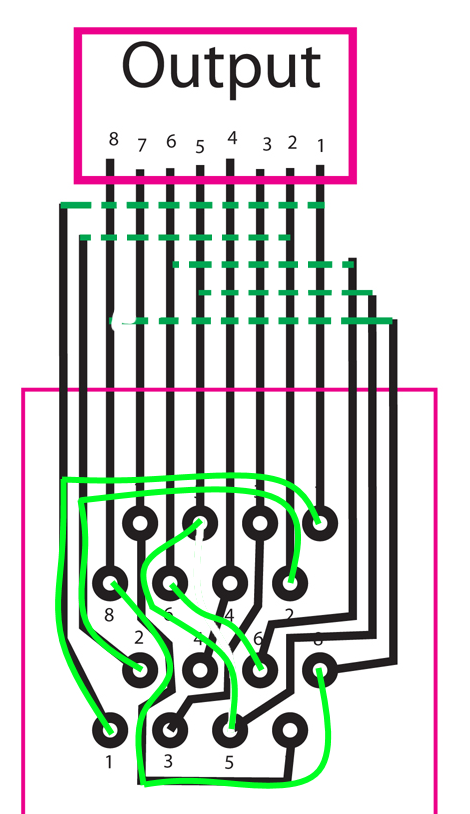

Try rotating the bottom part 180 degrees..
