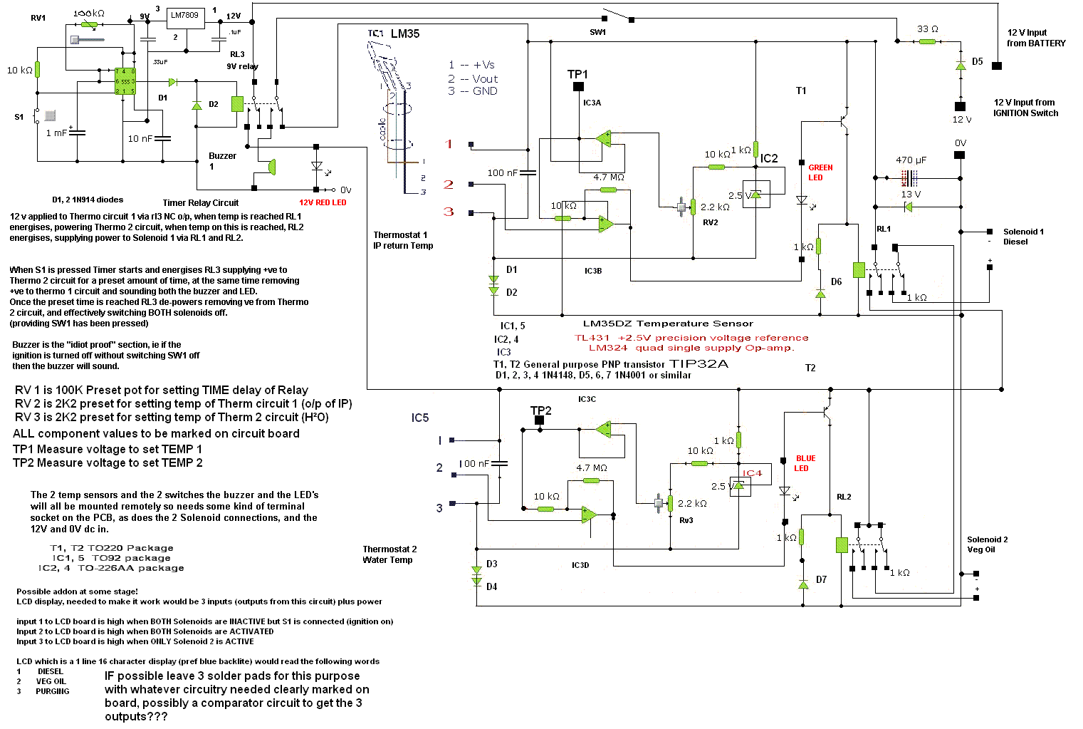

I've got the circuit (attached with this) that I want to etch onto a PCB, preferably single sided pcb but I've not the first idea how to go about this, I've tried using things like autocad (too complex and complicated) and ExpressPCB but I couldnt figure it out.
If anyone has "10" mins spare and fancies transferring my circuit design onto a pcb layout i'd be eternally grateful

when Karenhornby could ( i hope that this is his design) design such a circuit, he could well do the PCB also.
If not his design, the original designer would have given the artwork also and perhaps he could use that as well. I don't see a point in pushing it on the society

Karen, do you need this regardless of what happens with the display output (i.e. moving to the PIC?). If not, I think a lot of this might get folded up into the microcontroller code--maybe wait until that design is done before laying out a board for it.
Once the final design has been reached, I'd like to take a shot at laying it out, just for practice.

I looked over the schematic and there are several questions that need to be addressed.
the lm431 is avaible in several different packages.
Is this the posters design as several componets are labeled differently than what have seen before-RV1 ? figure its a pot?
I enjoy pcb design but dechipering can sometimes get daunting.

Its partly my design, but as I've said in the other thread relating to a PIC chip, I got the basic ideas for the circuit from here http://www.escol.com.my/Projects/Project-03(Thermostat-1)/Proj-03.html
I then modified the circuit so it has TWO temperature modules (LM35DZ's) feeding into an quad LM324 op-amp instead of the original LM358 (hopefully I got that bit right and it will work when I modified the circuit) THEN I added a 555 timer to it and some relay outputs.
WHAT the circuit is designed to do (if it works) is fit in my car.
The car will have 2 fuel tanks with 4 feed lines,ie 2 inputs and 2 outputs
Tank 1 (diesel) has the INPUT (diesel) going to the injection pump (via a solenoid switch) and the OUTPUT from the fuel injection pump via solenoid 2 into the TANK 1
Tank 2 (vegetable oil) has the fuel (veg oil) going to the injection pump (via a solenoid switch) and the OUTPUT from the fuel injection pump via solenoid 2 into the TANK 2
WHEN the ignition is ON AND temp 1 has reached its preset temperature (set by RV2 and yes this IS a preset) AND temp 2 has reached its preset temperature (set by RV3) then BOTH relays will activate switching the car to veg-oil and feeding the return from the fuel injection pump to the veg-oil tank.
IF the ignition goes off WITHOUT S1 (timer relay/circuitry) having been pressed but the car is running on veg-oil then a warning siren/buzzer will sound for the period set by the timer circuit and RV1 (another preset, this set for 50KΩ should give a time period of appx 69 seconds) after which the relay deactivates
IF S1 is pressed while the ignition is on, then relay 1 goes inactive, switching the fuel IN to Diesel, BUT keeping the fuel return on Veg-oil for the preset time set by the timer circuit after which BOTH relays de-activate
Relays are DPDT relays, type and size unimportant as they are only going to run a couple of hundred mA through them when switched.
Hopefully I've answered most questions there and compared with the circuit diagram attached to THIS you should be able to get the idea of what I'm trying to do now
The circuit I've enclosed with this is more recent and has the pinouts of the various components, or if not then the package details
Oh while I think of it, I have Croc CLIP (actually crocodile technology 606) thats how I got the design for the 555 timer working and know that bit works, but I gave up trying how to figure out how to get the temp circuits into croc clips as it dont have the components I'm using in it.
As to whether I use this design, or the more "complex?" design using a PIC?
I'm going to be using THIS design first just to prove the whole concept works good enough, and then (providing I can learn enough about PIC programming once I get a programmer and a development kit) THEN I'll make a 2nd version that has an LCD display instead of using the 3 LED's that this one uses, and hopefully far less components.

any ideas or suggestions for improvements/changes/mods/extra features always welcome
AND finally MVS SARMA yes I AM a beginner but im TRYING to learn and no this will NOT be commercial or for sale, its ONLY going to be used in MY car once I've got it working right
