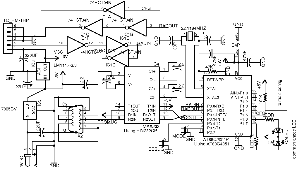

I made the following circuits. The first one is an application run on the microcontroller and it allows me to see data on a PC terminal via a serial port. Yes, I'm using a software uart. There's the circuit:
The HM-TRP connection point means a connection to the HM-TRP radio module. Now the next circut...

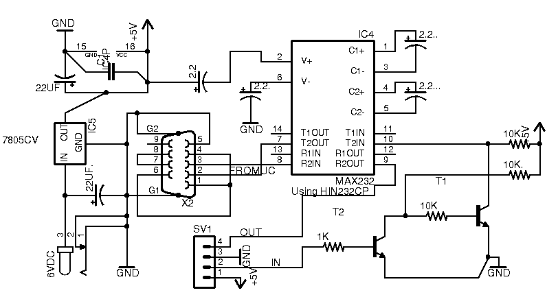

This next circuit is supposed to function as a simple PC to microcontroller serial port data provider.
Because I don't want to mess up the radio modules, what I did to try to simulate a module is connect pin 4 of circuit 2's SV1's pins to pin 2 of circuit 1's HM-trp's connection pins and I also connected Pin 2 of circuit 2's SV1's pins to pin 4 of circuit 1's HM-trp's connection pins. That way I can hook up circuit 2 to the PC and use that PC as if it was the radio module.
Even though neither circuit blows up, I'm not getting correct data, yet I set every single baud rate n the circuits to 57600bps. (57600 in the micro software UART, 57600 in the micro hardware UART and 57600 in both PC's attached to the circuit.), and both machines are running slackware linux, except one machine is using one release earlier, but I don't think that matters does it?
On the PC connected to circuit 2, its reporting that it receives a bunch of FFh, and the micro is telling me its receiving a bunch of 00h.
What's strange is that I tested circuit 2 by itself with the PC by hooking up the transmit and receive pins (pin 4 and pin 2) together, as if I was making an overkilled serial loopback interface, and it did function as such with absolutely no error.

The only thing that might be the case is that I converted 5V to 3V at the HM-TRP connection point so I don't blow up the actual radio module when I'm ready to use it (Its max voltage is 3.9 I think).
Is there something I can add and/or remove to these circuits to make both computers be able to communicate with each other through these circuits?

So it makes me wonder if the max232 chip on circuit 2 is creating a problem.

I intentionally hooked two inverters together as shown in my circuit to produce the original non-inverting output. If I only used one inverter, then the output would be inverted. I'm not quite understanding what you mean by IC1F and ICVF and I'm not sure if 10K is too big but I don't want to go too low or I'll be sucking up power like crazy (ohms law). although I did find a similar design with the transistors in which the pullups are 1K.
Are you powering all the inverters off 3.3V? it's possible that the last inverter on the RADIN path is unable to properly trigger a logic HI in your 5V MCU. That would be consistent with the difference between the MCU and snoop PC readings.

I can already conclude that part works ok because I did that setup in an earlier circuit and was able to transmit and receive data with the radio module in place.
Maybe I do need to change the resistors in circuit 2 because transistors have capacitance and factoring that in with the resistors might be the main issue. I read somewhere that using a bad combination of transistors and resistors means slower processing speed (propogation delay)

Oh, so it actually did work with the radio module there? Yeah, if that was the case then the inverters are able to trigger things properly and the problem must be in CCT#2 somewhere. In that case back to my first suggestion which I redacted earlier about trying <10K resistors in CCT#2.
Actually, I took a look at the MAX232 datasheet. You don't even need those transistors there as a voltage translator. You can drive the MAX232 TIN pin directly from a 3.3V device. At 5V power, the MAX232 accepts anything above 2V as a logic high while 3.3V devices typically output 2.31V minimum for logic high.
You also don't need IC1F or IC1E since the radio module driving 3.3V to the 5V MCU won't do any harm to the MCU, and the inverters are being powered off 3.3V anyways so it's not like they are boosting the voltage of the 3.3V radio to the 5V MCU.

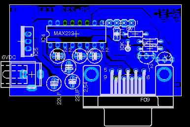

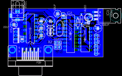

Before I rip apart my circuit, I read on texas instruments website about keeping some leads on the max232 to the capacitors short. I made my leads fat so that theres a lower resistance path. Is that setup I did in the PCB ok or does that prevent me from using 56K speed?
P.S. I attached my PCBs.

Don't "tear your circuit up". Just disconnect the transistor level translator input or output in CCT#2 and bypass it with a jumper wire.
ok, now Im getting somewhat better progress (at least I'm not just getting a bunch of null and FFh characters). I replaced the two-transistor circuit with just a 1K resistor and a ferrite bead in series for protection (almost a short). I'm going to change the batteries later or possibly use a second adapter. and see if that helps even though 4 AA batteries that were used to power circuit 2 were just measured at 5V. If that still fails then I might lower the resistor value but I do not want to create any unforseen issues with my circuit (sorry I have bad luck lately)
