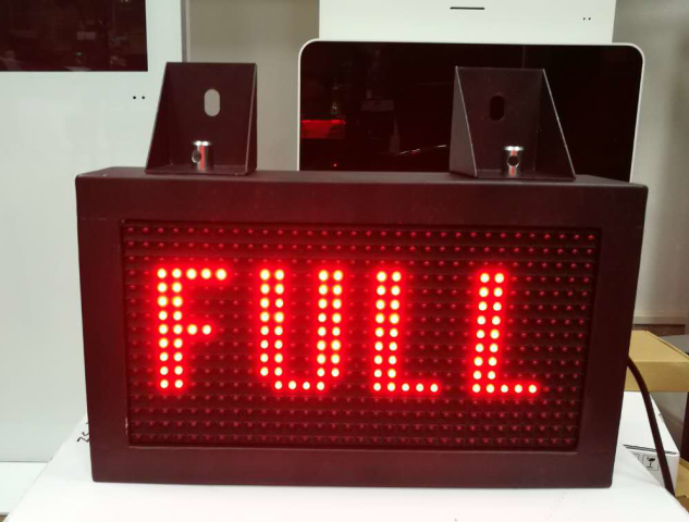

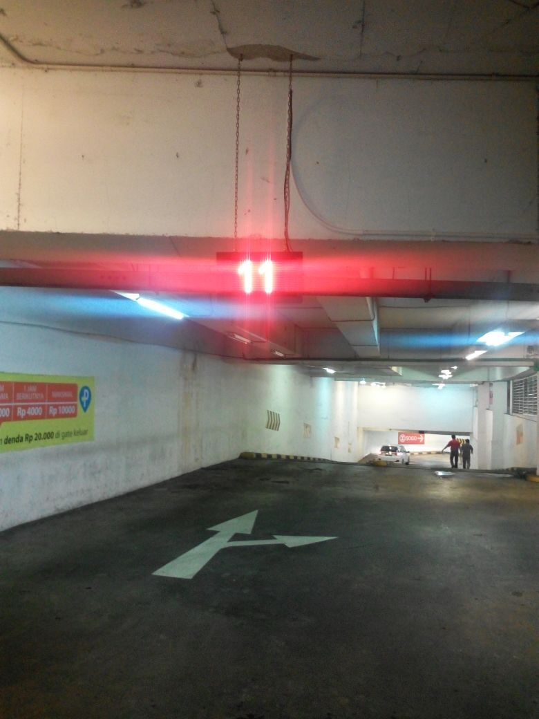

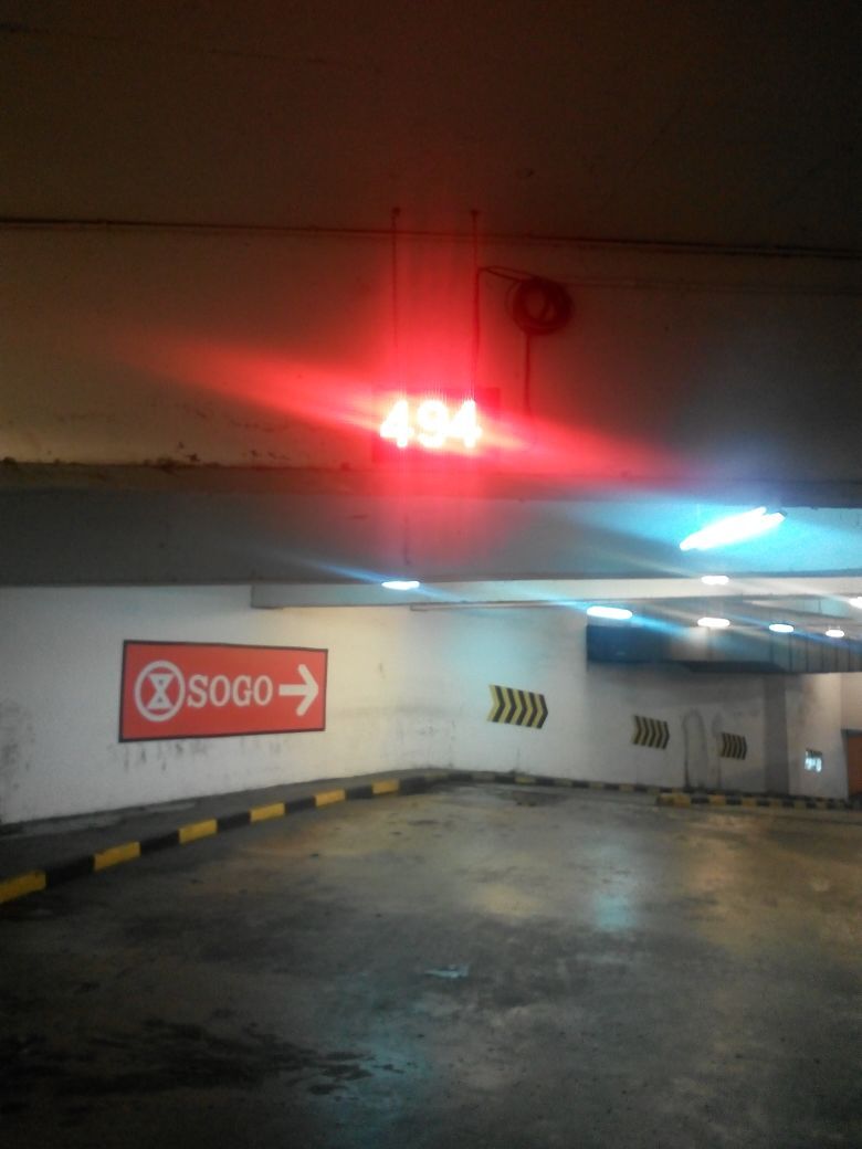

What an amazing input KeepItSimple! I will print out this thread as it will serve as a checklist for current and future projects.
For the displays: interesting to discover there is a German company doing thses, I was not aware and I appreciate your helpful comments there. Also, luckily these displays are to be mounted inside the building, no need for IP higher then 53 I think.
Colour, size, ..: customer does not care too much, as long as it is readable from about 10m.
As far as the W10 pc is concerned: daily and weekly reports are require, basic calculations (just the number of free spots for the day, for the week,..). However since we collect data per slot by the 10 seconds it is possible to generate extremely detailed reports.
R-Pi is an option I will explore for future projects, here all that is needed are 14 displays hooked by TCP/IP, power is no issue (the customer installs cat5 and power as we need). TCP/IP addressable text display panels are being made available, cost is USD175 FOB (see pictures), but since this is an all-in solution it is worth the cost for me: rather pay a bit more and save future debug headaches.
The parking slot sensors are wireless, they communicate over 868MHz to Wireless Data Collectors with directional antennas; it is the job of the programmer to link all 7 or more WDC's together and collect all these data in a correct manner.
UPS: very interesting observations in your post; will be included; I need to look into this more in detail and together with the programmer to find a correct concept.
Test routines for sensors: very sensible observation; especially since they are wireless: needs to be verified and correctly implemented with the programmer.
Web application: nice for future use; here all the customer needs is one computer graphical display with the two floors showing status for each slot; and on the left a bar with the values on the 14 displays shown. No need for sharing or client pc's.
Labview: I will explore that route.

Cabling and wiring: I would prefer to use cat5 all the way; from the WDC's to the pc is a given due to the nature of the WDC hardware; and for the displays same due to the nature of what I was offered by the supplier (see pictures and comments above). And customer will do the work, so no cost issue for me.
KeepItSimple, I want to thank you profoundly for all your comments and for the time you put inti this!
