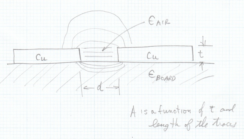

If two traces are close to each other, and in one trace there is suddenly a pulse of voltage, then a capacitance is created between the two traces.
I dont understand why, and what parameters that capacitance's size depends on.
I know that C = I / (dV/dt), C = Aε/d, and that Xc = 1 / (jωc).
I jst dont understand that, and would love some help.

The capacitance is always there whether or not there is a pulse. THe pulse does not create the capacitance- that's a bit like saying "If I don't see it, it doesn't exist!" THe capacitance increases as the traces are moved closer together and the longer the distance that the traces run beside each other.
A is the area of the capacitor's plates - the area of the traces - and d is the distance between the plates - the traces.

The capacitance isn't created by the voltage pulse, the capacitance is always there. The voltage pulse on one side allows the natural capacitance to cause a voltage transfer between the traces. Under normal conditions (lower voltage slower rise/fall times) the capacitance can be disregarded. High frequency or surge situations are very different.

Maxwell's theory explains capacitance based on electric fields in the general sense, and requires understanding of Calculus, and generally requires a finite element computer modelling to solve. C = Aε/d is a highly simplified equation (derived from Maxwell) that sort of works for a very simple case of a parallel plate capacitor. Here is a picture for you to think about:
