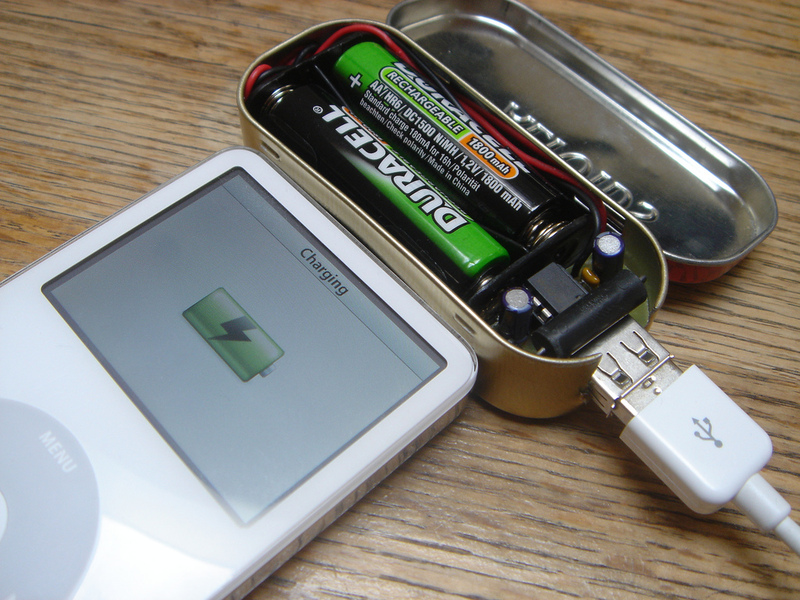

On older chargers it was quite crude, just using a couple of resistors - have a look here:
And this is why you might get different charging rates with different leads, some leads are for charging only, and don't have the data wires - so the phone may will only charge at the lowest possible rate.

Read the article I linked to - which explains it all (in that specific case) - simply resistors in the charger connected to the unused data lines. The phone reads what the resistors are, and that tells it the charging capability of the supply, and the phone draws the relevant amount of current.
