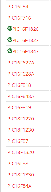

I just tried a quick parametric search of Microchip for 8-bit, 18-pin chips. List is not that large, if you eliminate the 18F results:
Here's a link to the search page: https://www.microchip.com/ParamChartSearch/chart.aspx?branchID=1005
If you go with any of the newer chips, you will get a CCP (compare/capture/PWM) module that makes timings like we have mentioned really easy. You just let the timer run and do a simple subtraction for the duration. Latency is negligible. For simplicity and Assembly language, I would stick with the 16F versions.
