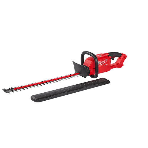

I thought of doing this. Then I just bought the Milwaukee M18 Fuel trimmer, chainsaw and sawzall. The trimmer goes right through 3/4 inch branches. - sharp with great power. Amazing tool.
I can work all day with the trimmer on one 9Ah battery (it came with two). The chainsaw came with a 12Ah. I bought the sawzall without batteries because I use one of my 9Ah for that. Like my children, I love all my tools equally.
