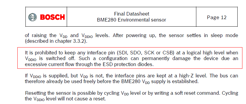

I have encountered another problem though (which is probably what killed the BME280). BME280 has clock idle high while Max7219 is clock idle low.
The circuit was pulled down when I connected the 2 clocks. So my project is probably dead anyway. Looks like I'll have to use a lcd.

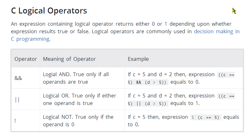

IF SSPBUF<>"!" Then getdata ' wait for reply (!)
Where the heck does "!" come from and why?

Yes but isn't that using C? The code in SPIMast.pbp was Pic Pro Basic and the ! was within inverts i.e. "!" so surely that makes it text.

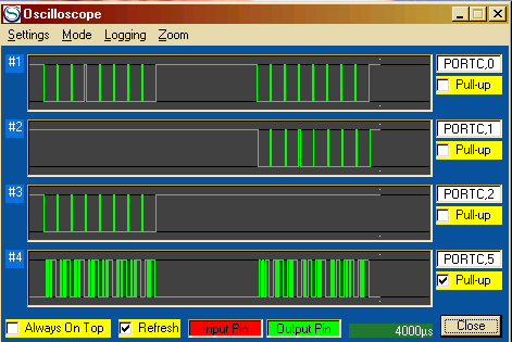

I do not see a direct way of using Oshon Basic for two SPI devices, but the following method is worth pursuing.
Assign the SPI pins as normal, use two additional output pins on the PIC as CS1 and Cs2.
Connect the CS1 line to one devices CS select and the CS2 line to the other devices CS select,, the 'normal' CS0 pin is not connected.
Refer to the attached Basic demo and scope image for the method and result.

I am assuming that you have the PIC/MCU as the SPI master and the two external SPI devices are slaves.??
If that is the case, the PIC/MCU will control the data I/O transfer from the external devices, so why did you consider using interrupts in the master.?
Do the two external devices have any sort of data Ready flag, that you could use for a MCU interrupt.?

Before I try anything else though, I have a hardware problem. When I connected up SDI, SDO and SCK to the BME280 (Max 7219 was already connected) , the 5V went down.
I tried a few variations, and found that SCK was causing the problem. I think that's what killed the BME280.
The BME worked fine on its own, I was able to set up and receive data from the BME. I even got Temp, Pressure and Humidity readings using Oshonsoft AVR IDE.
I switched to PIC16F877a after my Mega328P failed (bad connection on the Xtal).
The max7219 also worked with 877a. it was only when the SCK was joined up to all 3 devices that the 5v failed. Joining SPI/SPO made no difference.
I checked the 3.3v-5v level changer this morning and that is working as it should, so definitely a dead BME280.
The only difference I can see between BME and Max is that the clock (SCK) is idle low for one and idle high for the other.
I can't see why that should destroy the chip though.

Is it possible that you have damaged the BME by powering up the MCU, BME and Max in the 'wrong' sequence.? ref image A03, A04.

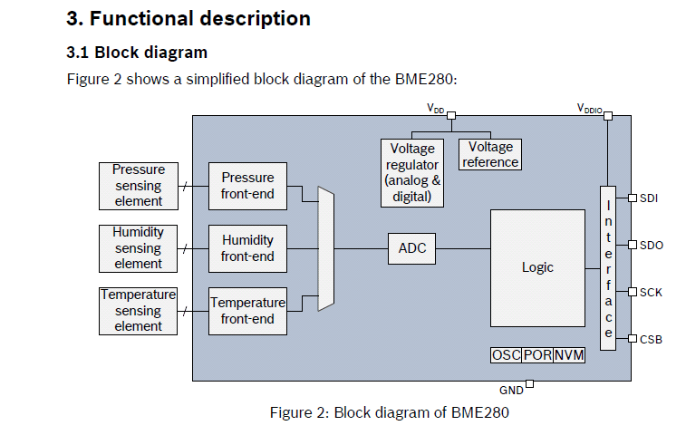

Hard to say, the BME came on a mini breakout board, it only has one 3.3v imput. So I guess the plan is that both VDD and VDDIO are powered simultaneously.
None of the mini pcbs come with a separate VDD and VDDIO, just 3.3V or 5V for those with a built in 3.3V regulator.
VDD and VDDIO on the chip both have a track to a capacitor (1 each) but I can't see any more tracks to follow. There's another 4 resistors and that's it so
I definitely did not have power on when I made the connections. The 5V dropped slowly over about 2 seconds. When I was testing each wire, I powered off as soon as the power started to dip. VDDIO is used for I2C SDA and SCL!!!!!. Maybe because I was hooked up to the PICKit2 at the same time SCK got some voltage, but then the 3.3V regulator would ave needed to be powered to pass it on to the BME. I'm using 2N7000 as the voltage levelers.

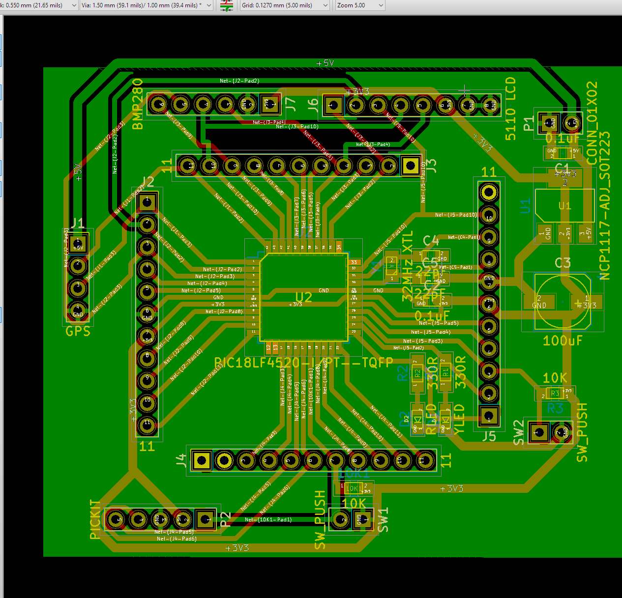

Hi E,
Instead of physical effort, I chose to push on with another difficult thing, making a PCB. I think I've drawn it at least. This afternoon, I should be able to check it and etch it.
Here's a photo.
EDIT: There are a few minor erros, but it should work as a test, then Ill improve it later.
Cheers, C
