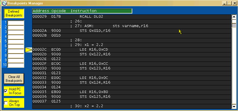

This image using the Oshonsoft Breakpoint display, refer the 'sts' action.
I don't use Assembly Language, but after checking LDI and STS, it seems to be assigning 4 values to R16 then moving R16's contents to 4 sequential addresses?

My question is, If I call an ASM routine, how do I get the variables out so that the BASIC program can use them.
E.g. if TempHum.asm communicates with the BME280 and generates variables called Temp and Hum. Are they in memory ready to go?
Is it just a case of knowing what they are called?

I will write up a simpler program to show the 'sts'.
Oshonsoft does shuffle the Basic and Asm code around in the list, it can be a little confusing.

Just had a quick look at the .bas file. Won't that just keep overwriting r16 with the next variable ?

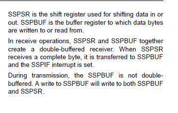

According to the DS, SSPIF is set when data is transferred from SPSR to SSPBUF, but how do I monitor SSPR? Is this the mysterious SSPCON2.
According to the DS SSPR is not directly accessable.

You don't monitor SPSR, the SPIF will be set when there is data in the SPSBUF, you read the SSPBUF, check the SSPOV to make sure there has been no SPSR overflow.
If no overflow, the data you have read from the SSBUF is valid, clear the SPIF flag.
If the SSPOV is set, then there has been an overflow of the SSPBUF, so the data is invalid, dump the read contents, clear the SSPOV and the SPIF flag
Await the next SPI interrupt.
