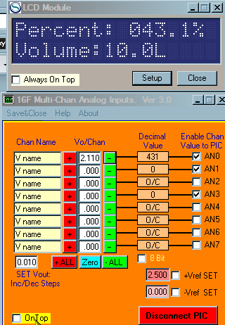

Here is an image of the jim2.bas running.
  • jimredo2.txt

hi eric...
have just spotted some problems in the pictures you sent me...
my intended range is:
0.5V = 0L = 0%
3.71V = 20L = 100%
the ranges in those pictures are...
0.5V = 0L = 10%
3.71 = 19.9L = 75.5%
seems like the Litres works fine but not the percentage... if it is a tricky one to solve feel free just to remove the percentage line from the LCD....
will still test to see if all else works on my hardware tomorrow, im due some luck this week so fingers crossed...
Jim

I was under the impression you wanted the Percentage to relate to 0V =0% and 5V =100% and the
Volume to relate to 0.5V= 0vol and 3.71V = 20vol.
Changing the scaling to give you:
0.5V = 0L = 0%
3.71V = 20L = 100%
Its a simple matter to change it, I'll run thru it today.:)
thank you... you are a ray of sunshine on an otherwise cloudy day :)
jim
