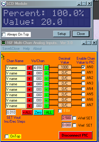

hi Jim,
Divide the 1000 counts == 4.88v by 5 to give a value of 200
'scale the 5V input to 4.88v using a resistive divider
readadc:
'read adc word
Adcin 0, val0
binval = val0  'rename for the bin2asc subr
[COLOR="Blue"]
binval =binval/5 ' reduces 1000 to 200[/COLOR]
Gosub bin2asc
Lcdcmdout LcdLine1Home
Lcdout "Value[COLOR="Blue"][/COLOR]: ", ascbfr3, ascbfr2, ".", ascbfr1
Return

hi Jim,
If you want to display the 100.0% on LCD line #1 and the 20.0 value on line #2 use this program.
'04Feb 2010 Forum
Define LCD_BITS = 4
Define LCD_DREG = PORTB
Define LCD_DBIT = 4
Define LCD_RSREG = PORTA
Define LCD_RSBIT = 4
Define LCD_EREG = PORTA
Define LCD_EBIT = 5
Define SIMULATION_WAITMS_VALUE = 1
'setup temp variables
Dim ascbfr4 As Byte
Dim ascbfr3 As Byte
Dim ascbfr2 As Byte
Dim ascbfr1 As Byte
Dim ascbfr0 As Byte
Dim temp3 As Word
Dim binval As Word
Dim val0 As Word
ADCON0 = %01000001  'adcchan0
ADCON1 = %10001011  'Dis clk div,,,an0 > an3 analaog rest dig
TRISA = %00000001
TRISB = %11111111  'all inputs on portb
TRISC = %11111111
Lcdinit
main0:
Lcdcmdout LcdClear
main:
Gosub readadc
Goto main
End
readadc:
'read adc word
Adcin 0, val0
Gosub bin2asc
Lcdout "Percent: ", ascbfr3, ascbfr2, ascbfr1, ".", ascbfr0, "%"
binval = val0 / 5
Gosub bin2asc
Lcdcmdout LcdLine2Home
Lcdout "Value: "ascbfr2, ascbfr1, ".", ascbfr0
Return
readadc:
'read adc word
Adcin 0, val0
Gosub bin2asc
Lcdcmdout LcdHome
Lcdout "Percent: ", abc3, abc2, abc1, ".", abc0, "%"
readadc:
'read adc word
Adcin 0, val0
binval = binval / 5 'reduces 1000 to 200
Gosub bin2asc
Lcdout "Volume: ", abc2, abc1, ".", abc0, "L"
Return

hi Jim,
Look at this edited version of your basic program, change the *.txt extension to *.bas
When you use the Oshonsoft Sim add this line near the top of your program.
Define SIMULATION_WAITMS_VALUE = 1 'make this =0 for programming a PIC
This will enable the sim run much faster as the 'delays' are skipped.
You need to trim the 102 and 757 values slightly to match the 4.88v [5V] == 1000 adc counts.
What happened to the averaging and interrupt features that you posted about earlier.????

hi Jim,
Try this program, it samples every 0.1sec and displays the average of 5 samples every 0.5sec.
Use the remmed out values for BOTH the TIMER1 values when you program a PIC.
TMR1H = 0xfe ''0xcf 'FFFF - CF2C = 30D3 == 12500 * 8 = ~ 0.1 sec/intr
TMR1L = 0xfe ''0x2c
NOTE: these TIMER1 values are for a 4 MHz xtal.!
also make this =0
Convert the LCD PORT pins to suit your project.
For my details look at my forum profile.;)
