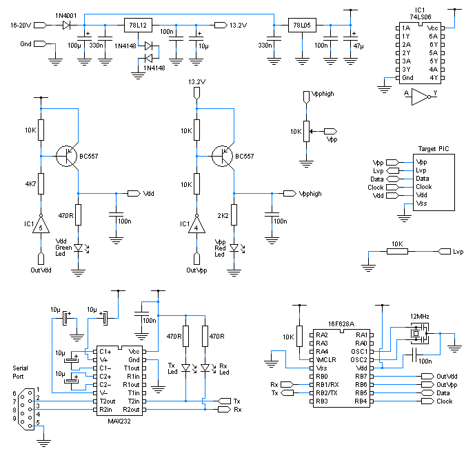

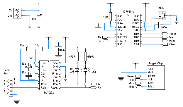

Hello,
I'm planning to build this Oshonsoft Serial Port PIC-PIC18-PIC16-AVR Programmer, to program both PIC and AVR microcontrollers, but changing the PIC16F628A by the PIC16F73 ( I only need 1 USART and 8 pins for the Programming Serial Signals)
Has someone built it before ? ? Any experiences ?
SCHEMATIC FOR PIC
SCHEMATIC FOR AVR
This is a 'blast from the past', and such old programmers don't support modern devices.
If you want to program PIC's, then get a PICKit2 or PICKit3, and this works directly from within the MPLAB(X) IDE - the 3 is better for more modern devices.

As I mentioned above, the PICKit 3 supports far more modern PIC's than the 2, but both are excellent programmers.
The PICKit 2 does support Enhanced processors, but only from it's own software, not from within MPLAB(X).
I have a Pickit 3 "Clone", but i want to programm AVR microcontroller too with the same software and hardware !
Why would you want to do that?, and in any case there are two different hardware designs above for the two different manufacturers.
