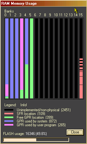

My project uses a 18F4520 , 20mHz xtal.
There is adequate free RAM, ref image

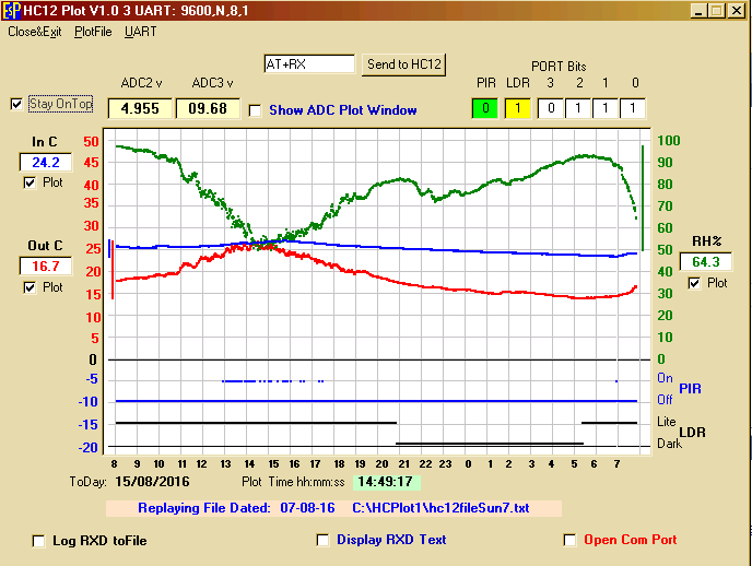

Sample of SD record:
hc12file.txt 07-08-16
A,+18.0,97.5,4.955,09.64,010111,+25.7,08:05:35
A,+18.0,97.6,4.960,09.64,010111,+26.0,08:06:38
A,+18.0,97.5,4.960,09.64,010111,+26.0,08:07:40
A,+18.1,97.5,4.960,09.64,010111,+25.7,08:08:43
A,+18.1,97.3,4.960,09.64,010111,+25.7,08:09:46
A,+18.1,97.3,4.960,09.64,010111,+25.7,08:10:48
A,+18.1,97.4,4.960,09.64,010111,+25.7,08:11:51
A,+18.1,97.3,4.960,09.64,010111,+25.7,08:12:54
A,+18.1,97.3,4.960,09.64,010111,+25.7,08:13:56
A,+18.1,97.3,4.960,09.64,010111,+25.7,08:14:59
A,+18.1,97.6,4.960,09.64,010111,+25.7,08:16:02
A,+18.1,97.5,4.960,09.64,010111,+25.7,08:17:04
A,+18.2,97.3,4.960,09.64,010111,+25.7,08:18:07
A,+18.2,97.3,4.960,09.64,010111,+25.7,08:19:10
A,+18.2,97.0,4.960,09.64,010111,+25.7,08:20:12
A,+18.2,97.1,4.960,09.64,010111,+25.7,08:21:15
A,+18.3,97.3,4.960,09.64,010111,+25.7,08:22:18
A,+18.3,97.1,4.960,09.64,010111,+25.7,08:23:20
A,+18.3,96.9,4.960,09.64,010111,+25.7,08:24:23
A,+18.3,97.1,4.960,09.64,010111,+25.7,08:25:26

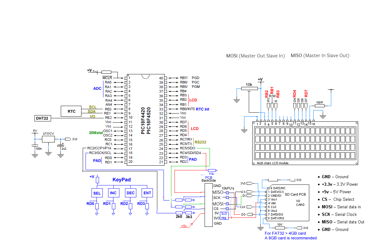

hi C,
This is my rough drawing of the 18F4520 circuit for that program, it may help.
I use a RS232 to USB converter for RS232 TXD/RXD data
Pins PORTB,5,6,7 and /MCLR are connected to my in circuit programmer.
E
Hi E,
Thanks for the drawing.
Can you post programs showing, Filename building in a subroutine , FileExists, Directory, not working please?
C.
