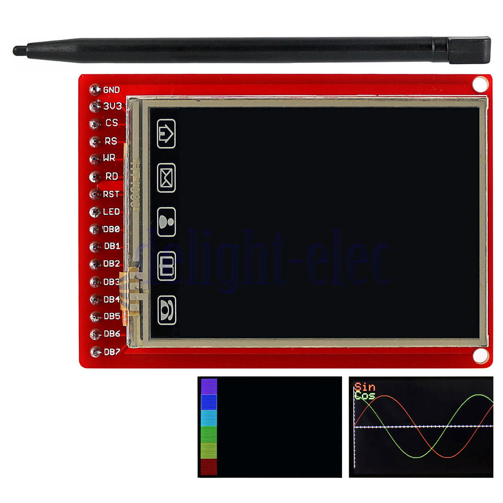

I have one of these, which is touchscreen complete with stylus, but there must be many variations. https://www.dx.com/p/open-smart-2-2...ard-module-with-touch-pen-467508#.We8AHsX-0uU

Is the picture you've posted the actual one you have?, because that looks to be a parallel fed display, which needs a LOT of I/O pins. It's likely that the touch screen is SPI though.
You also need to mention what chip it uses, there are numerous different (and incompatible) types.
You also need to be aware that they are pretty 'memory hungry', so I tend to use them with 24F devices, although there are some 18F series with impressive amounts of memory which should be fine.
As in all of these types of projects, almost all examples out there are for Arduino and written in C++ - although they usually work with anything which can be programmed via the Arduino IDE, I've got an ESP8266 happily running a 320x240 colour display, and a lot faster than an Arduino. I've spent a lot of time converting such code to run in C under XC16 on PIC's, you might have to do something similar and convert to BASIC?.

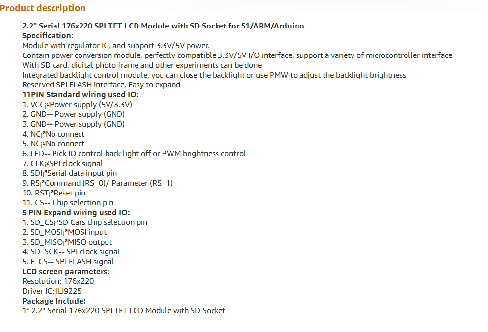

Hi N,
I've updated #1 with a LINK.
I noticed a difference! Driver IC: S601121.
Regarding 'memory appetite' it states that most of the work is done by the module?

hi C,
It is this type.
E
Thanks for that Eric, I've ordered a couple to play with :D
I was a little confused by the pin connections?, but a little googling explained that it's designed to plug directly into an Arduino, but only using software SPI - using the faster hardware SPI requires wired connection.
I was particularly impressed with the fact that it has 5V to 3.3V data conversion, and all at a very low price.
