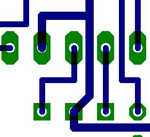

I built a small board with a PIC and the resonator will not oscillate. After cleaning the board, resistance from the oscilator pins to all nearby traces is infinite.
I programed the PIC and tested it on a breadboard with the oscillator prior to installation. The same setup works if I bypass the board and solder the resonator to the PIC pins.
Can nearby traces add enough capacitance to cause the resonator to not work ?

The square pads in the image are the resonator. Resonator lines are .016 with a .024 ground between them.

One question would be; is the resonator one with the built in caps? Some need external caps and the breadboard may have just provided enough stray capacitance for it to work.
What is the part number/manufacturer of the resonator?
Which PIC are you using it with? What is your PICs _CONFIG setup?
You might also double (or triple) check the rest of the connections, it's suprisingly easy to do some thing silly like not connect MCLR (been there, done that!).

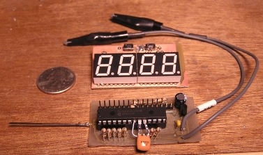

No Joy.
The processor and resonator were tested on a breadboard prior to installation on the PC. That rules out the config values.
As you can see in the attached image I tried bypassing the PCB resonator by soldering one to the PIC pins. With this the circuit worked.
The osc/resonator traces are not shorted. The connection from socket to resonator is good.

Hmm, just an idea, have to doubled up the traces between the PIC and the resonator with wires? preferably as short as possible. I've had no end of trouble with a stripboard layout, where the osc traces are almost identical to yours and I still haven't found a way to make the b*stard oscillate - although, I am using a xtal instead. It seems I only get this trouble when I have a GND connection inbetween the two osc pins...god knows why that would interupt its working, if anything it *should* make it more stable.
There are two important electrical differences between a resonator and a crystal. The impedance of the resonator is lower than that of the crystal and that its frequency response is wider. While a crystal’s ESR may be 20 to 1000 ohms, a typical resonator will be in the range of 20 to 150 ohms. The frequency of a typical resonator is less accurate than that of a typical crystal. At start-up, the resonator’s lower impedance develops a lower voltage across it over a wider frequency range, which can make it more difficult for the oscillator to ’find’ the fundamental frequency and start oscillation. Getting a noise signal fed back to the input from the output becomes more important.
Since the “Q” of ceramic resonators is generally lower than quartz, they are more easily pulled off frequency by variations in circuit or parasitic reactances. This is desirable if a circuit is designed with a variable element, as greater tuning range is realized. It is not desirable if the highest possible stability is the design goal, because the resonator will be more susceptible to variation in parasitic reactances, such as capacitors formed by circuit board etch, and temperature variations of intended circuit reactances. These variances will add to the already substantial deviation over temperature of the resonator itself.

3v0, could post a larger pic of your layout, so we can see what traces are near the osc pins? Although many insist 'stripboard is fine' is isn't the most reliable for oscillators, are you using SRBP? This issue is bugging me something chronic, lets hope we can sort it out.

Yes maybe in a few hours.
I am using a board designed with EagleCad and etched/drilled.

I have removed and replaced (with new) the processor socket. I have removed and replaced the osc. I have checked all power, gnds, and osc pins at the pic socket with ohm meter.

To measure the oscillator, it should be tested with an oscilloscope connected to OSC2 (Remember that a scope probe adds its own capacitance to the circuit, so this may have to be accounted for in your design).
If you probe osc1 it will stop the osc even with a 10x probe. So you probe osc2. Got that.
It can not be the config value because the chip works on the breadboard.
I have checked the solder joints with an Ohm meter many time. Old hat.
Lets put this on hold for a bit. I will try to post a up close and personal image of the underside of the board this afternoon (US central).
