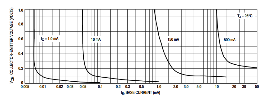

"Pin 11 will show about 2.5v - 2.8v"
With 0.7V for Vbe , the 1K resistor current to base drive would be 1.8 to 2.1mA.
I would have designed it for 10% Ic or 3mA for improved saturation and increased relay current and reduced contact bounce for extended life. ( for a 12V coil perhaps you can get away with 50:1 ratios on Ic:Ib )
If you assumed Vce was 1V and Relay is guaranteed to switch at 4V min., one must keep in mind the force and acceleration of contacts is also reduced 20% so the risk of contact chatter is far greater with layout immunity issues.
That is an invalid assumption. Both circuits will have a 100 milivolts or so at the collector, giving 4.9V across the relay coil. The relay coil is voltage driven not current driven. It make very little difference how much current you pump into the base of the transistor after collector voltage saturation.
May I suggest that you build the circuit and measure the collector voltage for yourself. You can use a resistor in place of the relay coil for the exercise. It should only take a few minutes.

hFE is the linear gain rated from 35 to 800. Designing for worst case is best practice and using 10:1 ratio ensures this . Motorola called this the "beta overdrive" factor for reliable switching.
50:1 may be OK for diode OR for 99% of all devices, but not OK for 74ACxx running at 5V, due to EMI issues and lack of saturation margin.
In a noisy environment without shielding and excessive Vcc for 74AC devices makes it more sensitive to generating and receiving noise. excessive high dv/dt and high gain during input switching with possible shoot-thru conduction spikes from output stage, internal to the chip operating above absolute maximum of device rated for 3.6V with abs. max of 4.6V, running at 5V.
When we want a reliable design , I use 6 sigma methods which means using worse case. Your Graph indicates the variation for a "nominal device" with an hFE of 200 @10mA
I believe the worst case for 10mA is an hFE=75 @25'C
The problem initially stated is not satisfied by a passive load test with a nominal device, rather with actual design issues and transients overlooked details in layout, excessive Vcc, lack of filtering and shielding, which was what I attempted to describe.
