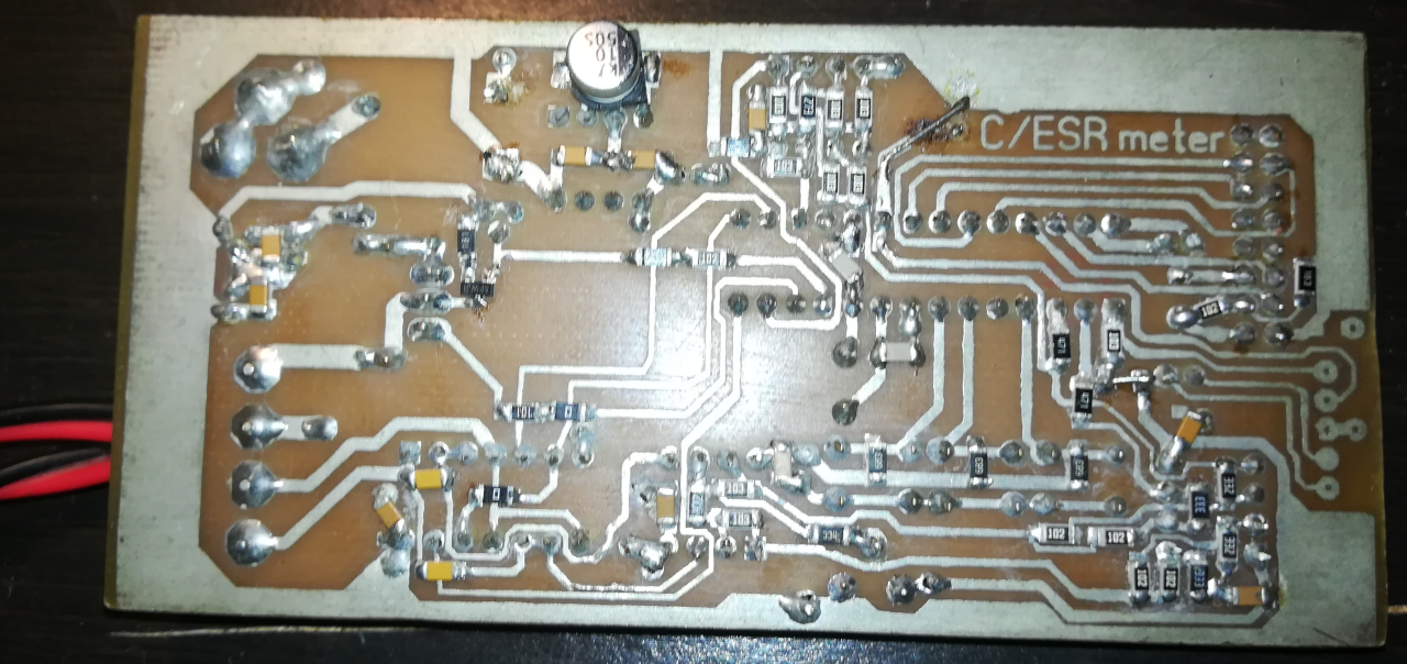

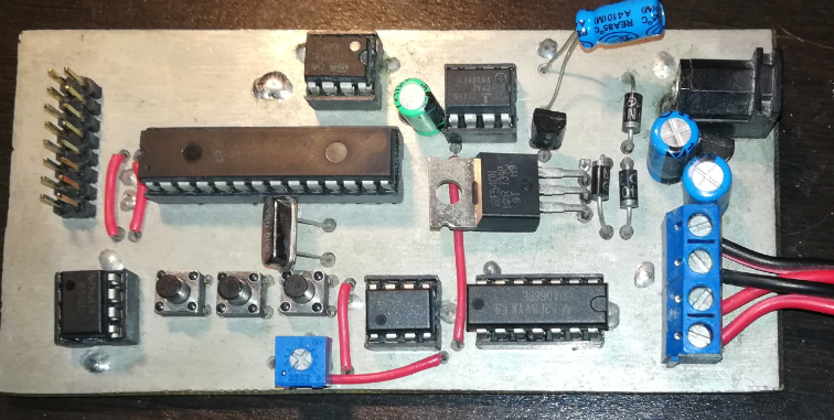

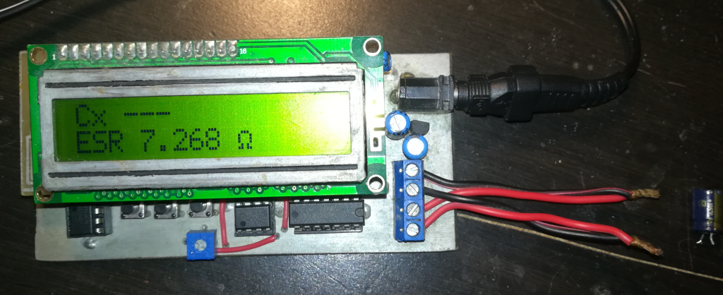

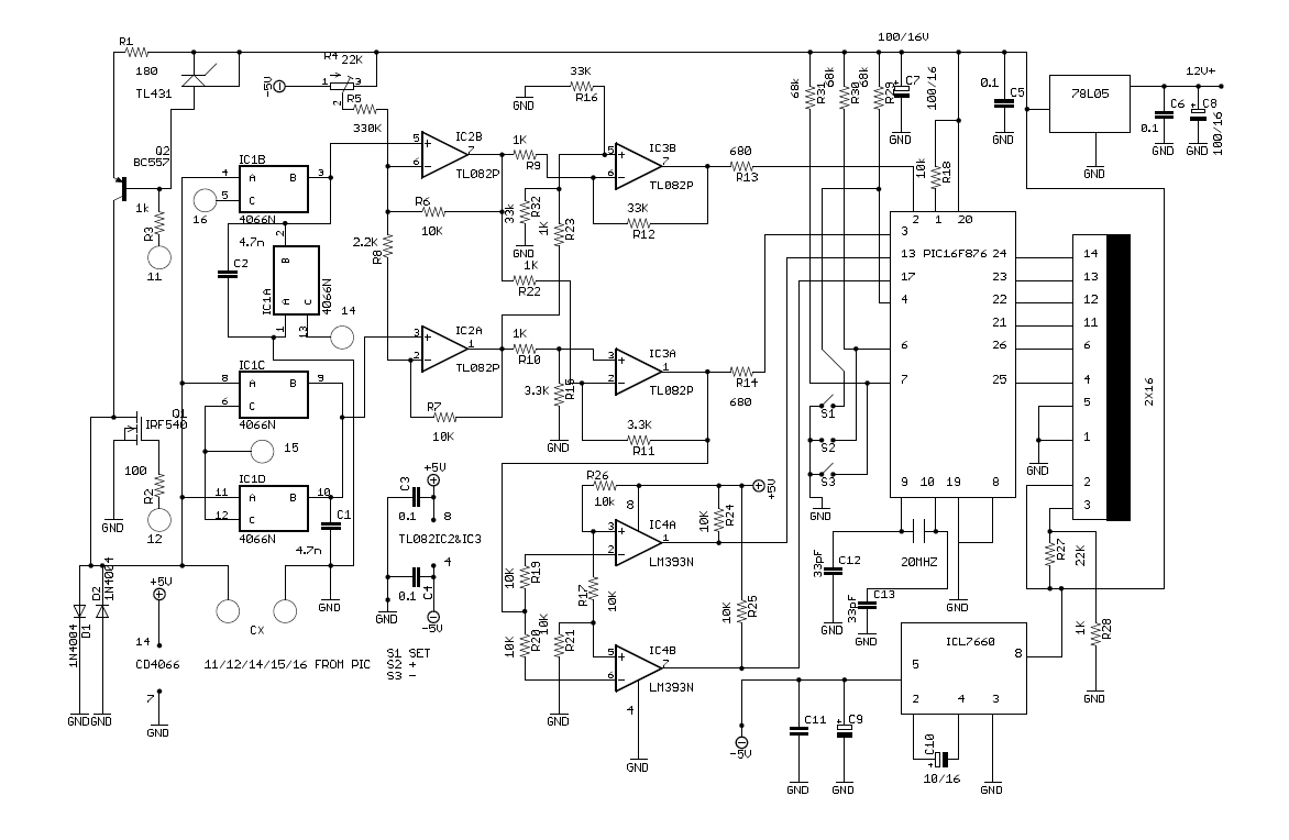

In the attached pictures you can see the schematic and the pcb for an esr meter i've built few years ago
this thing....never worked as it should, it seems functional but the capacitance measurement always
shows CX ----
i tried alot to troubleshoot it....measured every component for broken joints changed most of the ICs
in case of a faulty one but still it can't perform any measurement.
i've spent alot of time and effort to build this device also the component cost wasn't exactly negligible
so now it ended up one step before i salvage it and throw it to the garbage can. :/
would you like to help me save it?

I see a lot of potential solder-bridges, and the board is a bizarre layout.
Did you check with a scope to see if the timer section is working?
checked once again for broken joints or bridges and seems fine.
currently i dont have a scope, only a frequency meter @10MHz is available
can you point where i should measure and what? thank you.

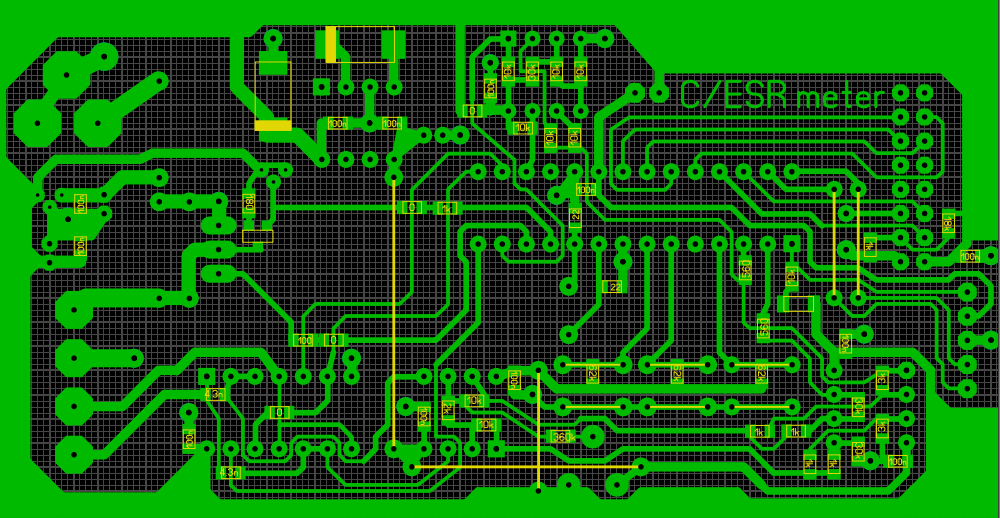

A PCB layout that simultaneously uses SMT components, no solder mask, and is intended for assembly by hobbyists, is a recipe for disaster.
I would check for solder bridges at every SMT component using a microscope. Usually, microscopic solder whiskers or remaining flux can cause enough leakage to cause circuit problems.

i'm uploading the pcb layout.

rethinking what you told me, i don't understand why you find a scope so mandatory!
the waveform should be a square wave or something similar to that, what is
important it's if there is any oscillation...(since from what i know) these instruments
pass an ~100KHz to the capacitor under test, am i wrong on that?
the PIC microcontroller starts so i guess i don't need to measure if there's a 20MHz oscillation.
the ~100KHz test frequency should come out from the op-amp..right? if yes, where do i take
that measurement??
