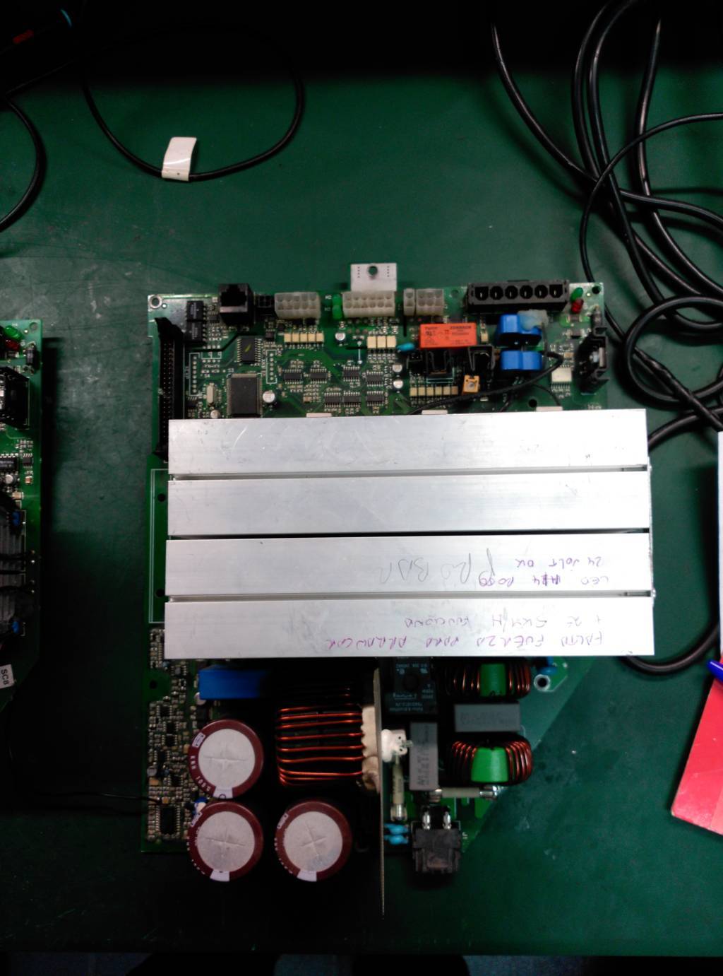

In this case the reason is because a repair of some boards, I see problems at PFC circuit in some professional Fitness treadmill controllers and each one has 5 LM358 and some more components. Due to this I was thinking about making a tester just to know more about the failure because I know I can receive more of these units to be repaired.

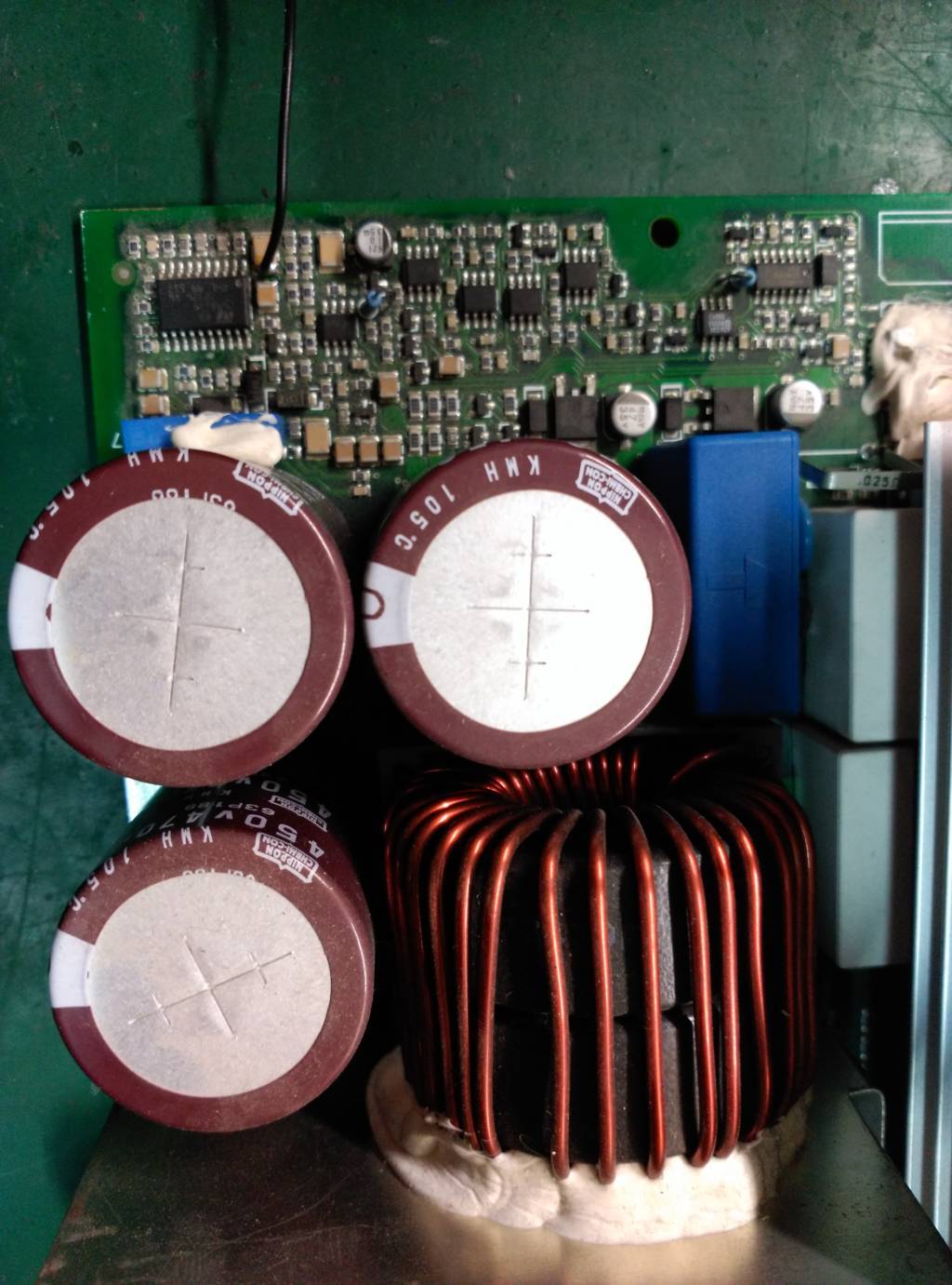

This is how I found problems at the PFC circuit where I have a L4981AD controller. I supplied 15Vdc without Vac input (only voltage at PFC circuit) and I saw differences in consumption, a good one had 50mA and bad ones had 80mA, 200mA and 400mA. Touching components they were getting hot. IC´s involved are AD633, L4981, LM358 x 5 and HCF40106. Rest of components I can test with multimeter.
I attach some pictures. The board and the PFC circuit.
