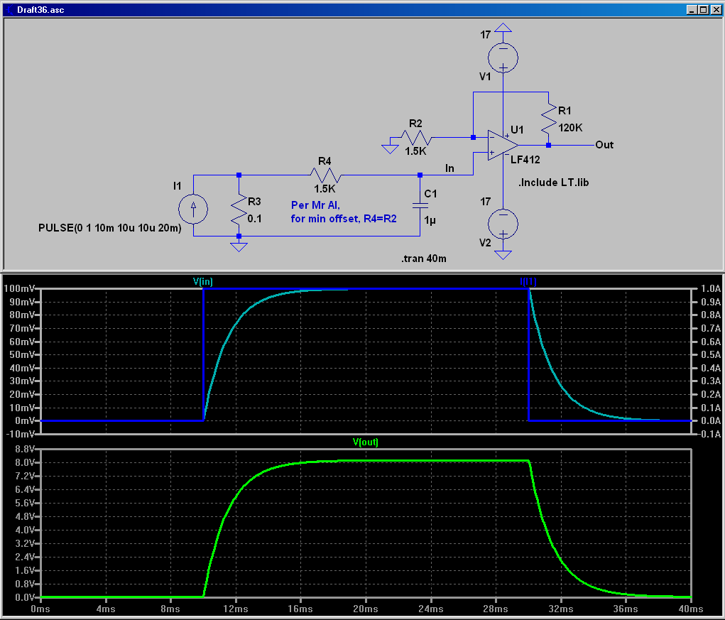

C1 should be quite a bit larger, even 100uF. I make the gain 81...
Yes, try the LM358 and see if you can get that to work first. That will help eliminate the LF412 as the problem, or show us that it is in fact the problem. There's no reason why the LM358 shouldnt work here too unless something more basic like some connection is not right.

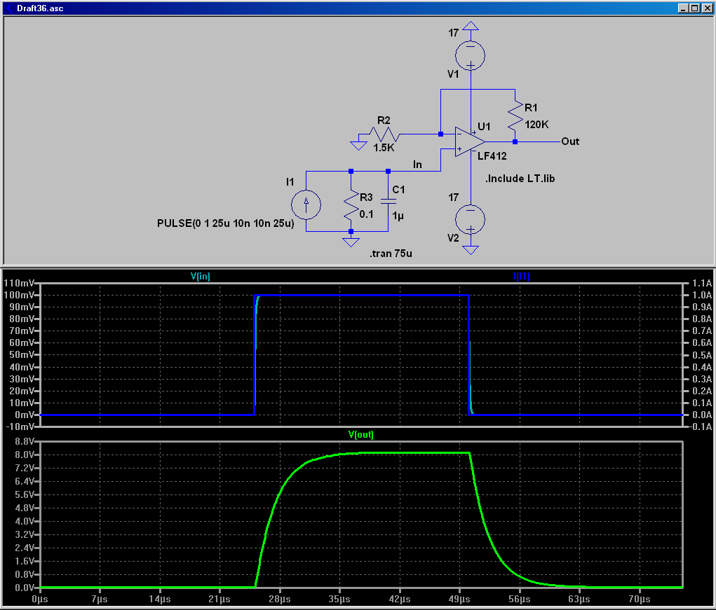

The way filtering is usually handled in current measuring circuits is a little resistance is inserted between the sense resistor (the very low value one) and the filter capacitor. The idea is to make the time constant as large as possible without interfering with normal operation.
So.. MikeMl, you suggest that C1 must be larger. Is there any reason why there is such a huge difference in the gain???
MrAl, I'll try a LM358 and also what MikeMl suggested. With the large time constant you are talking about, would that introduce some delay?
I should have said that the gain is 81V/A. 1A across 0.1Ω is 100mV. 100mV * (1 + 120K/1.5K) = 8.1V

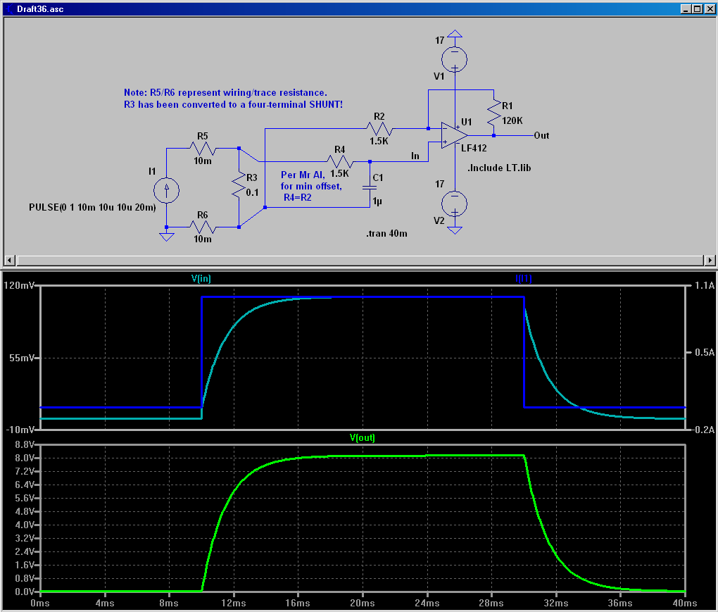

Improved version, incorporating better filtering, and min offset.
uhmm... it is a precision current sense resistor (LVR01R1000FE12). I've measured it and it is 0.1Ω

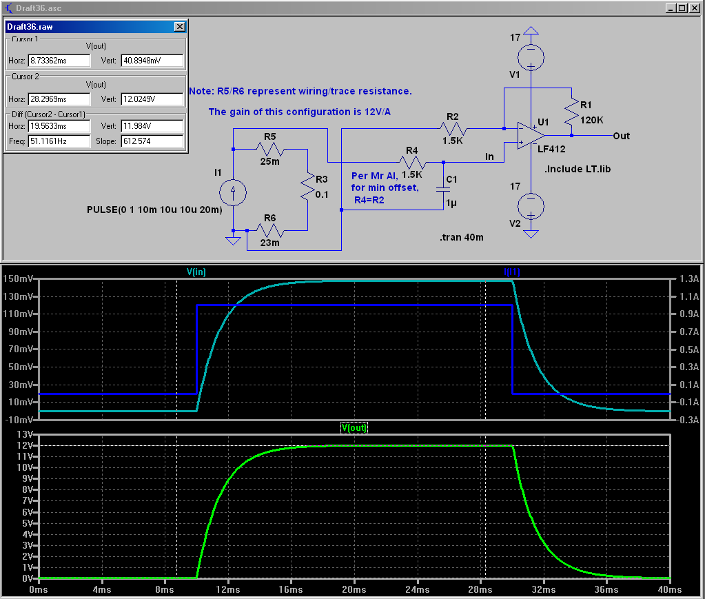

You many be seeing parasitic ground or trace resistance. For accurate current measurement the plus op amp input and the ground point for Rn must be connected directly to Rsense, not at a trace near Rsense. Is that the case?
I think crutschow hit it on the head. Look at the following:
