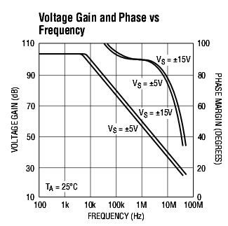

1) The module you picked has gain inside. I don't think you need a gain of 5oox more.
2) "Gain band width" Here is a graph of a 1ghz op-amp.
It works to 1ghz with a gain of 1.
It works to 100mz with a gain of 10.
It works to 10mhz with a gain of 100.
I don't think there is a single amp that will give you a gain of 500x at 300mhz.
You can use several stages of gain to get to 500x.
Probably you want "differential" to "single ended" and a gain of 1 or 2 or many be 10 at most.
10x at 300mhz = 3gh
z amp minimum.

I think I gave you the wrong number as +/-200mV, I did some calculations today for a real-world situation and the max we can get is about +/-12mV output signal from the module.
Here is what I am planning on doing, using the differential output from the module, convert into SE signal while doing about Gain of 2 to 5 within this stage and then use multiple stages of op-amps to amplify the signal to 1V max. For amplifying SE signal, I am thinking of using two MAX4305 followed by a MAX4105 and MAX4101 (as buffer) all in series.
