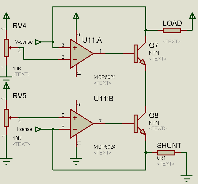

I was never good with analog stuff so if mine idea is wrong from the beginning feel free to let me know :D but if it can be modified to work, I'd really appreciate the help.
The idea follows ...
RV5 is simulating the output from a DAC that sets the limit for the current of the PSU
RV4 is simulating the output from a DAC that sets the limit of the output voltage of the PSU
U11 is a rail2rail op-amp and part B on the inverted input gets the I-Sense (from the shunt resistor on the PSU output) and part A gets the V-sense (from the voltage divider from the output of the PSU - the voltage comes)
What I want to achieve is to set limit for current and voltage using 2 dac's (in this case RV4 and RV5) and drive the NPN that will control the output. In the attached image load is driven directly with two npn-s but for the final design I want this 2 to drive bunch of MJ802 or similar in parallel .. for the NPN drivers I'd use some npn's with 4A, beta=750 (BD681 as I have bunch of those) but for starters this thing should work (up to 4A) with only this two transistors.
Can someone tweak up this part of the schematic so that it works :D .. I'd like to keep mcp602x as op-amp and this BD681 as a driver ... I want to drive the negative rail and not positive rail on the output ...
Any ideas?

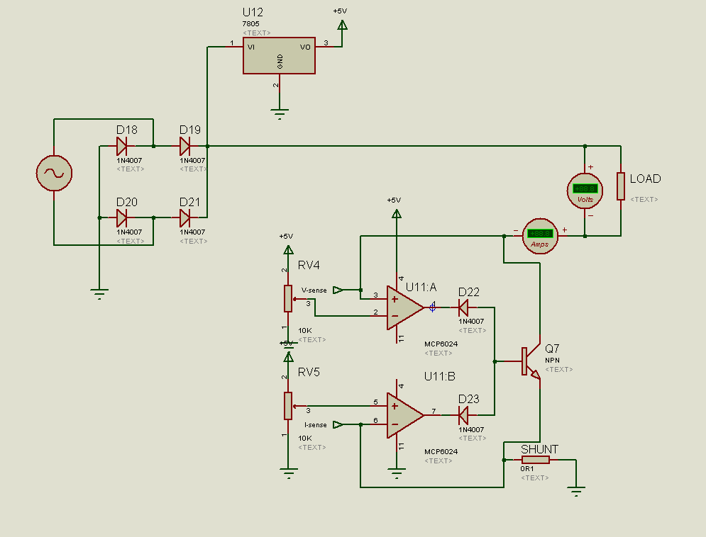

maybe something like this would be a better choice ... but I fear I have chosen a wrong op-amp and that these mcp's will not do it ..
btw I want to control the "lower side" and not the "top side" of the potential because this way the "body" of the transistor can go directly to heatsink without need to add an insulator between transistor and heat sink (as heat sink is exposed)
Seems like it should work. Positive rail regulators always play with your mind. Have you simulated it?
You do of course need some filter caps.
Arhi, on you last circuit, how does the NPN transistor get its base current?
Where is the filter capacitor?
I hope it will .. have not simulated it yet .. I think I might have to find some other op-amps ... will have to do some testing locally to see how much will I be able to open BD681 with mcp602x (simulation will never show real data there as everything is "ideal" - not to mention proteus don't have model for BD681) as I fear I'll have to use some high voltage op-amp (LT1013 or LT1014 comes to mind) ...
anyhow I think the major problem I had that I tried to solve with 2 transistors will be solved with this 2 diodes and 1 transistor ..
I've used two op-amps for current and voltage limit on a power supply, using the two diodes, like your circuit in post #5. You need a pull-up resistor to provide the base current, and then either of the op-amps can pull the base low.
damn i missed that :D ... there should be 1K res between B and C of that transistor
this is just a "block" schematic .. the full schematic has bunch of capacitors right after gretz, bunch of them parallel to the load .. there's a mcu, dac, pga, display ... all not really relevant to this part that I don't know how to make :)
edit, also the AC source is 6, 18, 24, 32VAC and there's bunch of relays to change what AC source is in use so I can reduce heat dissipation (not to make 2V output out of 40VDC by heating my house :D )
Thanks .. I forgot the res between B and C there .. I just need to figure out the size of it ... BE voltage on this bd681 is 2.5V iirc (not standard 0.7, probably because it's few transistors inside single pack and not only one .. that's why it's beta is 750+) ... and I need to figure out the op-amps .. can I use this mcp's or in this case I need to use op that will be powered from + rail
Even the LT1013 won't quite do it with the 38volt (RMS?) input voltage. I think it is 44 volts maximum. It also has to sink your base current, but we don't know what your output current needs to be yet. You may need one more transistor to power things up.

ronv, the lt1013 was the first one that came to mind, yes one that can take 45V is needed ... as for the current it is un-important as after this bd there's most probably another one and then 10 high power transistors to give out needed current .. but that part is "simple", I'm attm trying to solve the driving part
