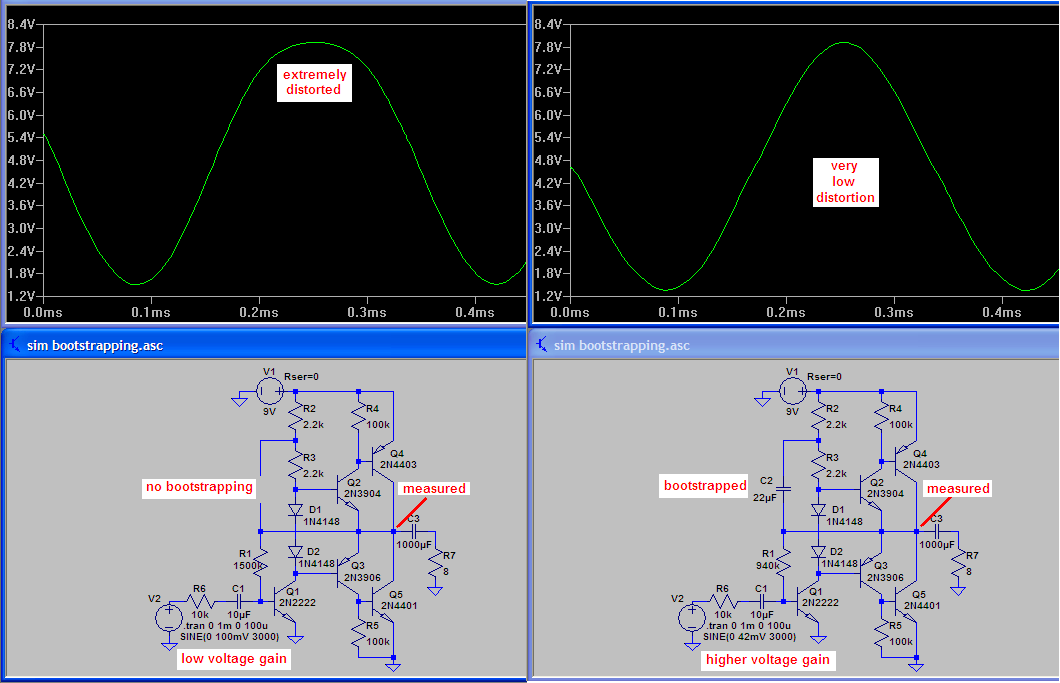

I have made many amplifiers with transistors. The simple one with only 3 transistors sounds very distorted. I made some amplifiers almost the same but with two extra transistors so that the outputs are Sziklai pairs and the distortion is much lower. I simulated it (I should have added emitter resistors):

Q1 has lots of negative feedback from the output instead of from an emitter resistor so its operating point doesn't change much with beta changes.
Here is my sim file:

The circuit is designed for a Q1 beta of about 200. If the beta is maximum (300) then it operates at a center of 3.5V. If it's at minimum (50) then the center is about 6V. For a headphone amp this is probably OK.

I noticed the 2N4403/2N4401 have higher absolute max collector currents. Is that why they were placed on the output instead of 2N3904 and 2N3906?
Also since the bootstrapping stage is a class C amp, will the input be allowed to dip below 0V?
The peak voltage across the 8 ohm load resistor is 3.3V so the peak current is 413mA which is too much for 2N3904 and 2N3906 transistors.
Class-C amplifiers are not used for audio. Too much distortion.

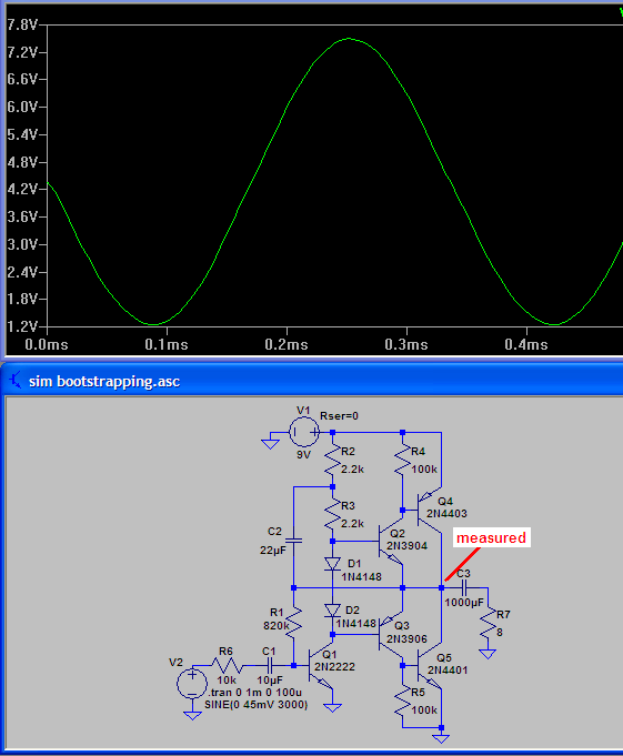

The bootstrapping dynamically increases the supply voltage for the resistor that feeds base current to the NPN output transistor so its distortion is much less.
The voltage gain is more than without boostrapping and if the gain is reduced then the distortion will be even less.
Did the value of that bootstrapping capacitor have to calculated or is there a rules-of-thumb? It seems like you'd have to take an RC time constant into consideration.
