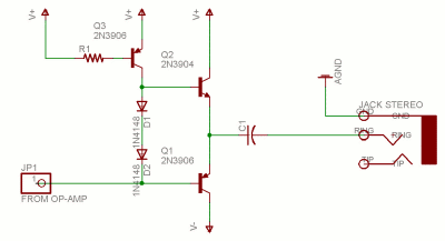

Here's one of the circuits I'm looking at putting on the op-amps output. I wanted to go with a B amplifier. The reference said the diodes will lower crossover distortion if I put enough of a bias current through them through Q3. Does it seem to a reasonable approach?
No, it looks completely lacking in anything resembling a working amplifier! :(
There are loads of small opamp designs with additional transistors out there on the net, I suggest you try looking at some.
The transistor circuit will be very distorted without any negative feedback and without boostrapping.
Your first transistor is turned off so the circuit doesn't do anything. If the signal is fed to the input of first transistor, it is biased and it has a collector load resistor then you have a very poor quality amplifier.

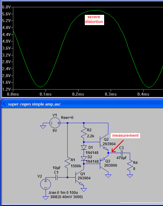

Here is the simulation of a similar circuit except I used an NPN first transistor instead of a PNP. Both would have severe distortion. But it has a high voltage gain.
It might make a good fuzz circuit for a geetar. It would sustain almost all day.
