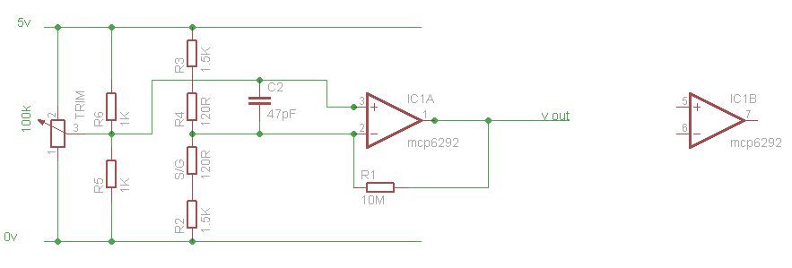

Looking at your dwg, which MCP are you using.??? the pin outs on your dwg are a mixture of single & dual.???

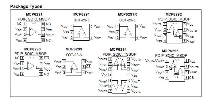

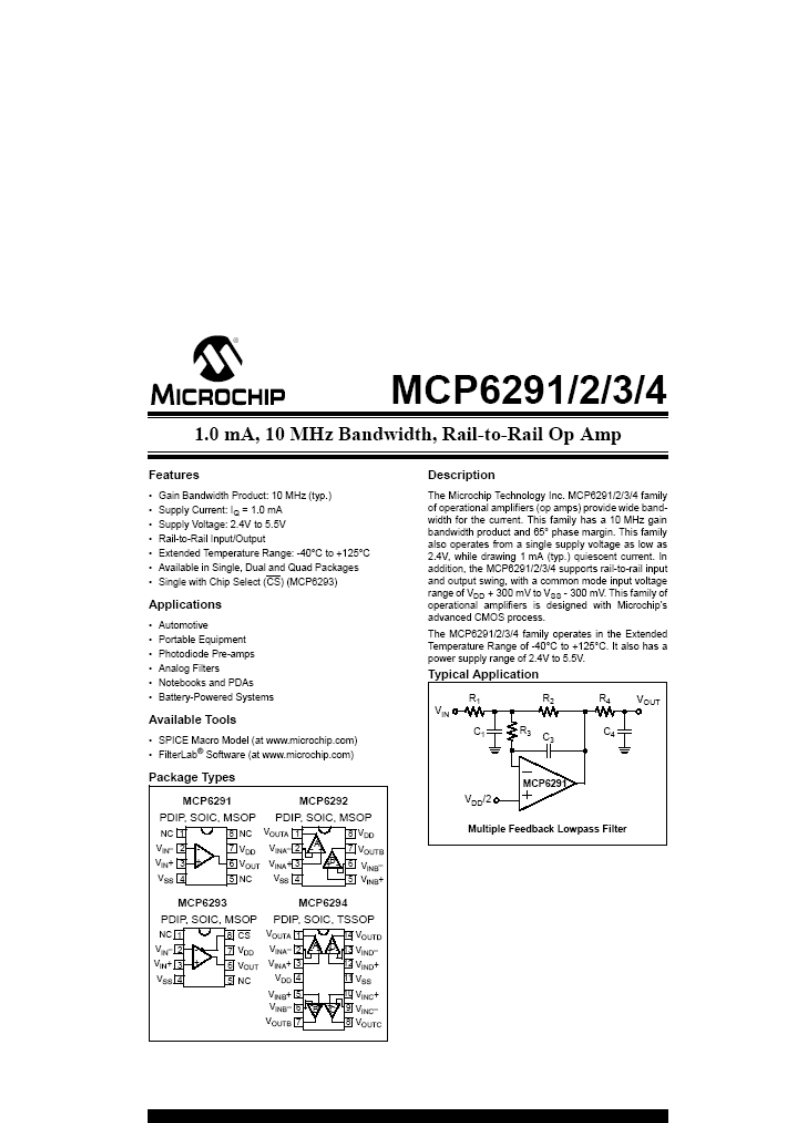

Hi Eric
The OPA i am using is the mcp 6292 dual sorry for the confusion as the pin out in the drawing is a 741 this is all i could find in eagle.See page one from data sheet attached.

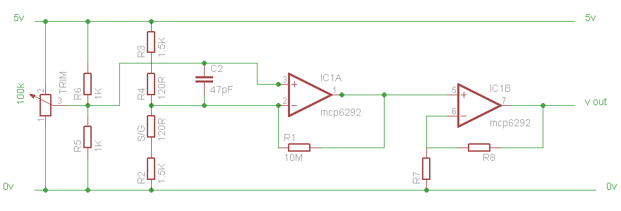

Hi
Have found correct pinout in eagle not correct device but same pinout. If IC1A is configured as a differential amp? what would IC2B be configured as a non inverting amp?.Have attached updated working schematic and also how i think the second amp should be configured not sure about values for R1,R7,R8 and by how much to reduce gain of IC1A etc.Thanks

hi bee,
Looked at the new dwgs, the 2nd dwg with the NI OPA would be OK.
As you say, the gain of the 1st stage should be reduced, I would set the gain no more than about 100 [or 200 tops] and the 2nd stage to about 100.
Make the 2nd stage gain adjustable to give SPAN control.
This would give an overall gain of about 10,000/20,000.
Do you want me to help with the resistor calculations.?
I see in your dwg.4 that only one SG is used in the bridge.??

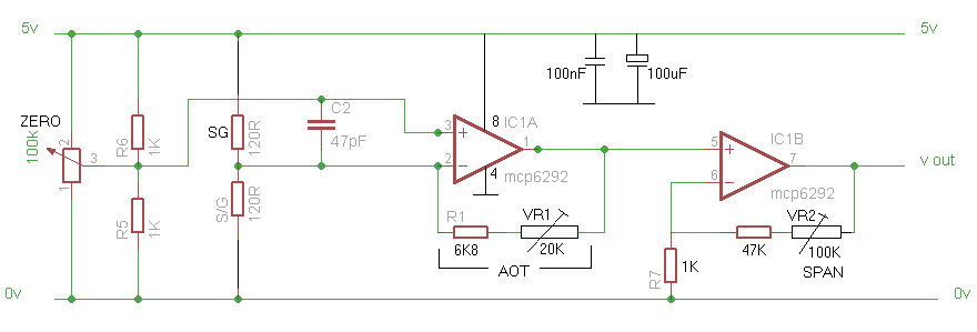

EDIT:
Added dwg.

Hi Eric
Still using only one s/g as i got it working reasonably well with one.I still have the 1.5k resistors on the bridge arm with s/g to reduce current is that ok as it seems to still work ok.The caps 100nF/100uF are to stablise supply correct.If you could help with res values would be good, are the values on the drg approximate.Forgive my ignorance but what is AOT on the feedback loop IC1A

AOT or SOT are 'accept on test' and 'select on test'.
All it means if you want to reduce the cost of using the VR1 pot, once you have the required gain from the 1st stage, you could replace the 6K8 and VR1 with one fixed value resistor. [measure VR1 ohms value when done].
The caps are essential, if possible add another 100nF across pins 8 and 4 of the OPA.
You are working with very low signal levels and high gains, so you must try to minimise noise.

Hi Eric
I have altered the circuit to use both amps and it looks good.Still testing the other circuit
with single amp and it is working good also. So will have to make a decision if one amp is good two must be better.Thanks for your help again
