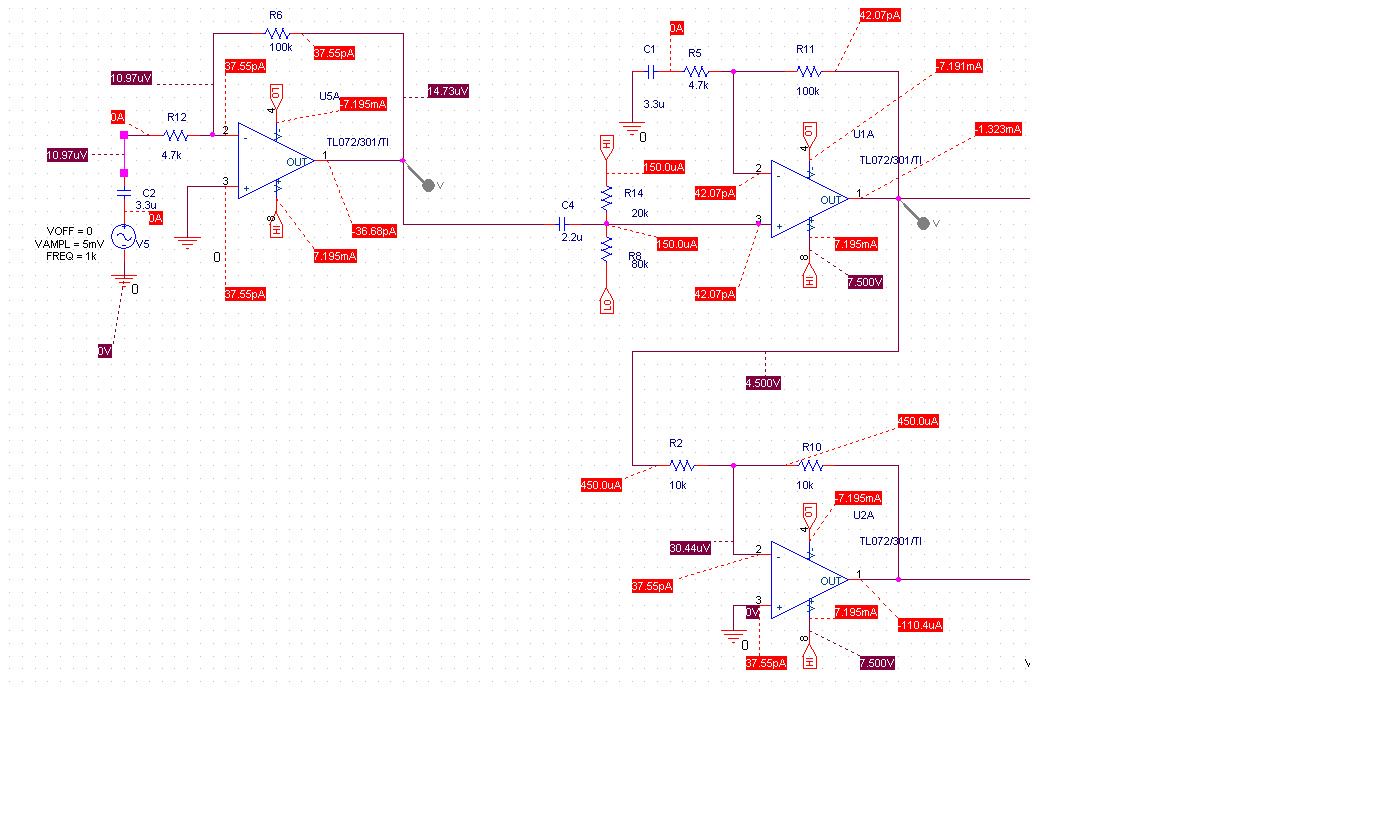

Ok audioguru,
I modified the circuit as you can see at the below pic,
Please are you able to help me to select the values of R12, R6, C1, R5 and R11 so that I could get the best performance at 20kHz of bandwidth by a gain of say 500 to 800 please?
As you can see I am using TL072 for the task.
By thr way I am not sure the values of C2 and C4 are good enough or not? And yes Of course I use a dual power supply for this circuit.
P.S Finally I could convert the circuit so that It produces an output which is 180 degrees out of the phase to the other output by a scheme I took from this site:

I added it so that you take a look at it to and make an evaluation regarding the whole circuit (any trim?)
Thanks a bunch

Your circuit does not show a voltage for the negative supply.
Why do you add an offset voltage to the outputs with R14 and R8?
Why do you need the inverted output?
You have already selected 1uf as the input capacitor value for C2 so simply calculate the value of the input resistor R12 so that you have good bass response.
Since the values of R14 and R8 are so low then the bass respose created by them and C4 causes a -3db frequency of 100Hz and deep bass sounds will not be produced.
Don't you know the extremely simple formula for the gain of each opamp?
It just uses +- 7.5V, So the "LO" comes from -7.5V, and the "HI" comes from +7.5V.
That's because I need to have them for the next stage.

That's because I need to have (the offset voltages) for the next stage.
Then the opamps will clip the signal when it is high level. Why?
As you know my knowledge in electronics is limited. How to solve the problem? Can I use two larger resistors for R8 & R14 yet have the 1/4 ratio?
Of course. The datasheet for the TL072 shows that its input current is almost zero so resistor values very high can be used (20k and 80k) then smaller, better and cheaper capacitors can be used for coupling the signal. But nobody makes an 8k or 80k resistor. Maybe you can use 82k.

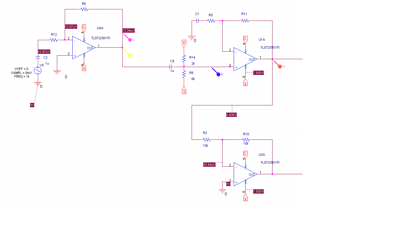

OK here's the values I selected for the circuit.
Please check it up and let me know if the values are good selected??!

Since you need 3 opamps then a TL074 quad opamp can be used instead of one TL072 dual plus one TL071 single.
The gain is 505 times.
The input capacitor C2 and input resistor R12 cause the gain to be -3dB at 10.3Hz.
Capacitor C4, R14 and R8 cause the gain to be an additional -3dB at 4.5Hz and takes a long time to charge.
Capacitor C1 and R5 cause the gain to be an additional -3dB at 10.3Hz.
Capacitors C2 and C1 should be non-polarized which are huge and expensive if they are film types. If the resistor values were 10 times higher (1M and 47k) then ordinary small and inexpensive 330nF (0.33uF) film capacitors can be used.
R14 and R8 cause an output offset voltage of 3.0V. So the outputs will have a max voltage swing of only 3.3V and will clip the signal if the input is only 4.6mV RMS or more.
But I guess the gain is 474?!
The first opamp has an inverting gain of 100k/4.7k= 21.3 times.
The second opamp has a non-inverting gain of (100k/4.7k) + 1= almost 22.3 times.
The third opamp has a gain of 100k/100k= 1.
The total gain is 474. I don't know why I said 505.
The difference in gain between 474 and 505 is so small that you won't hear any difference.

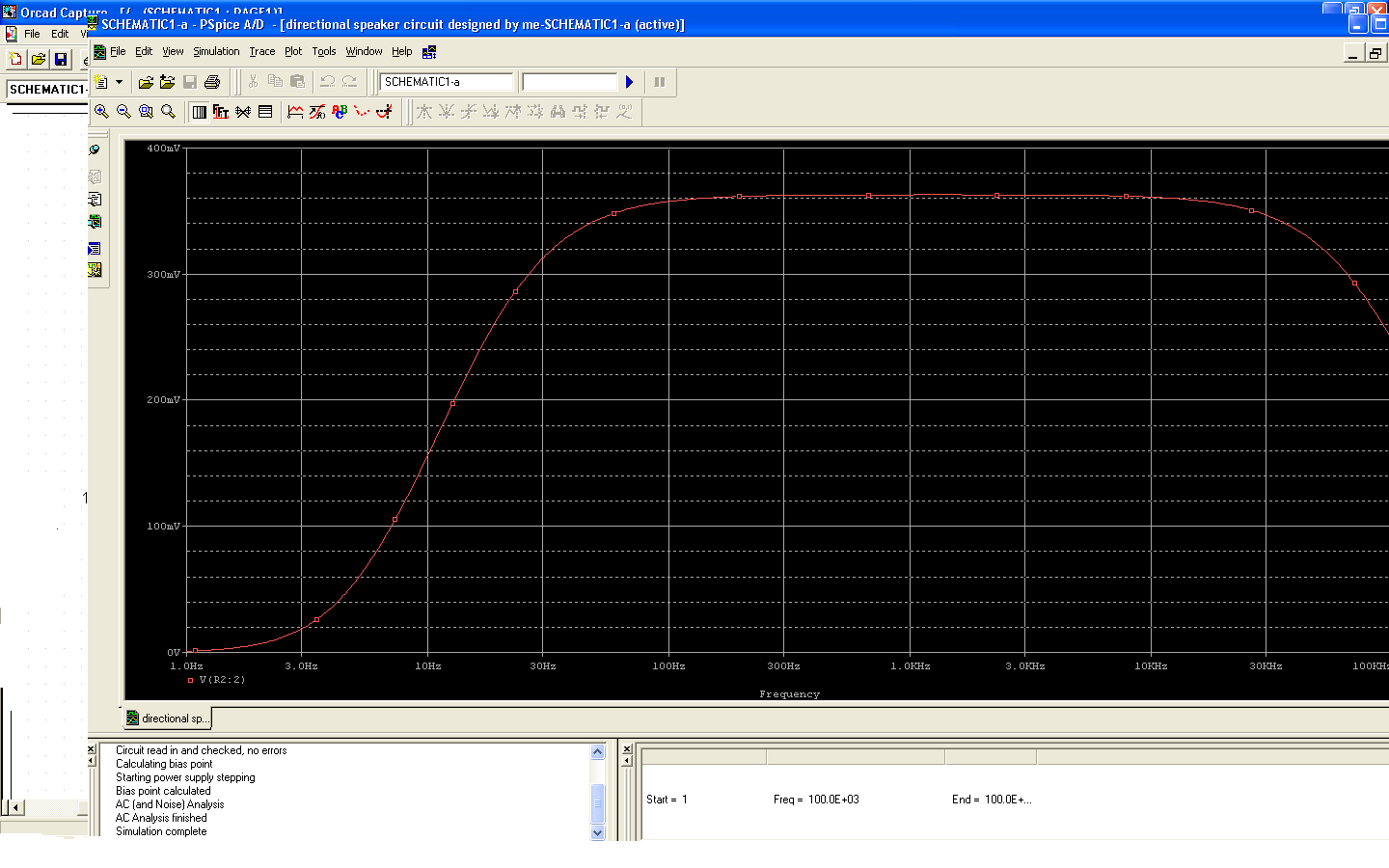

The cutoff frequencies of the three capacitor add together which reduces the bass response.
Are you telling that I will have almost -9dB at the lower thereshot (i.e 20Hz)? If so, it would not be so good, right?!
No deep bass.
No deep bass.
So don't you suggest to incrase the values of the caps so that I could get the lower roll off freq?

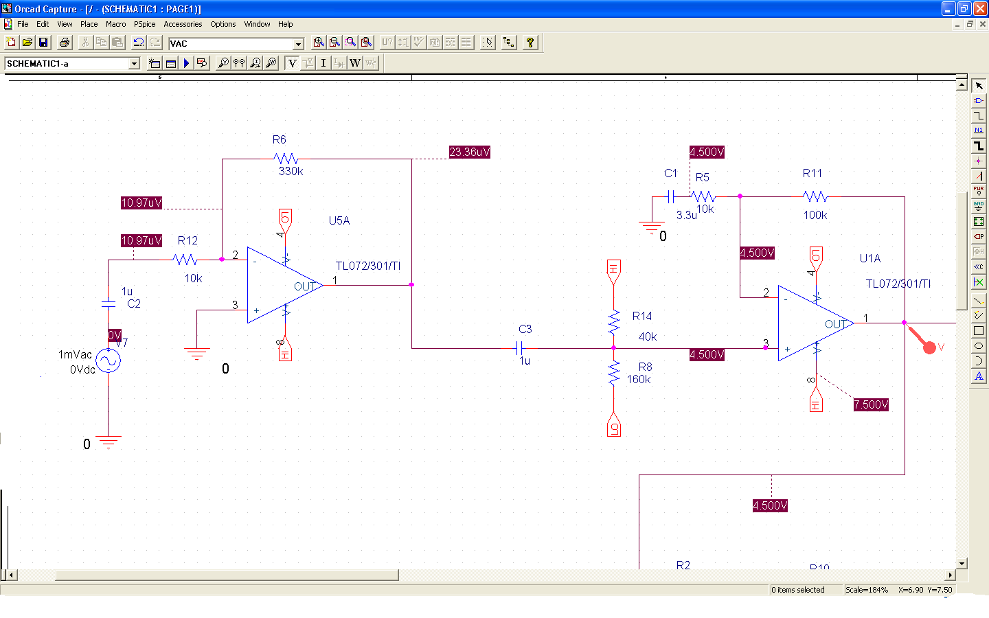

I selected 330k and 10k resistors for both op-amps so the gain is 1122. MAybe I reduce it yet by incraseing the 10k resistors. For now I hear some of his and maybe some of noise at the output. That said his is much reduced if I use an individual 47pF cap in parallel with those 330 feedback resistors on 2 cascaded op-amps.
I do'nt know why it reduces the his?? As far as I know this job will cause each op-amp to act as an integrator right? Which values are good to be used for those said caps?

If each has a -3dB rolloff frequency of 6.5Hz then the total of all 3 will have a -3dB cutoff at 19.5Hz.
I selected 330k and 10k resistors for both op-amps so the gain is 1122. MAybe I reduce it yet by incraseing the 10k resistors. For now I hear some hiss and maybe some of noise at the output. That said hiss is much reduced if I use an individual 47pF cap in parallel with those 330 feedback resistors on 2 cascaded op-amps.
An OPA2134 dual opamp has much less hiss than a TL072 but it costs more.
47pF in parallel with 330k is a simple lowpass filter (integrator) with a high frequency cutoff at 10.3kHz so most high audio frequencies are gone. 10.3kHz is at -6dB if both opamps have the filter.
By the way whats the max of freq which I should expect on this gain?
High fidelity is flat to 20kHz so 50kHz is at -3dB. I don't know why your gain is so extremely high.
Well here's the frequency response of the circuit with 3 high pass capacitors. The out put of the final op-amp will go to the LM3875 configured as the below pic. As you can see the LM3875 has a high pass filter too. the 3dB roll-off of the LM3875 due too Ri and Ci is 7Hz. so it adds a 3dB to the freq resonse graph too. I have to incrase the values of Capacitors so that I improve the freq response at low frequencies, but the main problem is the biggest ceramic cap which I have is 1uF (I dont like to paralell them so that incrase their capacitance). What to do so? I fear to incrase the resistors connected to the caps and hense the feedback resistors too (I fear I face the DC offset problem audioguru told about or something else). So What to do please?

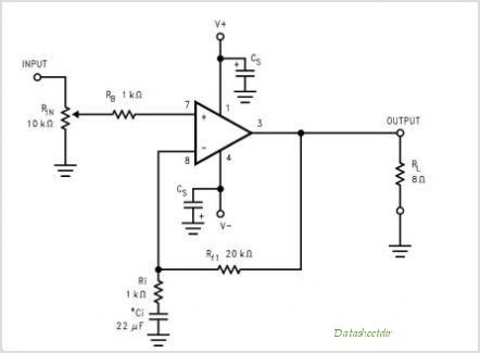

Ceramic capacitors are horrible for audio coupling. They are fine for power supply filtering to reduce high frequencies.
Ceramic capacitors change their value when the voltage changes which causes distortion at low frequencies and they are microphonic.
Metalized plastic film capacitors are excellent for audio coupling but a 1uF little pcb mount capacitor is about $1.00 each.
Increase the values of the resistors so that capacitors with lower values (and lower price) can be used.

The old LM301A opamp will not work in your circuit because it needs an external frequency compensation capacitor to avoid oscillations and the capacitor kills high frequency response.
I just use a TL074.

Instead of using an expensive 1uF film capacitor you can increase the value of the resistors 5 times then use a less expensive 220nF (0.22uf) film coupling capacitor. You could increase the resistors 5 times then use a 330nF (0.33uF) film capacitor for better bass response.
