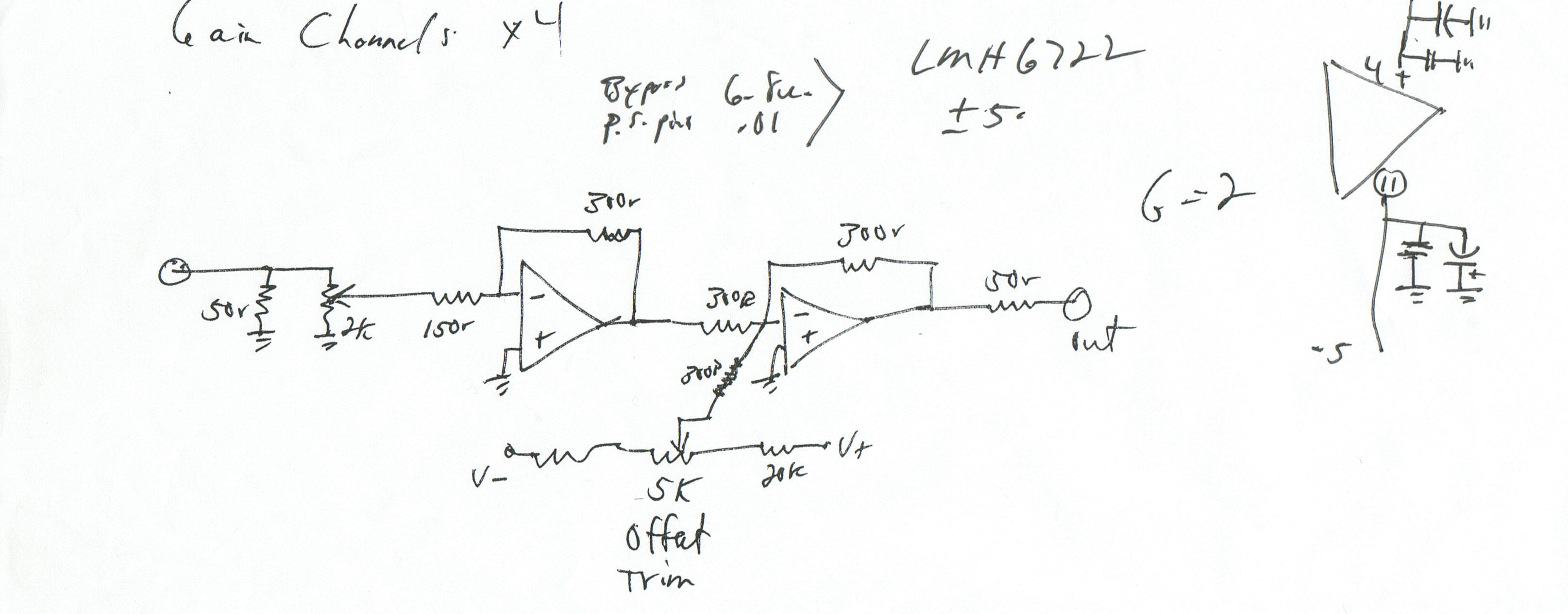

Hello All,
I have the attached design implemented on a PCB and it doesn't work. Could you guys let me know if I am doing it wrong?
Design is for a gain or 2.
thanks in advance.

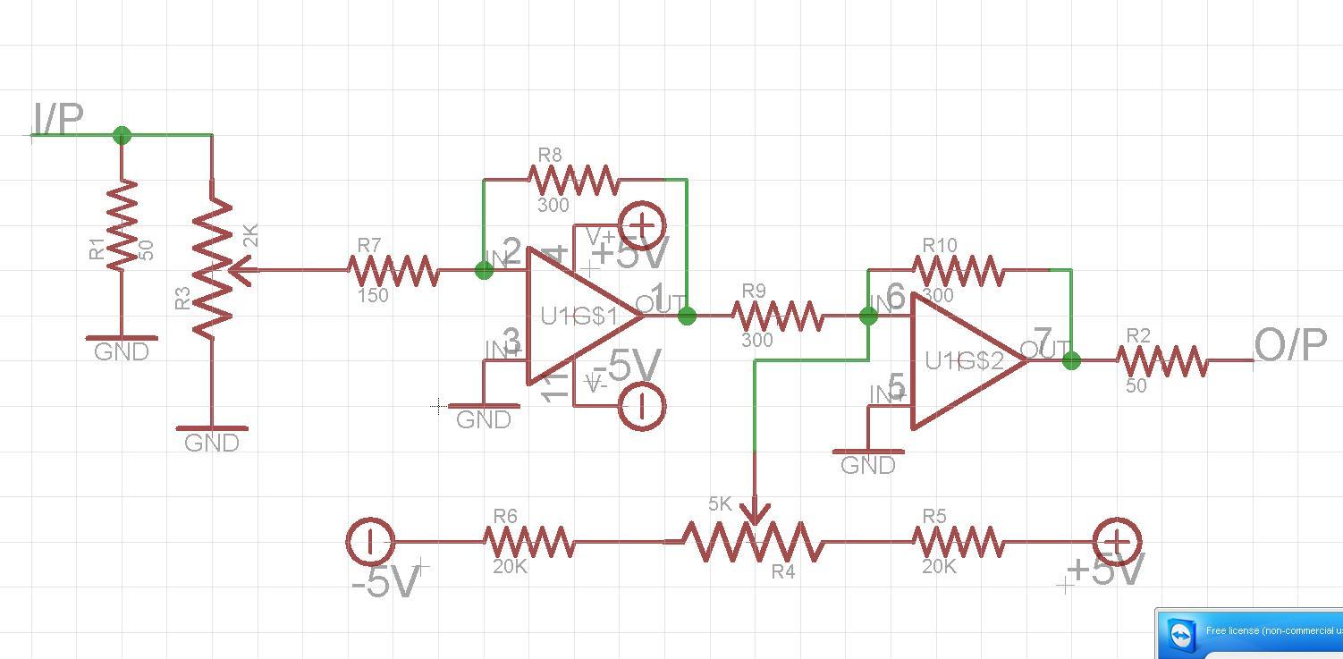

Sure, attached is a schematic in eagle using LMH6722
Any suggestions?
All I am trying to do is to implement a gain amplifier with Gain of 2 for an input signal of 0-1V at 50MHz with out any overshoot, undershoot and ringing noise at the edges. This will be duplicated for 4 channels.
thanks

what is the circuit doing? Output stuck high, low, oscillating...? Circuit looks OK to me, although noise generated from R4 might cause your output to swing wildly because you are injecting it directly into the inverting node of the amplifier
looks like a video amp to me... the gain of 2 is needed as the 50 ohm source into the 50 ohm load cuts the signal in half. Then you double it to get it back to the original level.
thanks
What is the purpose of the chain R4...R6 ?
Why two inverting opamps for a gain of 2 ? Why not using one single non-inverting circuit?
Challenging. Pcb layout will be critical.
The chain of R4 is used as an output signal offset adjustment. I made an exact layout on a breadboard to replicate the problem. Will post the result of it in a little while.
The offset trim doesn't have any effect on the output offset which is strange to me. Does anyone have a working schematic of a opamp with an adjustable gain of 2 along with adjustable offset. Basically something that replicates the circuit that I have, but tested and working?
thanks.
thanks.

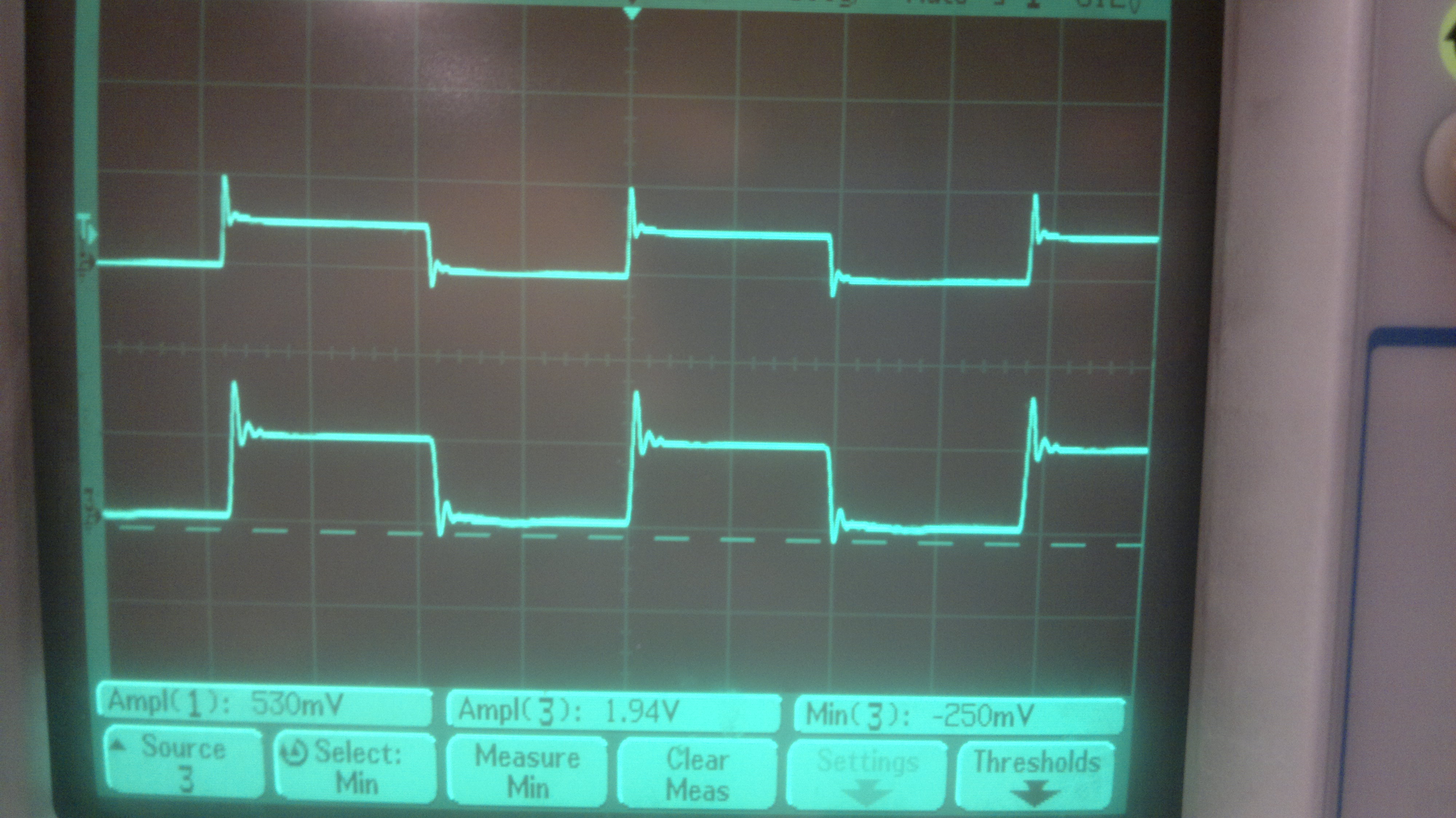

Thanks for that document. I followed it for non-inverting setup using an AD811 and now it works just fine except for rippling noise. The input has about 50ns and the output comes out to be 100ns settling time. Is there any way to reduce that too??
In the snapshot, CH1 is input (top) and CH3 is output (bottom)

The ringing on the edges at the input is replicated (and magnified) at the output, so you would have to reduce the bandwidth of the circuit, or get ride of the ringing on the input, to reduce the ringing at the output. But, reducing the bandwidth will also reduce the rise-time of the output pulse.

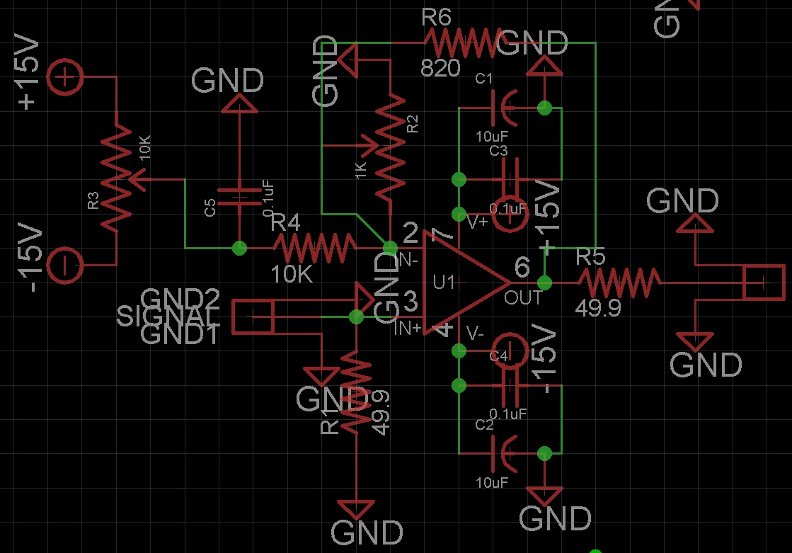

I redesigned the circuit using AD811 and also using the tip from the TI document for offset and it works fine except for that ringing which I guess will be ok for now.
One thing I would like some suggestion on is how can I use a single power supply for different sections of my design which otherwise uses 3 different power supplies to eliminate noises between the sections. I would like to use a single +/-15V supply for both analog and digital sections of my board efficiently without propagating noise between the sections.
thanks

It would be great if someone can check my schematic and board layout for any modifications for improved performance and low noise.
thanks
Unfortunately, I don't have the tool(s) necessary to view those files. Perhaps someone does. I want to mention, though, that the ringing in the scope image is not so much noise as it is either an impedance mismatch, or parasitic capacitances and inductances in the circuit (those that are not part of the design, but exist as by-products of lead length, PCB traces and materials, etc, used to construct the circuit) that resonate (ring) at their characteristic frequency. So, in addition to proper layout for noise, lead and trace lengths must be as short as possible, and not run too close together. Any cables into and out of the amplifier of any significant length must be constant impedance (coaxial, twin-lead, etc) cables and matched to the input/output impedance at each end.
