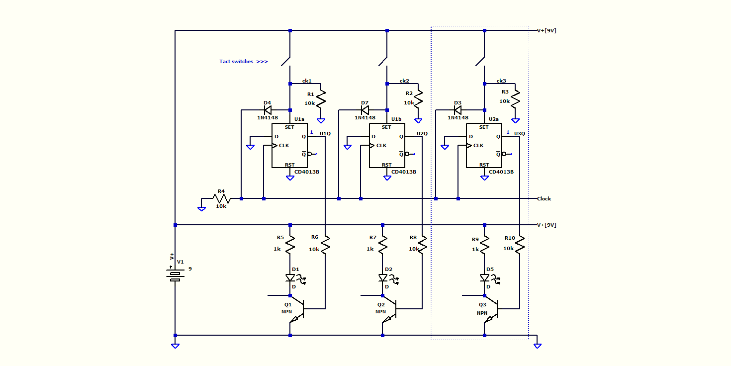

This can be done electronically in something called a radio button circuit
Something like this ....
This shows a 3-switch version, extendable to as many switches as required.

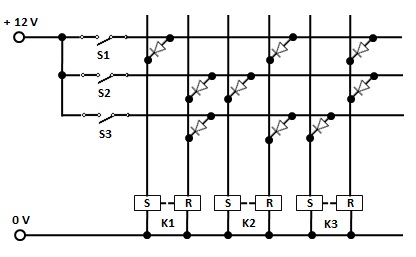

Hi Hymn1,
Here's one, using a diode matrix, push button switches and magnetic latch relays. The schematic shown is for 3 sources but it's extendable. Freewheeling diodes for the relay coils and LED indicators are not shown.
'NO' contacts of the relays K1, K2 & K3 are to be used to switch the sources.
Relays with gold plated contacts are a must considering the low level signals that are to be switched.
