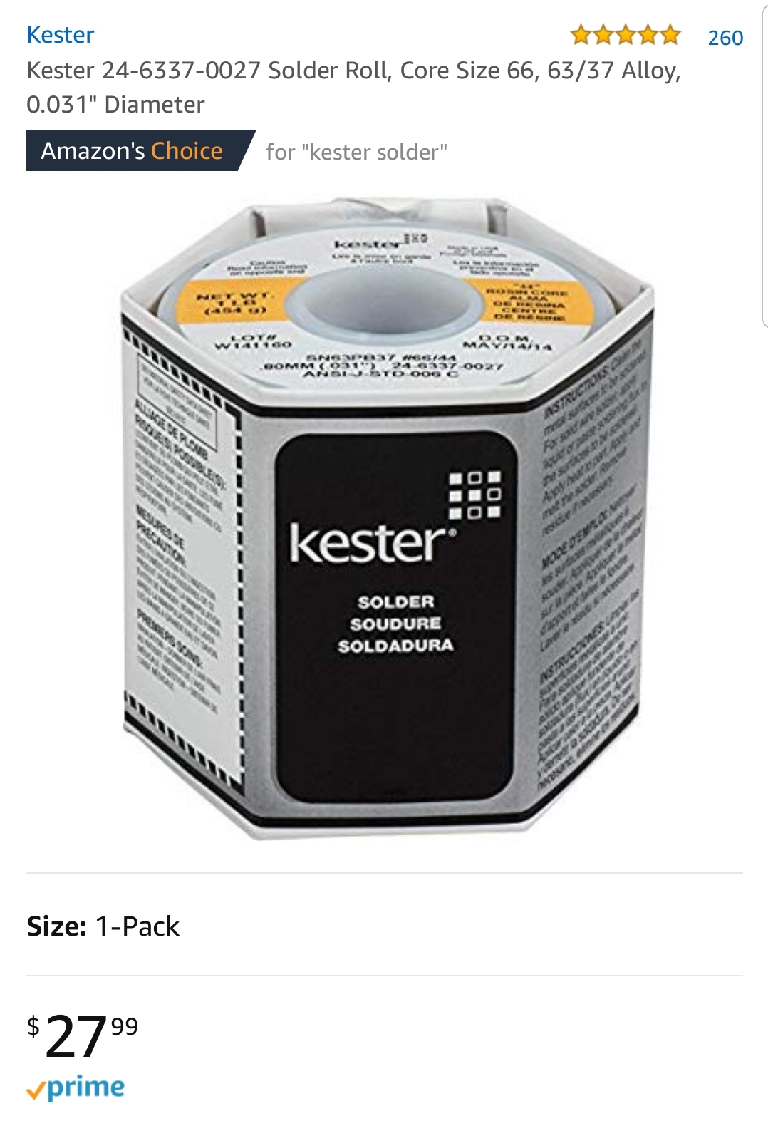

I bought about 30 or 40 rolls of solder about 1970. Prices are always going up I figured some day a roll of solder will be 10 times more expensive if I buy several it will save me money over the next 50 years. I don't remember what a roll of solder costs in 1970 but I do remember minimum wage was 90¢ & ok pay then was $3.50 per hour. I checked the price of solder last week only thing I can find is lead free plumbing solder 1 lb roll $10 per plus $1 sales tax. I still have 1 roll of antique solder left I might need to buy some one day. Is electronic solder lead free now? How much does it cost? Who sells it?
leaded solder is still sold everywhere...in electronics stores at least. $60-80CAD for a 1lbs spool
It seems your search skills are somewhat limited.

When buying solder, stick with a name brand (i.e., Kester). I have some solder I purchased from Banggood that is utter crap. A short section will work ok but the next inch won't even melt at normal soldering temperatures.
Personally, I like 63/37* with a rosin core. Other types of flux, like "water clean" are highly active and will attack the copper traces over time unless every bit is removed after soldering. I have found the smoke from non-rosin fluxes to be highly irritating to my eyes and throat.
* Percentage of tin and lead. 63/37 is the eutectic point of a tin/lead alloy. This means it transitions from liquid to solid instantly with no plastic phase, reducing the chance for cold solder joints.

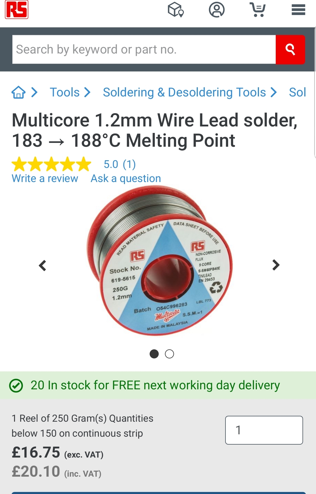

I have not tried lead free. but many suppliers here in UK ( for personal use ! ) this from ESR electronic components
